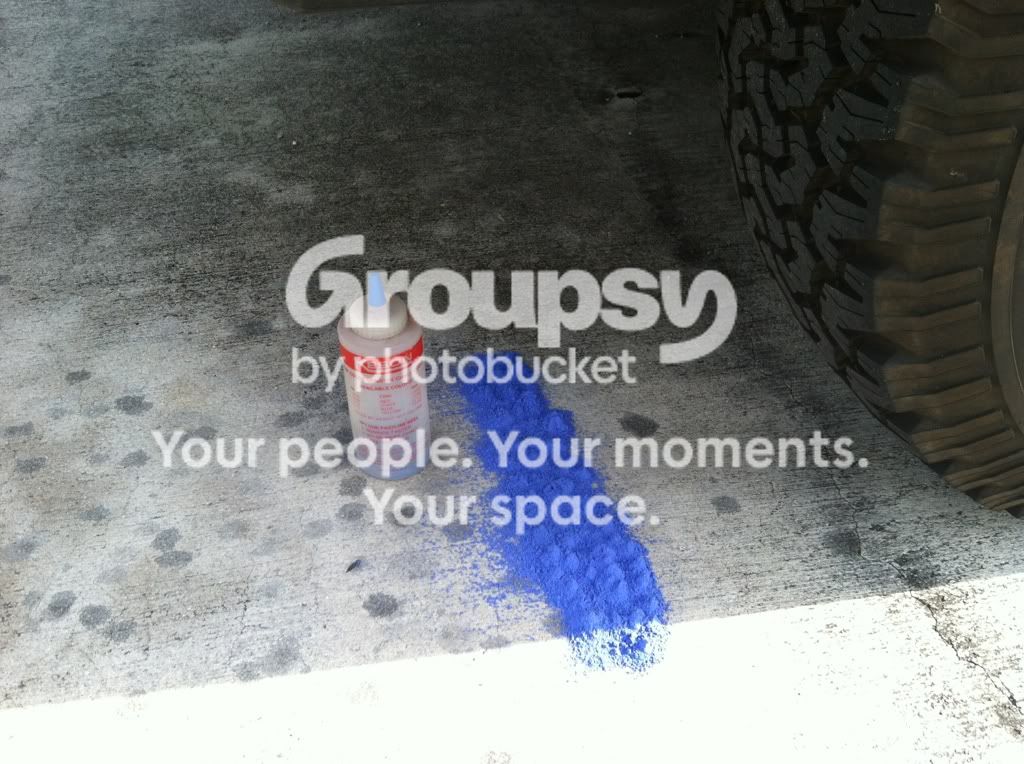

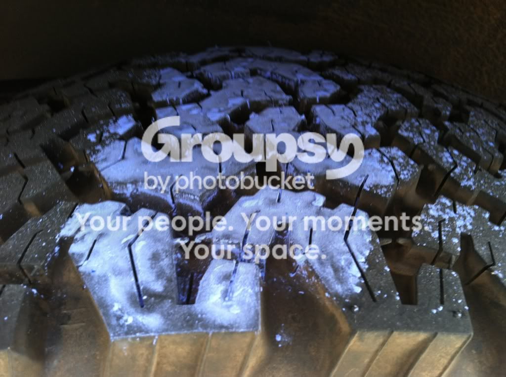

Alright I just had BFG T/A KO's put on and I'm going to figure out what air pressure to run them at. I will vlog the results for you guys. Expect videos later today, and if they do in fact require 45psi for a flat contact patch then I guess I owe you guys all an apology but I am gonna guess around 35-40

So embarrassing when I was loading my truck for my recent road trip I took out a trash bag that had odds and ends in it from my Audi. That had my tire pressure gauge in it. Anyways here are the results and I will get back with you on what pressure the tire place set my tires

This test came out perfect, good uniform contact patch all the way across the tire. If it is under inflated only the sides will have chalk on them, and if they're over inflated only the middle will have chalk on them. I will upload the video shortly
And that is for load capacity not traction or tire wear, you don't need 45-55 psi in your tires unless you are towing a trailer!
