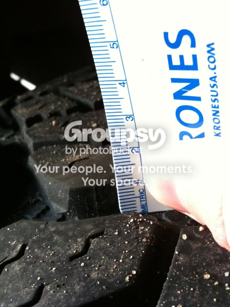

Just bought a new set for the trailer today and compared to the ones on the 4R with 25,000 miles on them.
Brand new: ~1.3cm of tread
ba1282d7.jpg~original
Used 25k miles: ~1.0cm of tread
9c5e3908.jpg~original
Are they both LT?
That's pretty good though. Not much wear.
Do you know what the recommended depth to quit using them is? I know most tires have a wear bar, but I haven't noticed one on my DuraTracs.
If you have an Americas Tire near you and want to buy local, they will price match. When I bought mine a year and a half ago I called all over and checked online. The best price was 4wheel parts. Took the quote to Americas Tire and they price matched with no issues. I paid $700 M&B for 265/75/16.
And yes, after 15k I am still happy with them.
Are they both LT?
They are both LT 265/70R17 E load range (112/109Q).
Couldn't find anything about when to replace, goodyear's site just says to do the penny trick. Also, I can't see the wear bars in any pictures I have. I'll take a look when I go out and see if I can find the wear bars.

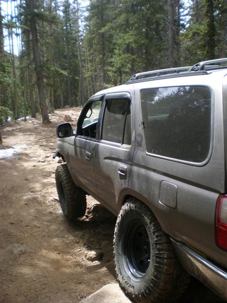

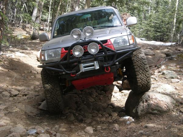

Nice, thanks. What makes the tires stick out a little like that?
edit: maybe it's an optical illusion?
I like the look of them sticking out just a bit, rather than totally inside the wheel well or whatever.
most of the guys on here use wheel spacers to space the wheels out a little more and keep the stock rims. i opted for some procomp rims to get the job done.

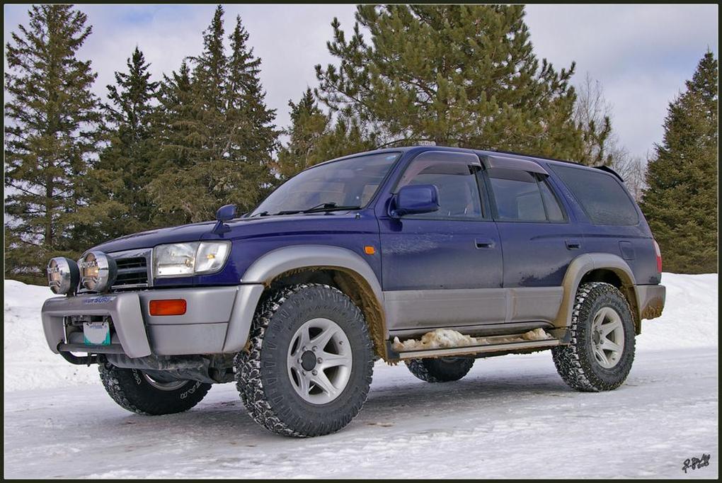

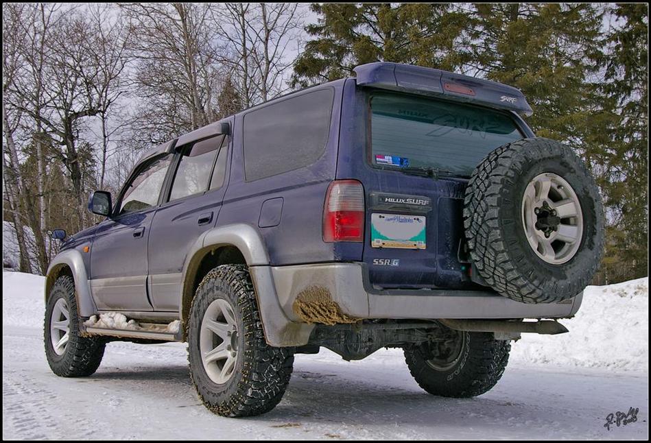

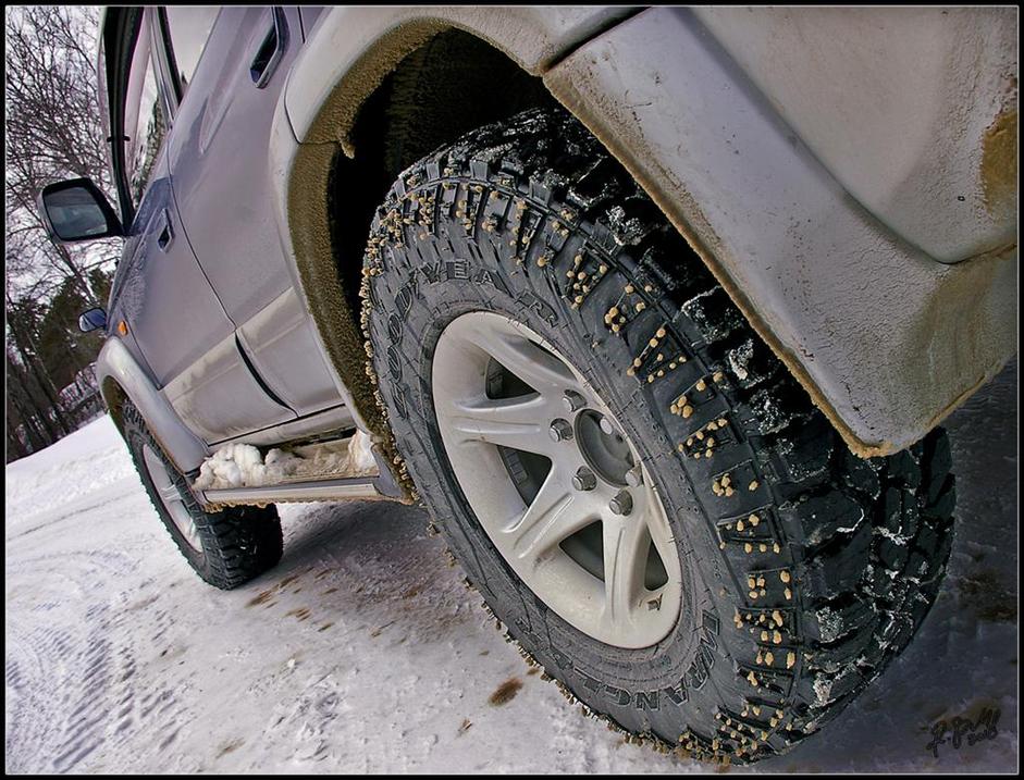

As requested, can't say enough good things about these tires!

The kind of flares and also the wheel you have make a difference in how wide the tire sticks out.
For example a 285 on a 4runner with no flares will stick out a lot more than the same tire on a 4runner with the Limited flares. Also some wheels will sit closer in so the tire will be more tucked in as well.
