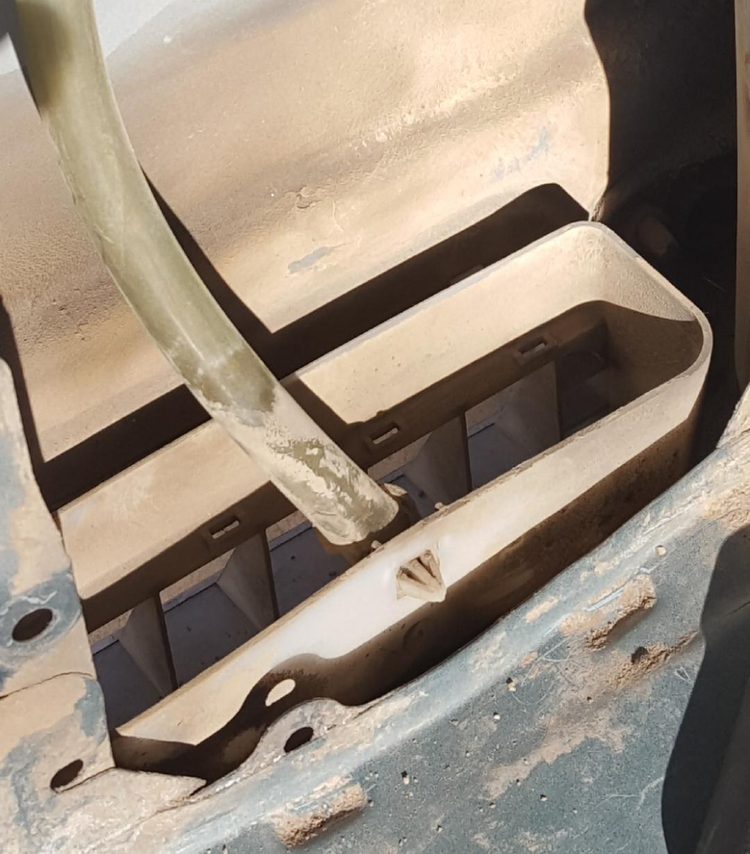

You have to take off the drive side section of the rear bumper, the plastic lip thing on top of the bumper to access one of the bolts. I also had to take off the interior trim to clean huge amounts of dust out behind there and to clip the sunroof drain hose back in to the new vent. That was what took the most time. You can probably skip the interior trim and reach through the vent to unclip/clip the drain hose.

I just got my 1998 from a tow yard lien sale for $1,500 and as I got deeper & deeper into it I found the source of the dirt ; the vent thing on the drivers side. The sunroof drain goes into it but it looks like it should have some foam or something to keep dirt out. The compartment had 4" of dirt in it, so much I just used my hand to scoop it out before I used the shop vac. The fine dust is deep inside every body panel, door pillar, and dust comes out of the headliner when you slam the door. I have totally gutted the interior at this point and hosed it out, am washing the carpets, headliner, etc. and sound/insulating everything before I put it back.
What is this filter looking thing for on the drivers rear panel ?

If the flap is in place, no dirt should ever come inside. Just replace it. No more dirt in the cabin unless it comes in from the base of the windshield.
The tube/cavity on the back of the plastic panel is for noise reduction in the cabin (driving down the road with the HVAC on external air, the vent will open and let air out and thus let sound from the rear tire back in, the padding in the tube absorbs the sound but lets air out from the cabin).

Just adding my 2 cents. It's Toyota Quarter Panel Vent part #6294035010 for pre-01'
The original rubber flap is what fails. I thought of buying a thicker piece of EPDM rubber sheet and creating my own, 'heavier duty' flap. But it was easier and more conclusive to seal it off forever.
