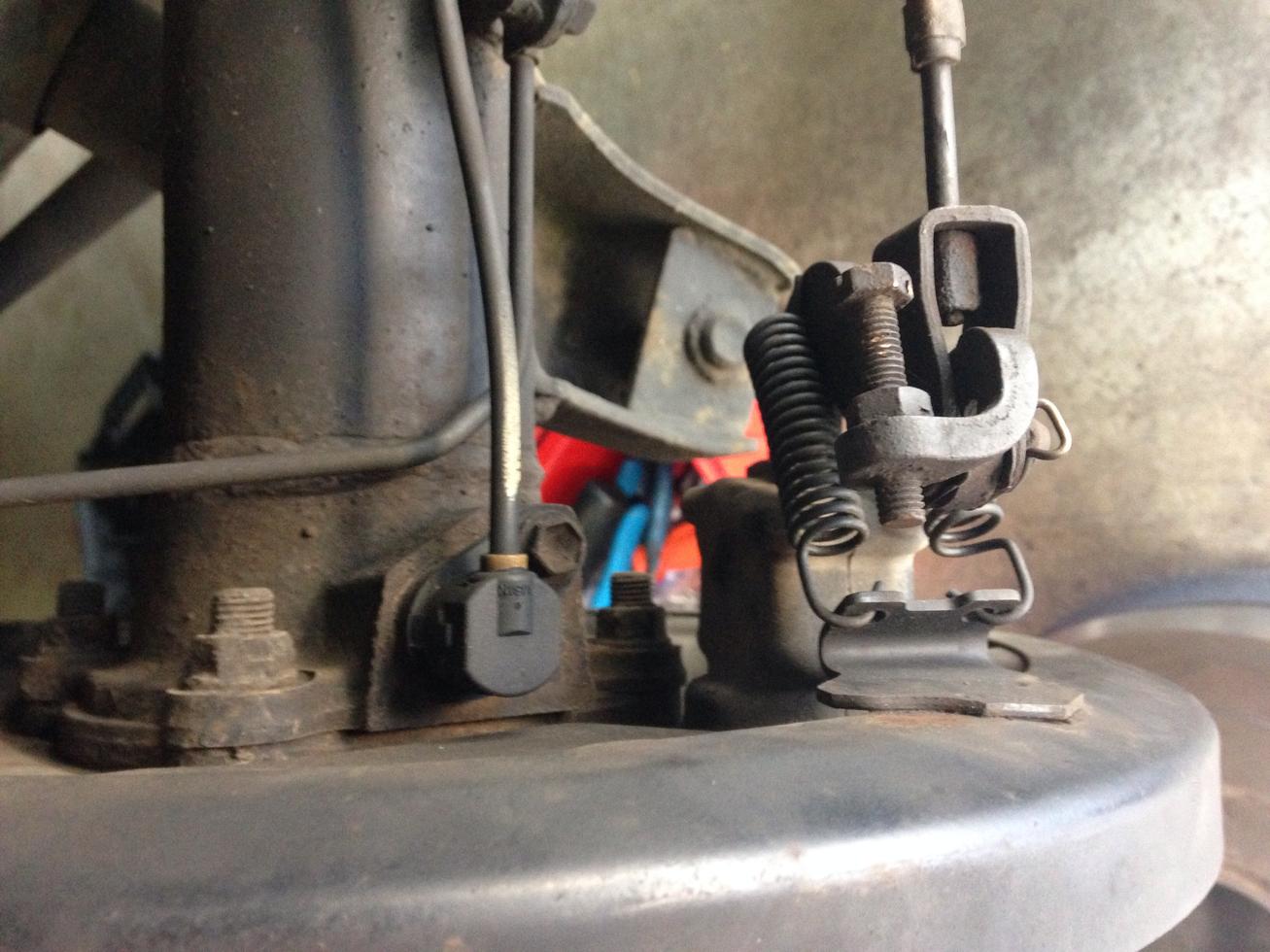

Okay guys, so yesterday as I'm at napa getting parts to do my rear brake job my E-Brake froze on me. I got in my truck and released my e-brake and it had no resistance on it. So I pulled up on it after releasing it and the e-brake pulled right to the top of its limits. I went ahead and did my brake job hoping it would fix the problem and no luck.
I attached a picture of the back side of the driver side brake. I can push it free and the e-brake will have resistance again.
Do you guys think maybe new springs will help pull it back, or all new brake cable?
Thank you for reading, any idea is appreciated!

you need to pull the bell crank off and lube it. very common issue.
since you're able to move it still, you should be able to get by with just cleaning and lubing it.
when they get really bad you have to just replace them.

yep. once you get it off, and get that boot off there, you'll see why its sticking.
after I get them cleaned and working smoothly, I pack some grease into that boot. its just not a very good design. if lubing it doesn't work out for you, you can just buy them. sometimes that's best...
