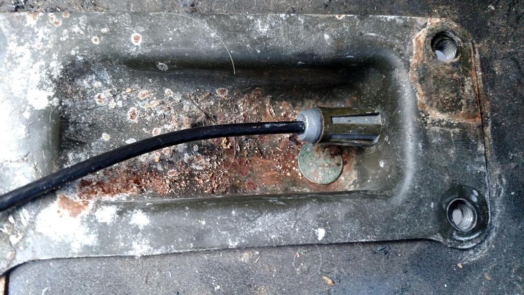

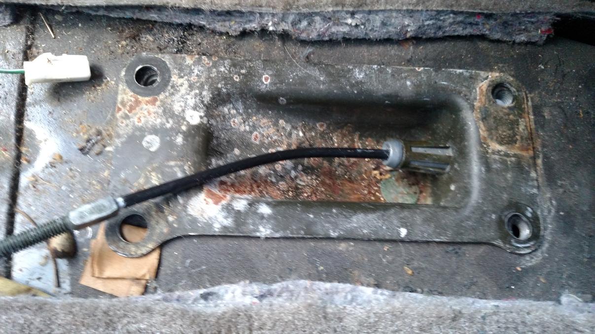

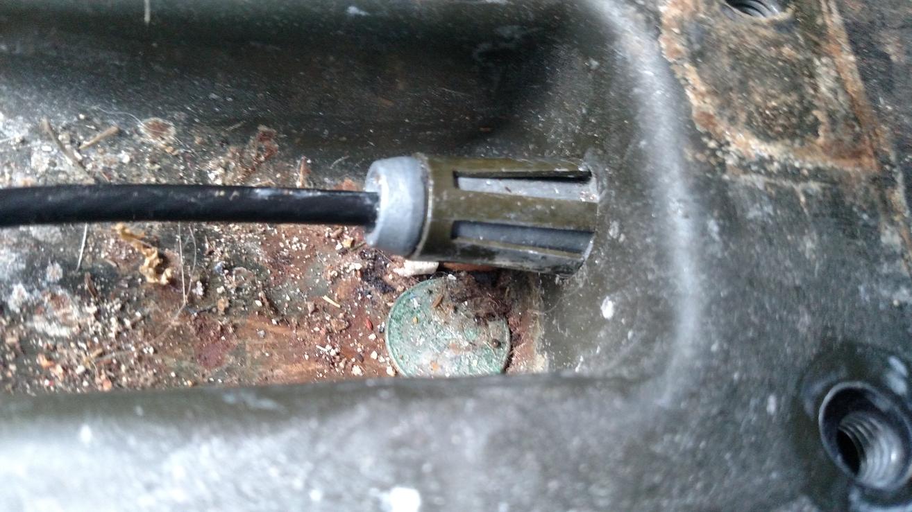

Hey guys,
Real quick, can anyone tell me how to remove the e-brake tub from the cable housing? I've removed the 4 12mm bolts, but the splines of the ebrake harness seem to be getting caught when i try and remove the tub.
Thanks in advance

Wrap a hose clamp around it, and tighten it up. Once it's free you can remove the hose clamp.

use a wrench. put the closed end over it and rotate the wrench as you pull the bracket back.
they are usually 13mm, but try whichever size until you get the correct fit.
