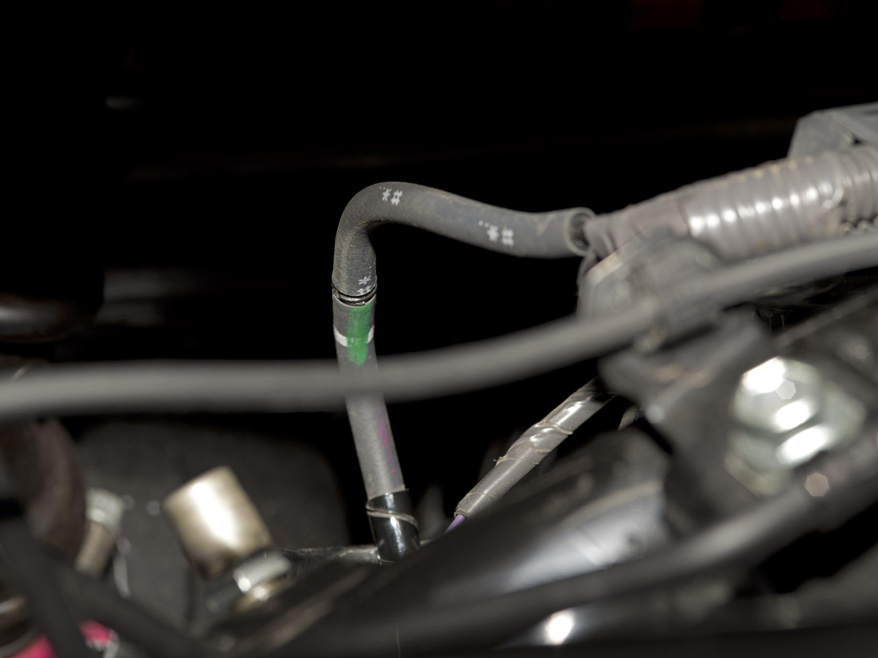

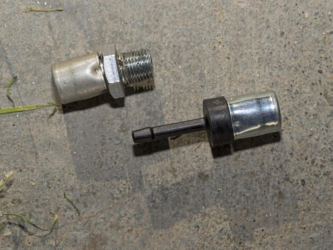

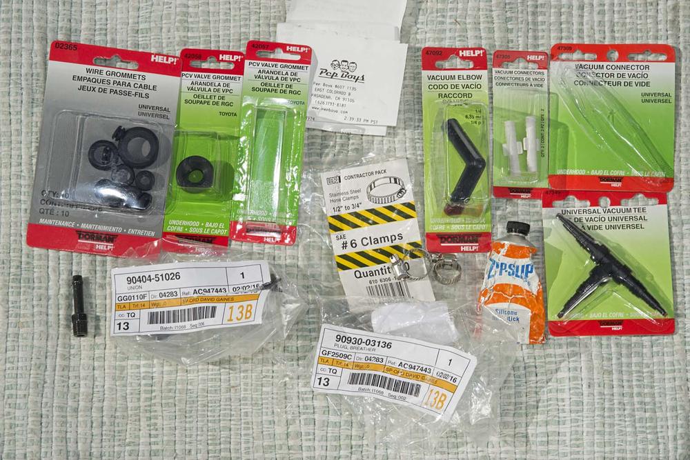

For the top end of the tube I used a Toyota part which looks like it might be a one way valve for one of the breather tubes on the front diff' or transmission, located at the front firewall. The Toyota part number is shown in the photos below. For the connection to the diff' I used the same part recommended in the links above and shown in the photos below. Both parts together cost about $16.

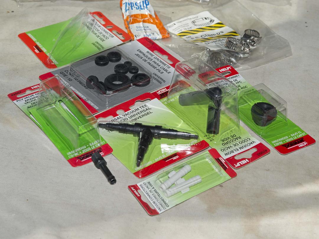

I also bought a set of couplers, a T-coupler, grommets, hose clamps and 1/4" and 5/16" fuel line hose from my local auto parts store, Pep Boys. The connector parts are shown below. I didn't use all of them but did use one of the PVC grommets, a T-coupler and a universal straight coupler. The tube on the breather part doesn't fit in the 1/4" tube so I used a 2nd piece of 5/16" hose.
Before you start, remove the spare tire and the left rear mud guard. Remove the inside edge of the plastic wheel well liner so it can be bent forward and outward. If anyone knows an easy way to pop those plastic body clips please speak up. It would have been easier if I had removed the whole wheel well liner.

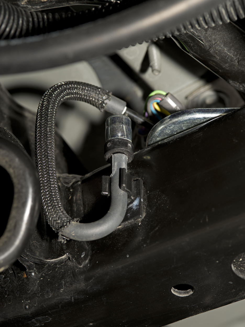

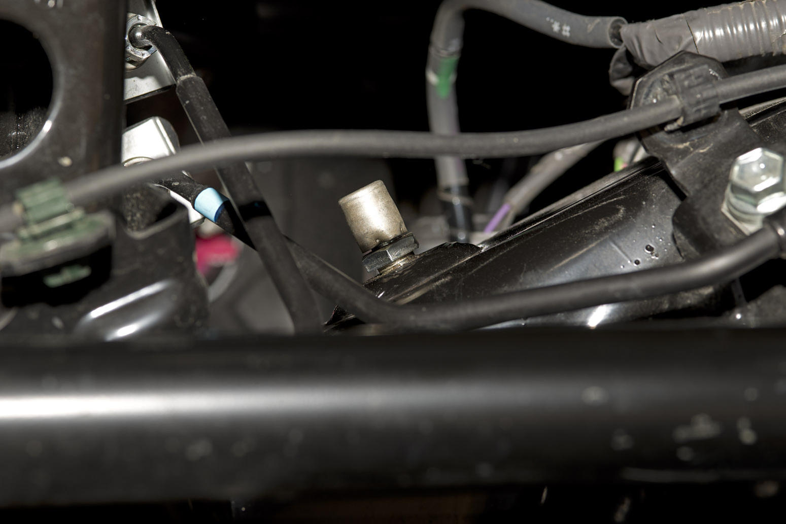

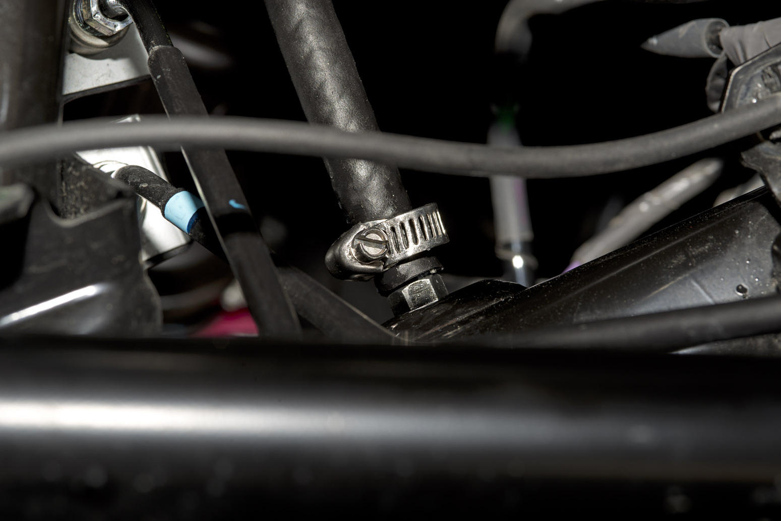

See the photos of the OEM one-way valves in place on the differential/axle and the E-Locker. In the photos notice the diff/axle valve, the tube leading from the E-Locker, the E-Locker valve extended to behind a frame cross bar, the parts from Pep Boys and the 2 original one-way valves after they were removed. The threaded valve is from the axle and the one with a small tube fitting is from the end of the small tube from the E-Locker.
Notice that the E-Locker tube runs through a grey plastic electrical bundle protector. The thin tube comes out of that bundle and loops down and then up to the valve behind the frame, which is next to that same bundled wire connector plug.

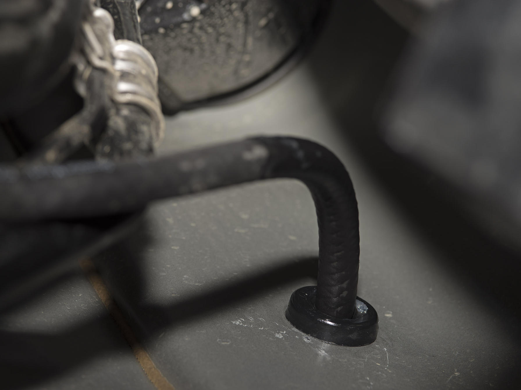

For the tube location I tried to find the large OEM grommet that everyone else shows. I couldn't see it from the top, inside the jack tool compartment. I think it's hidden below the tool brackets. A couple of people posted pic's of the OEM grommet with crude holes carved in the rubber. At least one person did a better job using a tube to punch the rubber. Given its low, exposed location and the thin, oversized grommet, this install is likely to leak in a deep stream crossing.
I decided to buy a new grommet to fit the hose and drill a new hole in the wheel well where it's higher and easier to access from inside. I found a PVC valve grommet that fit the hose. It is about 3/8" thick and has a wide surface area for resisting leakage. Using an angled drill motor I drilled a hole from inside the tool compartment where the jack is mounted. I drilled a small test hole to verify it was high up in the wheel well area. Then I drilled a 1/2" hole and ground it out farther, to about 5/8", with a drill-mounted, 5/8" tapered cylindrical grinding stone. The grommet fit perfectly and provides more surface area around the hose and against the metal wheel well.
Some of you may find a better place to install a new grommet than up on the wheel well but it's really hard to locate where you're looking from the underside and relate it to where that is inside the tool compartment. If you find a generic PVC grommet verify the diameter of hole you need.

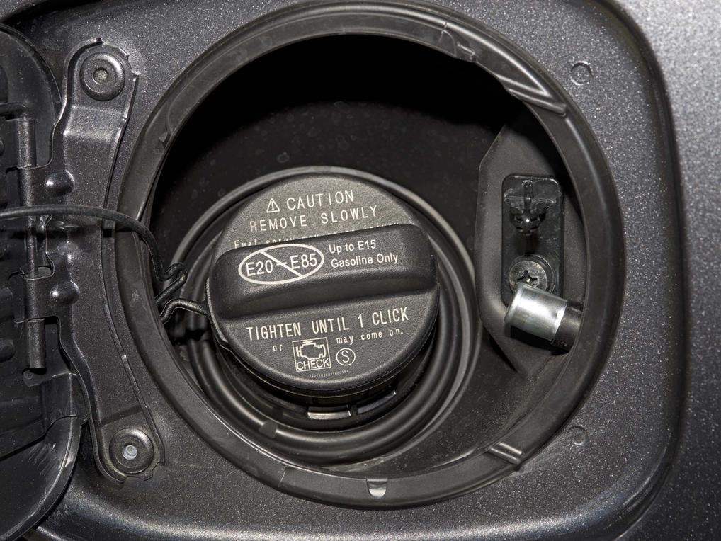

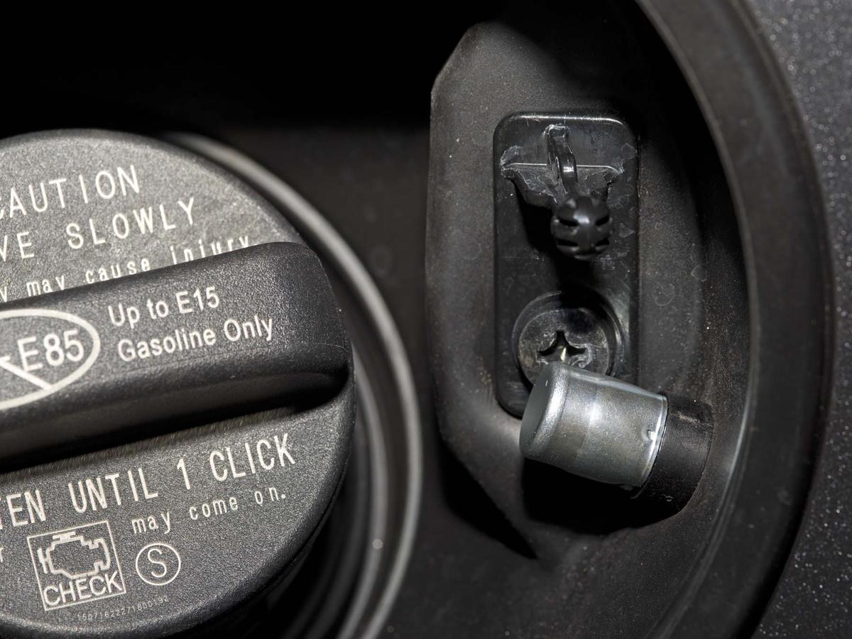

Next I drilled a small hole and located the breather part next to the gas cap, below the latch post. It's more upright here and these work simply by gravity, the weight of the metal cap on a tube end. The photo doesn't show the tube connector end but it fit's a 5//16" fuel line tube. The small connector goes through the body. The tube and clamp are located inside the jack tool compartment. A universal tube connector was placed inside the jack compartment to transition from 5/16" to 1/4" tube. The 1/4" tube goes through the PVC valve grommet. I left a coil of the tube in the tool compartment because, they sold me more than I needed, I have no other use for it and it makes it easier to access the tube later if the connector needs replacing.

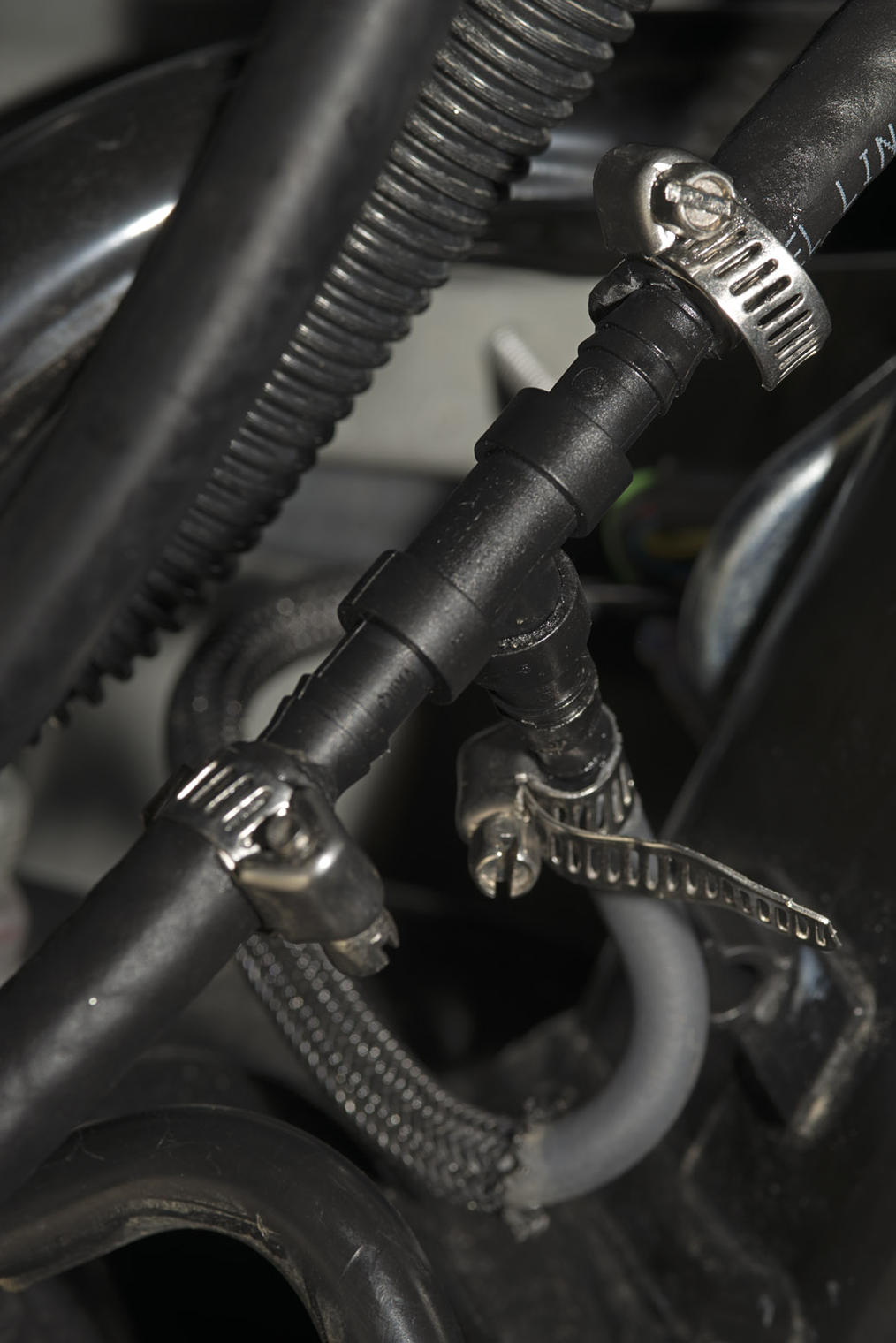

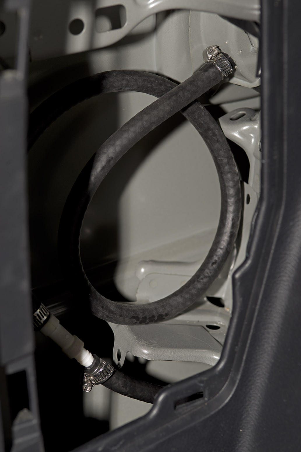

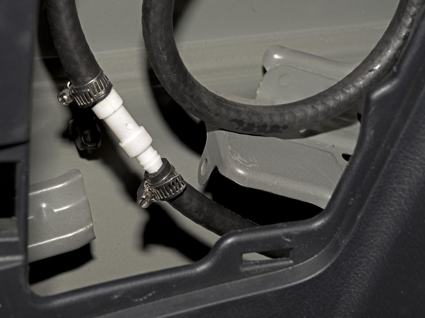

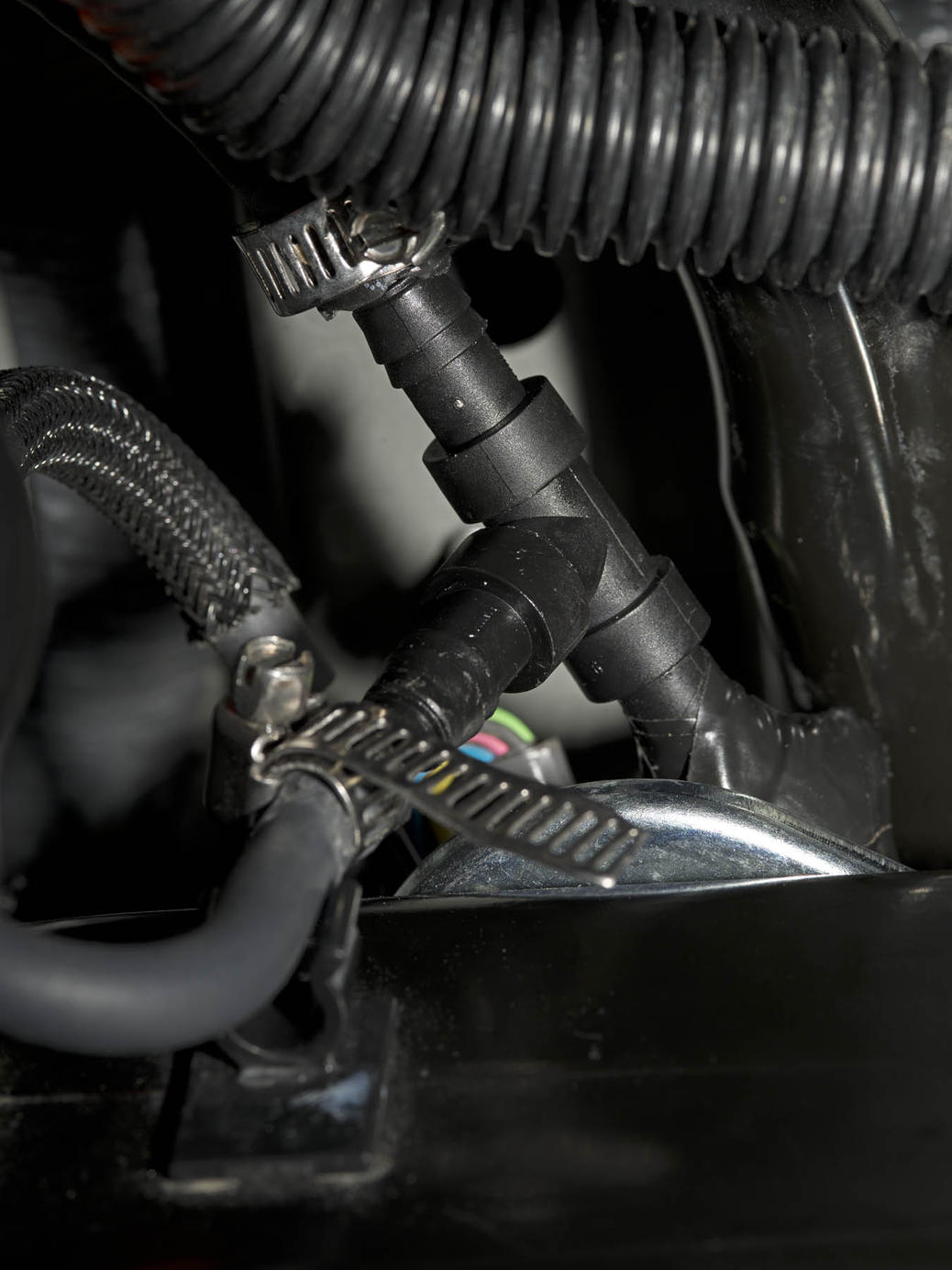

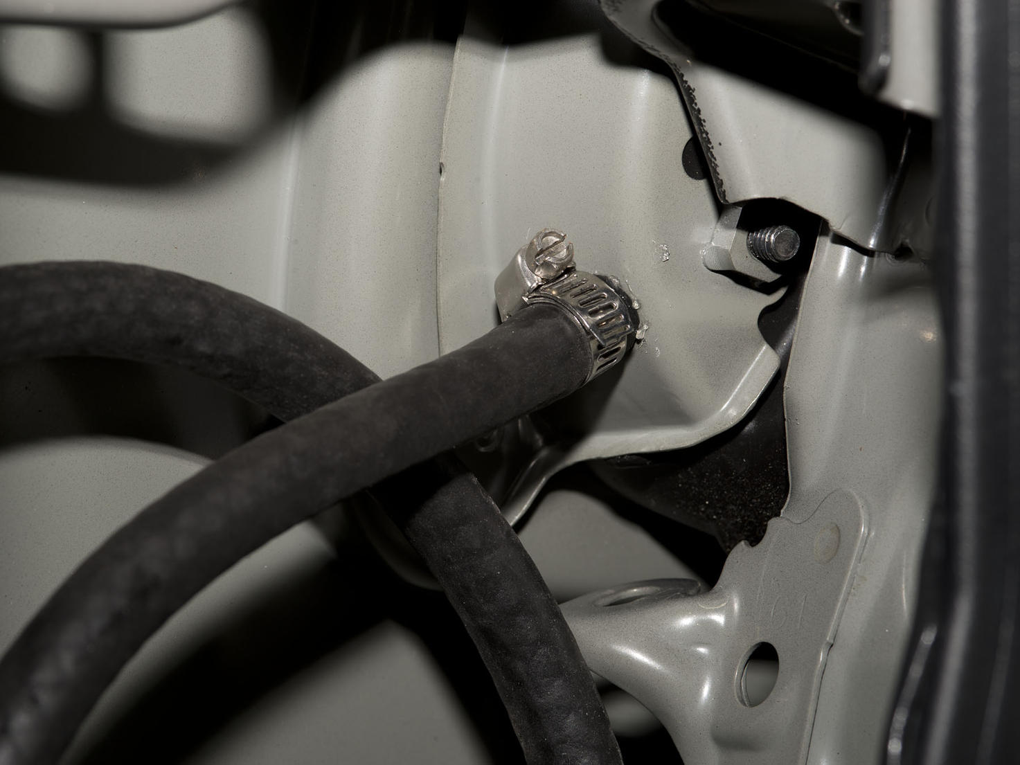

Moving away from the jack compartment through the wheel well and PVC valve grommet I routed the 1/4" fuel line tube next to the gas fill tube. I extended the tube to just over the OEM E-Locker valve location, where I installed a T-coupler. I installed the smaller OEM E-Locker tube end to the T and added another section of 1/4" tube extending towards the axle. I looped the tube loosely over the gas fill tube behind the gas tank in 3 big, 6" round loops and connected it to the Toyota union on the diff/'axle.

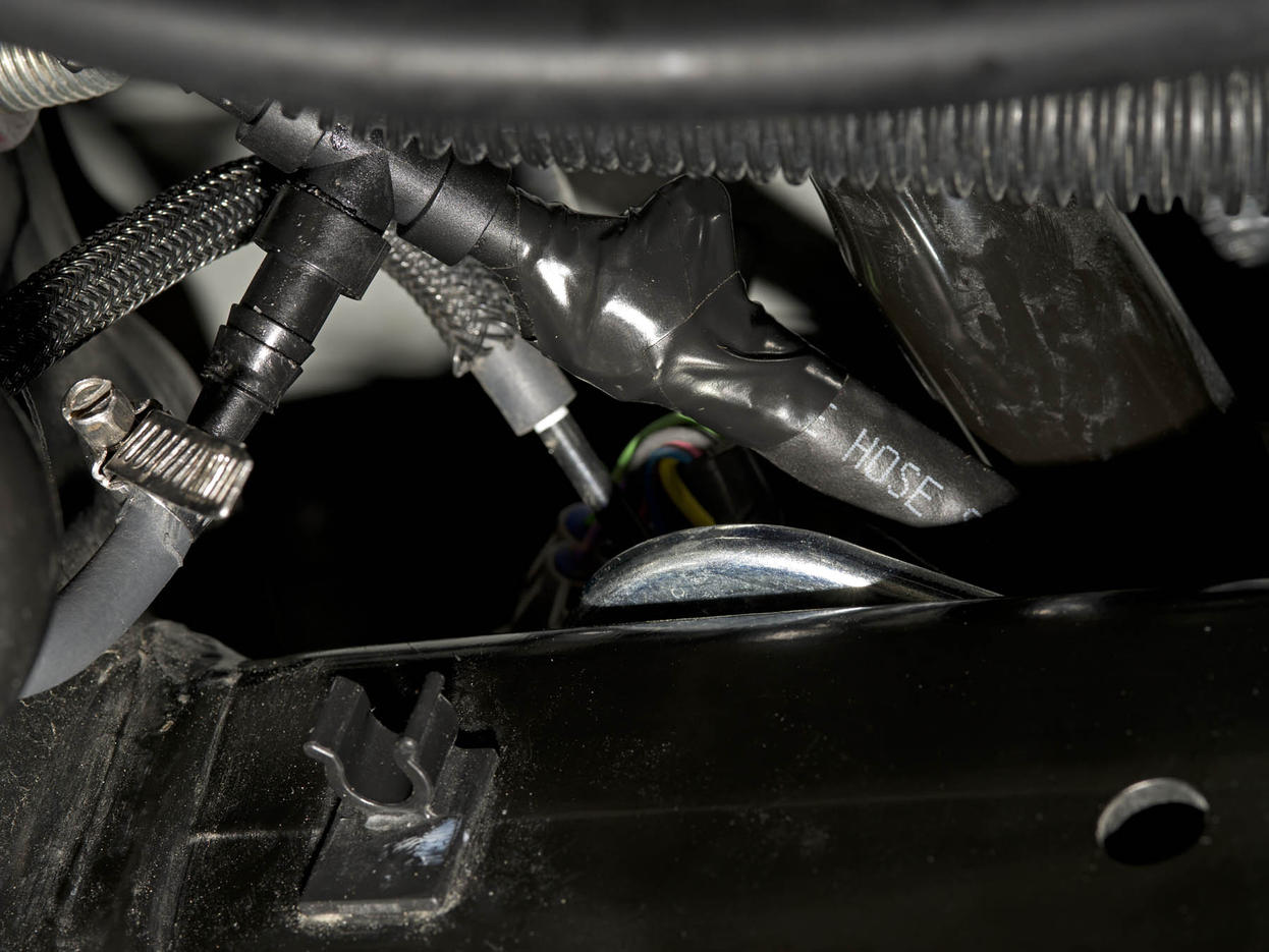

Where the T sits next to the E-Locker connection plug I wrapped the hose clamp with electrical tape so it won't wear on the wires or cause a short later, as the car moves.

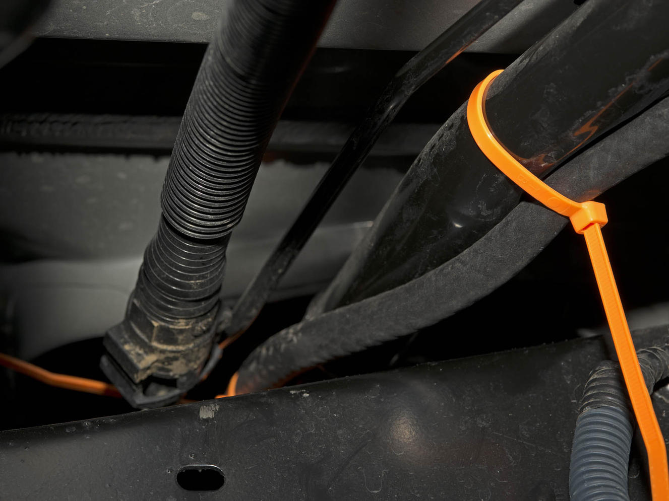

I used plastic wire ties (orange) to keep the 1/4" tube in place everywhere except over the axle, where it must move freely as the axle moves up and down. I have three loops of hose over the fuel pipe so it has plenty of slack to take up as the axle shifts. Using two ties I tied the T-coupler to the shiny metal plate on top of the frame, under the E-Locker bundled wire connection mount. These 2 anchor ties are not visible in the photos.
I believe this solution to the E-Locker and Differential/axle breather install is better and easier than the threads I've read, linked above. The holes in the metal body work were easy to access. The PVC valve grommet is a better seal than the OEM grommet which sits lower, behind the wheel well. If the OEM grommet leaks I don't think you can see that because it sits below the tool brackets. Routing the 1/4" tube was easy and direct, following the fuel filler tube. There's no pressure in the system since it's open all the time. The OEM E-Locker one-way valve was merely slipped inside the thin grey tube without a hose clamp. This solution works and after seeing what Toyota installed, it's much safer for protecting your expensive drive train from water intrusion.

Pretty sure he is using the breather part# 90930-03136
It is not one way.. It just has a dust cap... no filter element. Same ones are up front at the top of the drivers fender for the ADD and front diff.... I think.
OEM Toyota "plug, breather" part

The part numbers are shown in the photos. The last photo, in post#3, was taken by another forum member here. He used these last week to relocate the breather in his Lexus GX 470 and sent me that photo. He bought it at the Toyota dealer, which is what I did. Somehow we bought different "union" parts, as you can see for yourself, but they both work. :D
