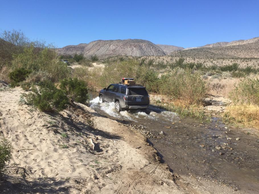

Deep Creek Crossing
This is what I needed my breather relocation for. I got it done just in time for this trip. There's another crossing just beyond this that is usually high enough to submerge your rear bumper and leave a water mark half way up your doors. Not this time though. The creek was dryer in places and the flow had changed this year. Still, I'm sure the axle got soaked in this crossing.
Anza Borrego Desert State Park, San Diego County, 25 miles from the Salton Sea in California ~20 miles from the Mexican border.
