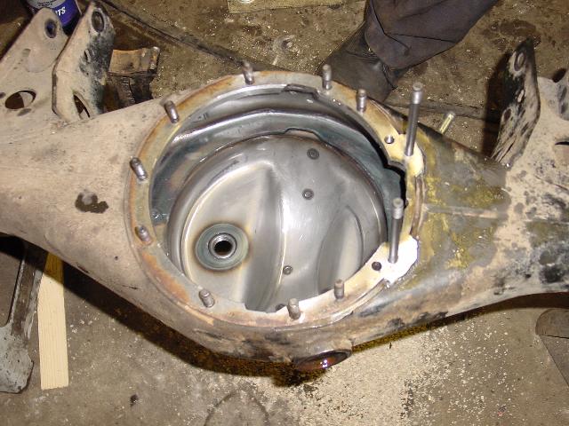

On my axle, the stud was the lower left(passenger) fastener. But, some things may have been modified since the previous owner installed an e-locker skid.
There should be 2 long studs, like in this picture of a retrofitted non-elocker housing. Maybe someone replaced a stud with a bolt or the stud unscrewed from the housing like a couple of my smaller studs did making them look like bolts.
