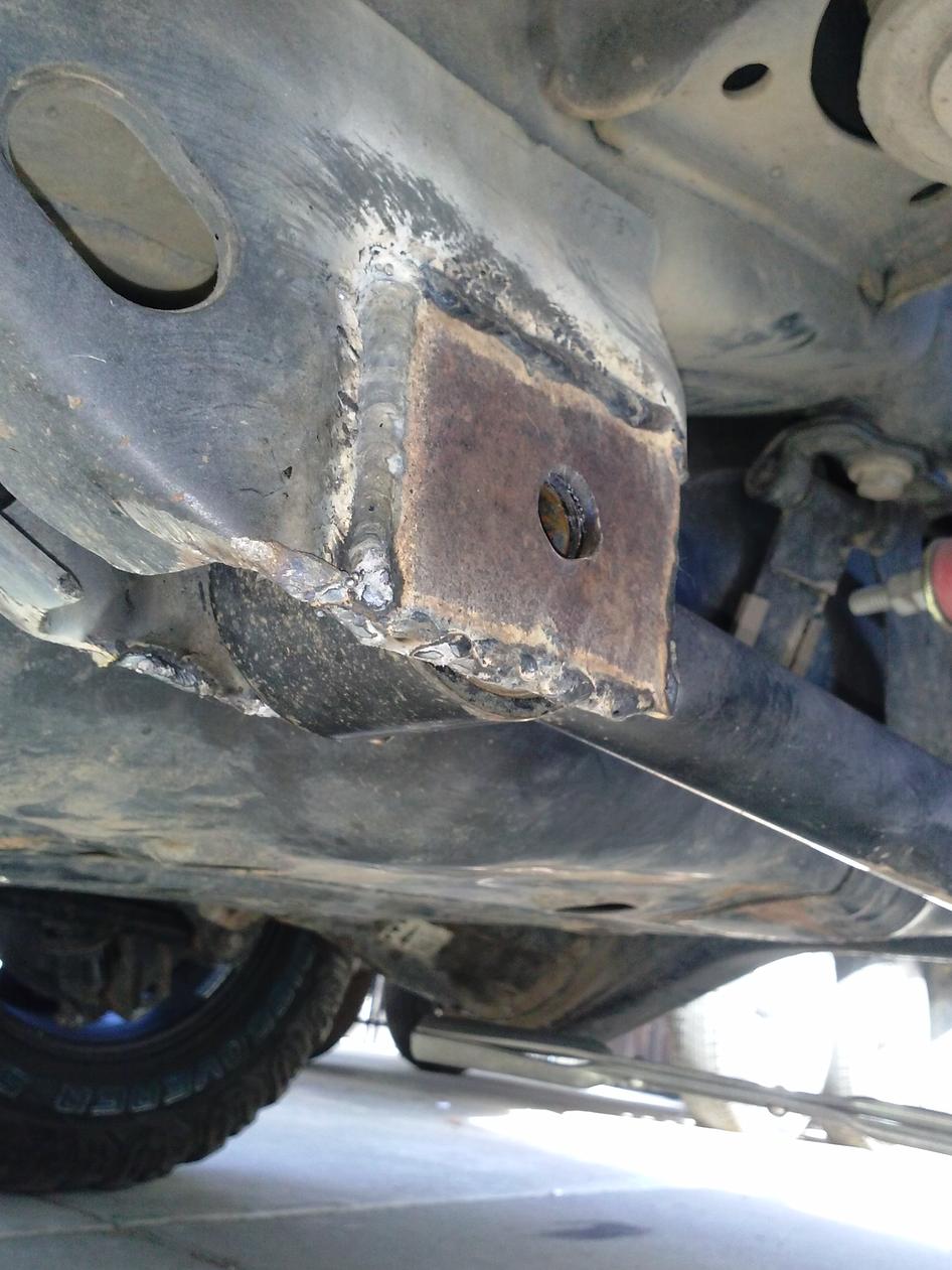

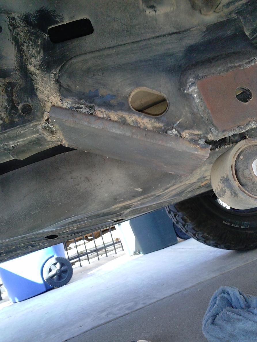

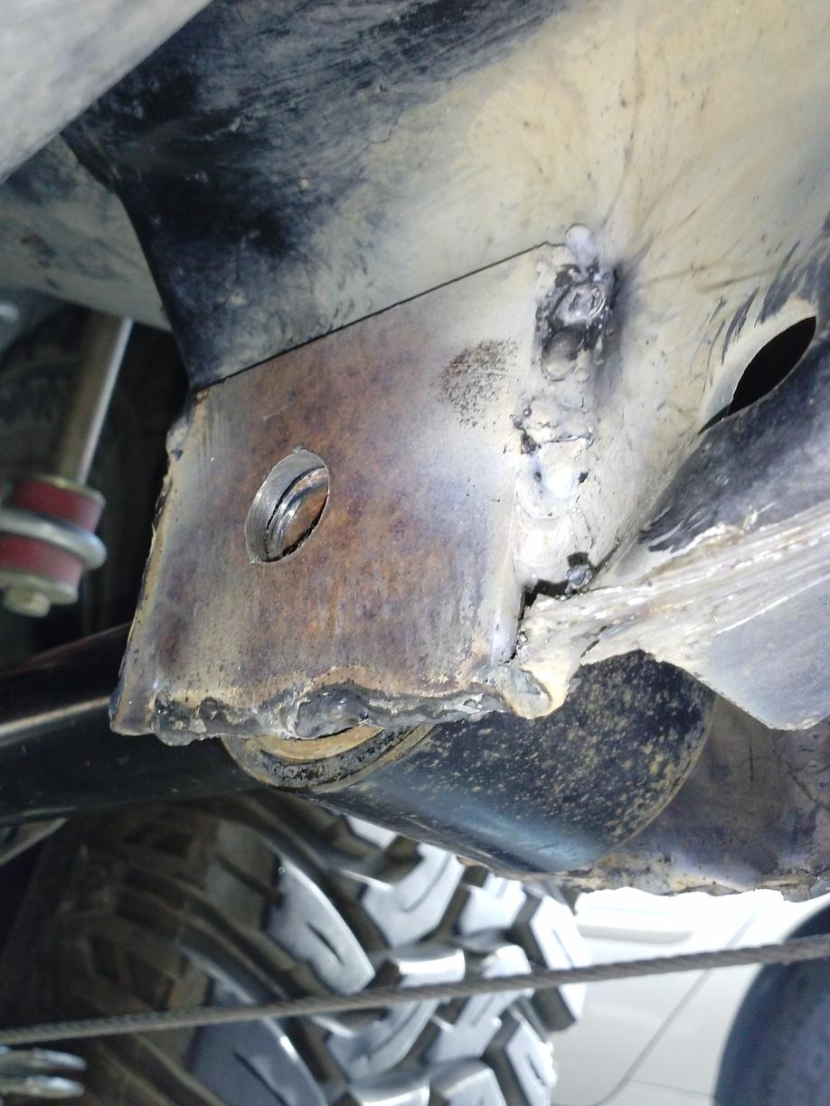

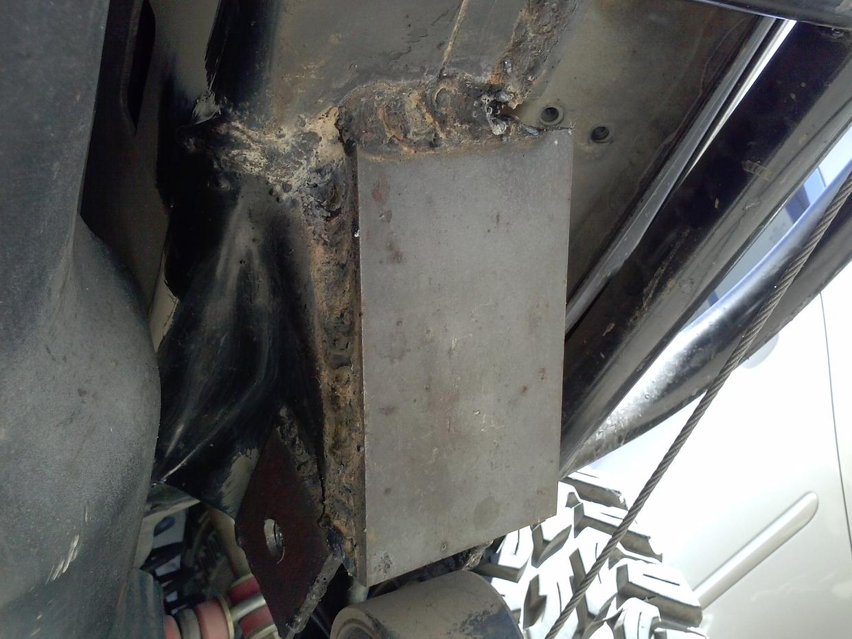

Well Kong, every time I go on these runs, I take on so much undercarriage carnage. First I noticed my right ball joint boot seeped out some grease. So, I disconnected what was need be and added some more.
I always hit my bracket on the rear lower control arm and bend it all up so I can't remove it. So, I had some scrap 1/8" and 3/8" plate steel. Reinforcement complete. Let's do another run and see if this worked.
I call these Lower control arm SKID PLATES.
