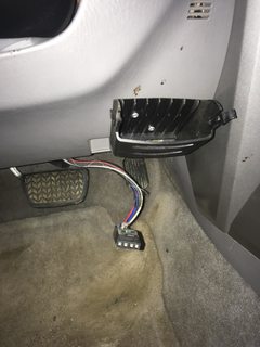

You will need the brake controller, and yes the connector/port is already there for it, just above and to the left of the brake pedal near the left kick panel. If the harness connector (to connect the brake controller to the port under the dash) that came with the truck isn't there, you can get a new one from the dealer or e-trailer...or some brake controllers will include one if you buy a 4Runner-specific model. The Prodigy brake controllers are a great option to consider. As long as your trailer brakes and the controller and working properly, you should be fine with the standard brakes...no need to upgrade in my opinion.

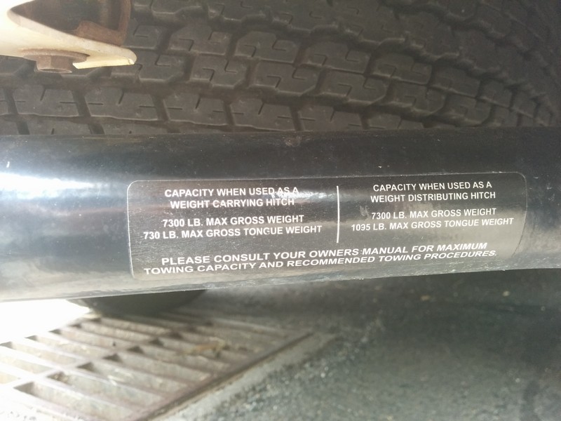

Not sure what a class 3 hitch looks like, but I took this pic of the sticker on my tow hitch. It says it is 7,300 lb GW. Not sure why the difference in tongue weight: "730 lb Tongue Weight Carrying" vs "1,095 lb Tongue Weight Distributing"
My 2007 V8 4WD is a SR5, not Sport. Maybe the previous owner bought the factory tow package upgrade.

Kind of hard to see but I think that's class 3. It should be attached to your frame.

That is the biggiest/beefiest hitch that comes on the 4runners so you're good to go (once you get the brake controller). All of the v8's after 2003 came with that one, and those ratings on that sticker are accurate.

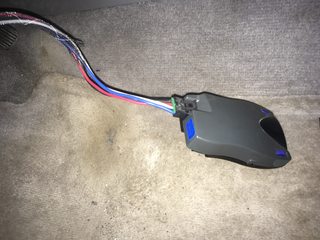

The plug for your brake controller is located in the wiring behind the dash panel where your steering goes through the dash. Some find it on the right side, and others find it on the left. It's just folded to either side. On the end of the wire is a plug in connector that will attach to your P3 (no additional harness required). If your T4R came with the tow package there will also be a 6/7 pin connector to connect your trailer by your hitch as well.
