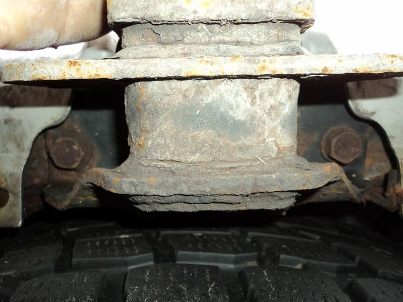

Heres my hitch, sounds like a class 3 unfortunately. I never really noticed the bolts so I thought is was so beefy because its looks like part of the rear crossmember

From the pic, it looks like you have the 5k receiver, which is not capable of handling a weight distribution hitch setup. It is the same oem receiver used on the V6 model. If you want to use a weight distribution hitch, you will need to replace that receiver with a frame mounted receiver. Check for other threads about this, or go to the E-trailer site for more info, and optional receivers available for your vehicle. If you are mechanically inclined, you should be able to install the new hitch yourself, or any competent shop can do it.

I'm strictly going off of stuff I was told on the hitch, and also going based on memory of a conversation that took place over a year ago, so the details may not be 100%. If I remember correctly, it all has to do with how/where the hitch is mounted, not the physical size. The mid-03+ are mounted differently thus allowing them to handle more weight.
The WD hitch on the V8 is bolted to the frame rails not the cross member like the one found on the V6 as detailed in my previous post.
Agreed, to a point. V8 4runner's up to mid-2003 have a different hitch than all other v8 4runners. This is the hitch in discussion. It's not the same hitch that comes with the v6 from what I can tell (haven't looked at a v6 that closely, I know they don't have the issue with the ball mount fitting which we have).
I did not know that. Excuse my confusion.
No problem. My guess is the early v8 hitch is similar to the v6 and just bolts to the cross member. I need to look at mine to see for sure. I know mine visibly looks different by the way it sits in the bumper compared to others I've seen (weight distributing hitch I'm pretty sure).

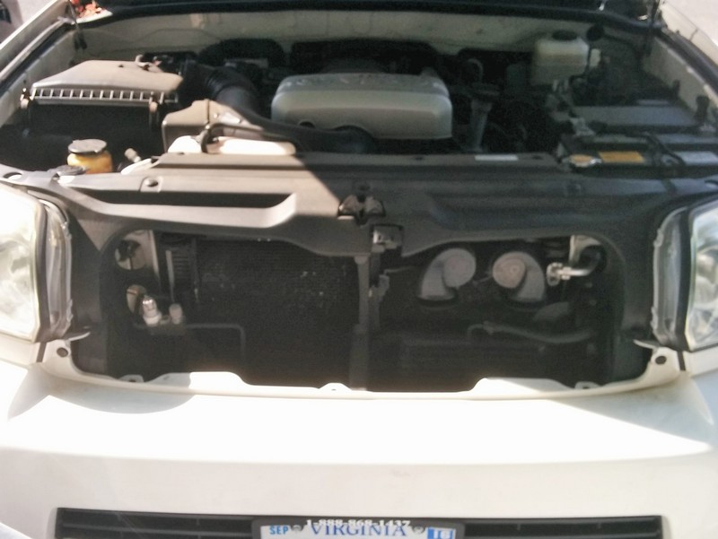

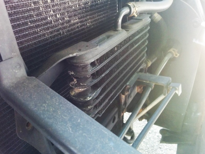

Is this the factory transmission cooler (looks like a mini radiator in front of the large main engine radiator)?
