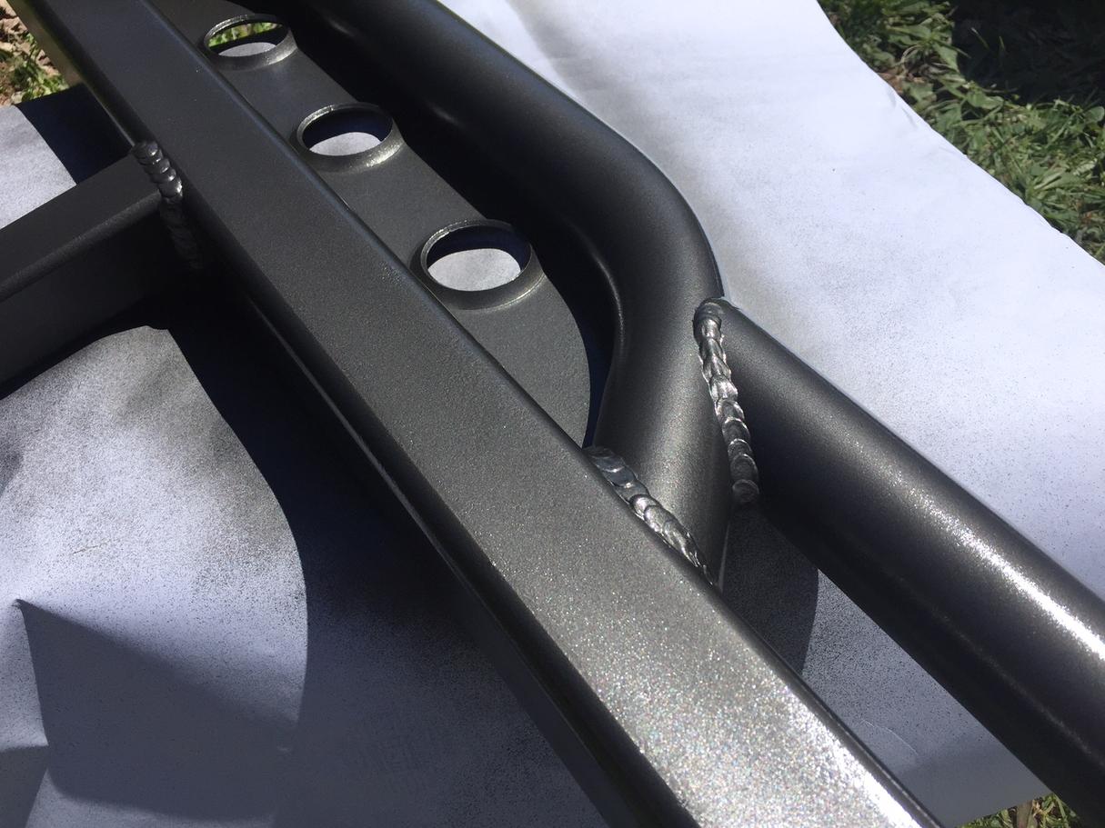

Just my $.02 on PC'ing sliders:
They're sliders, they're going to get scratched.
I spent $20 on rattle can and clear:
Now you just saved yourself another $80...
This guy knows what up:
Here in the land of too much road salt I just started painting mine so that when they get beat up or the surface rust starts I can easily repaint them.
So by painting myself and saving $100 with the April discount my new flat RSG sliders with top plate are on the way.:clap2:

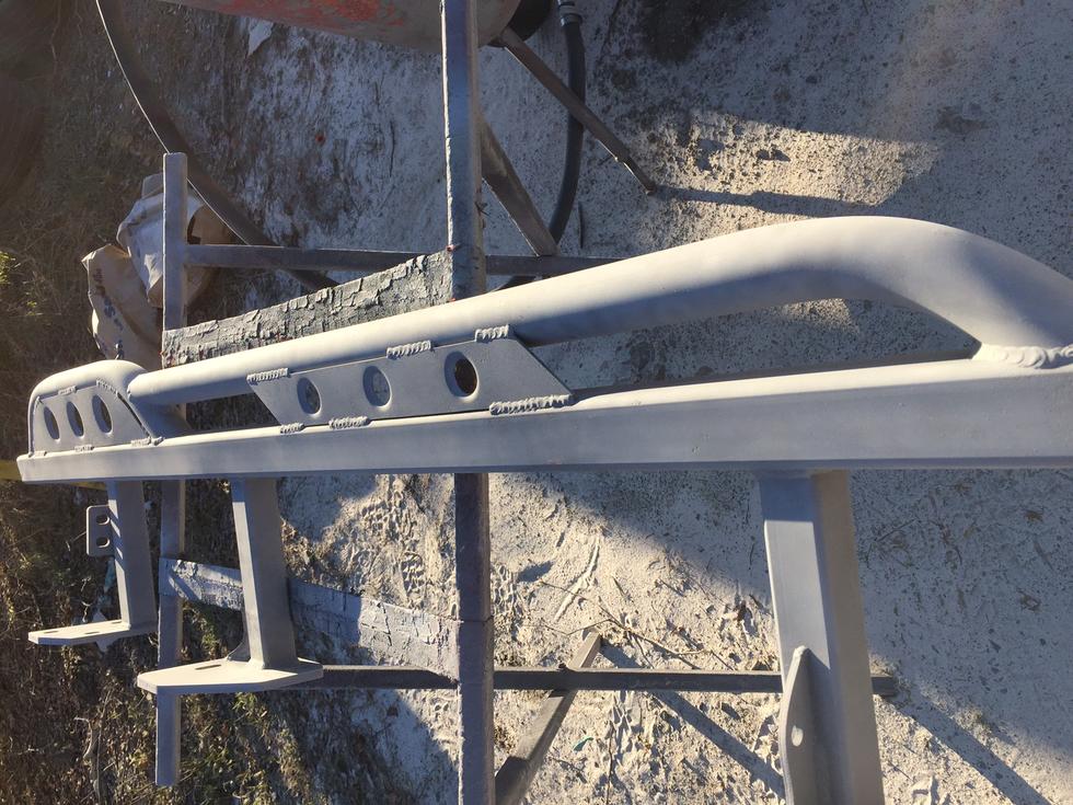

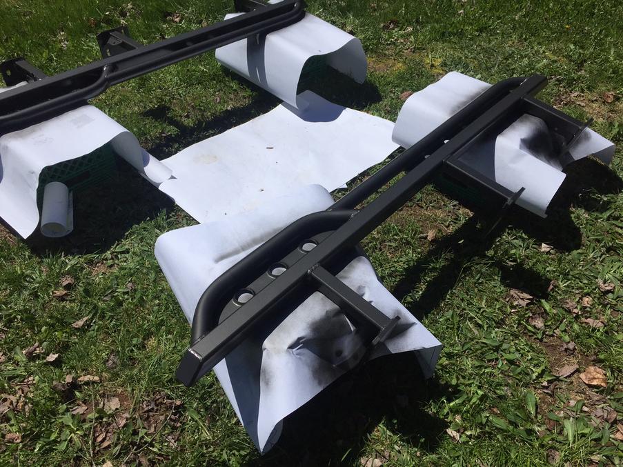

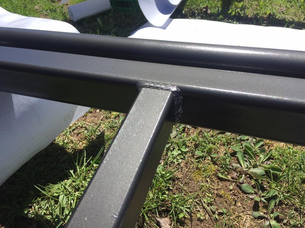

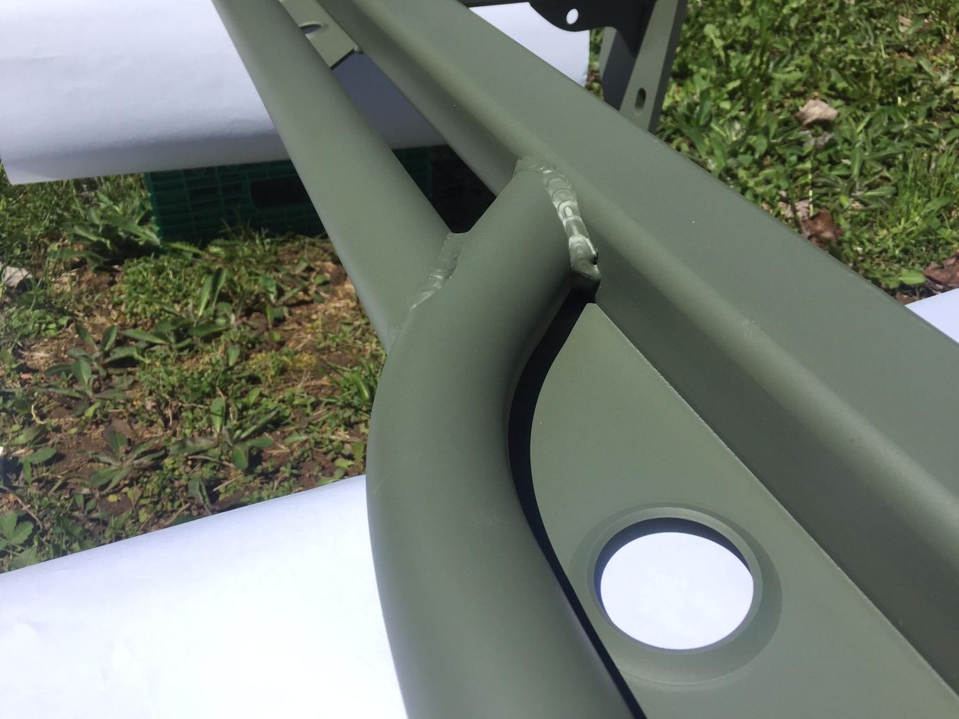

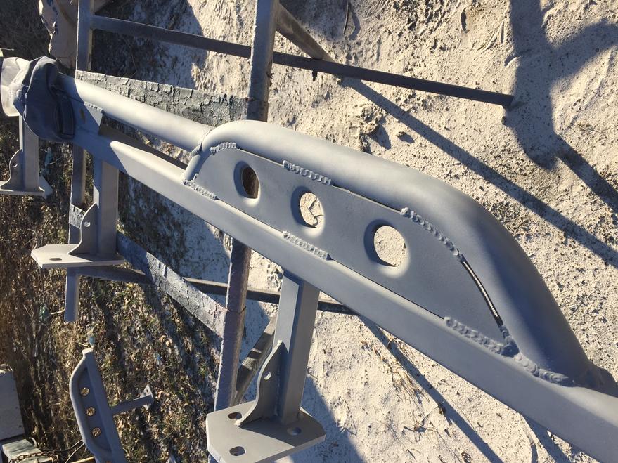

after 2 winters, I took mine off, sandblasted, etch primed, and painted with rustoleum hammertone.
The hammertone stood up to this latest winter like a champion! And it touched up very well during wheeling season

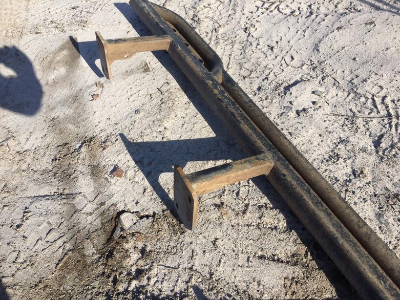

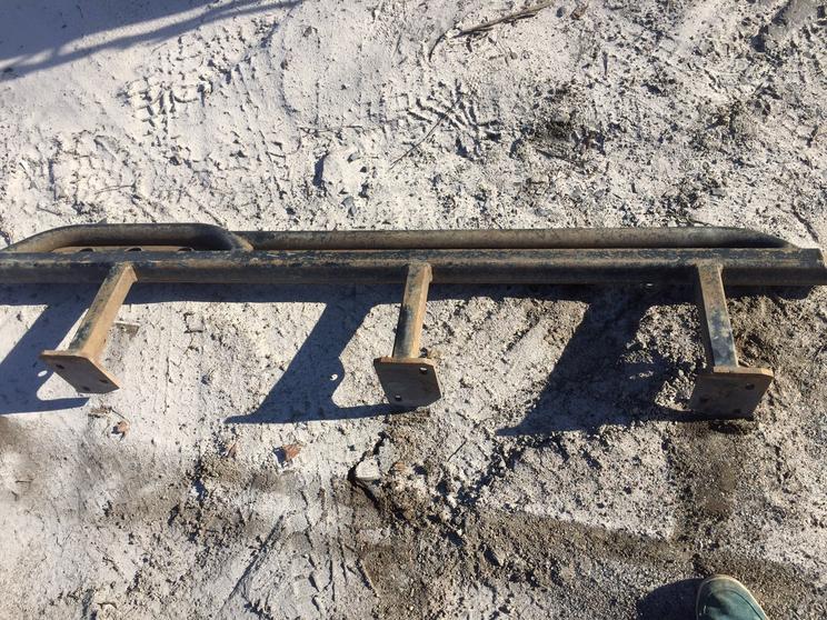

here's what the undersides looked like after 2 winters. Nothing the sandblaster couldn't handle.
edit - I posted this because a vermont winter is awfully close to a new brunswick winter.
POR 15 would be a superior finish. If rust did bleed through, it could probably be touched up to good effect.
However it would take a lot more effort to sandblast and start fresh though. Good luck!
