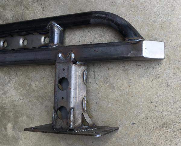

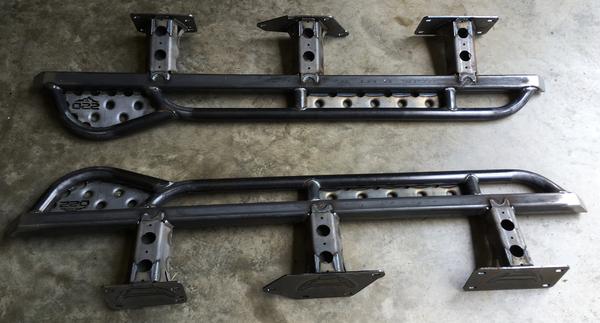

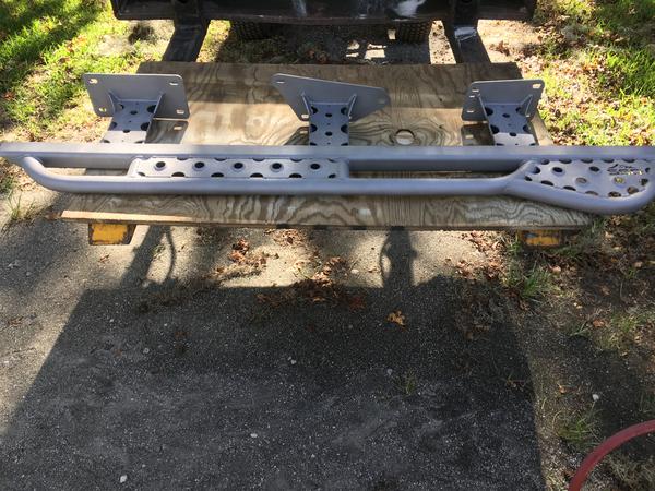

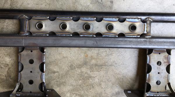

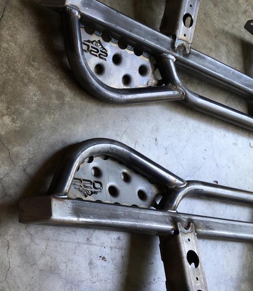

They are mill finish, there are no other options for coating. They are beautifully welded and all parts are precision cut, I presume with laser as is SOP these days. Here are a few close up pics of various portions with them in the raw.

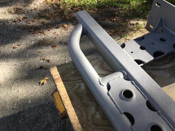

I didn’t have time to deal with them so they sat in the shop until I could block out a weekend. I called a local powder coater for a quote and they wanted $200 plus tax to PC them. It was too close to half the cost so it I decided not to go that route. Research kept coming up with the Rustoleum Bed Liner spray being a popular option so I decided to go with that. The local Lowes stocked it, and the ease of future repair appealed to me. Next was deciding how to prep them. Since I had access to a pressure-pot sandblaster I decided to go that route. I tried some run of the mill sand then tried Black Diamond which is coal slag. Tractor supply stocks it and it was relatively cheap. I bought the Red Bag Fine grit. $8 for a 50# bag, it took 5 bags with some left over. I used 50-PSI of air pressure and it took me a couple hours total including the leg work, interruptions etc. The finish was just what I wanted just coarse enough to give the paint plenty of bite.
cs223-albums-sso-picture48437-fine-grit-use-1-8-nozzle-used-50-psi-air-pressure-pot-not-siphon-style-sand-blaster.jpg

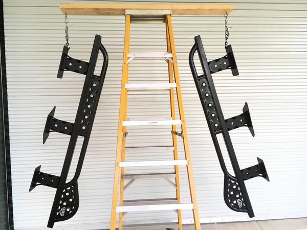

The next hurdle was how to hold them so that I could spray them all at once & not have to handle them risking messing up the finish. I ended up attaching a 2x6 to the top of my ladder, I added eyebolts that were double nutted above a flat washer. This gave me a swivel so I could rotate them toward the light. I added a short length of chain & a hook This allowed me the room to get at each end; high enough to get underneath and a step up the ladder to get the top. Had to get someone to stand on the ladder until both were hung. I also put a furniture dolly under one side of the ladder so that I could pick up the other side and roll it out of the way while they dried.

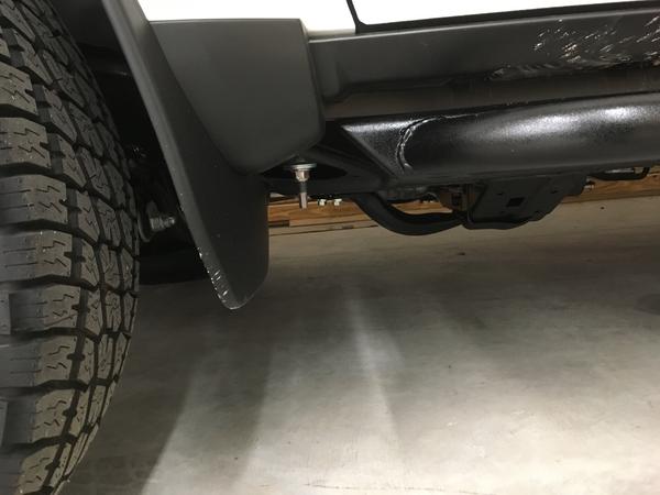

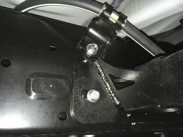

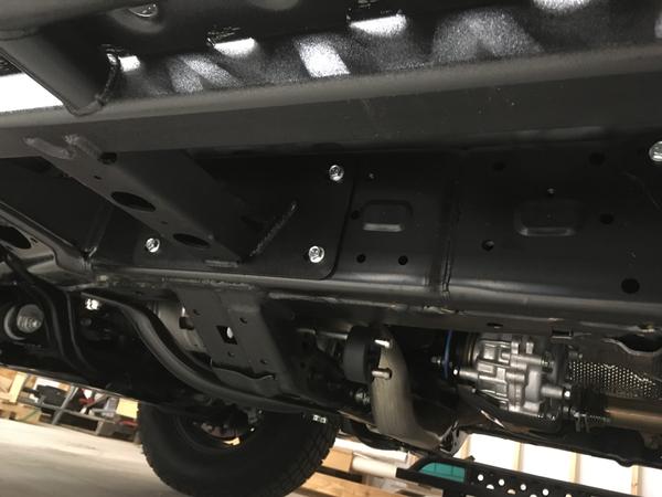

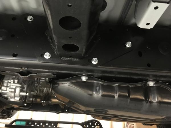

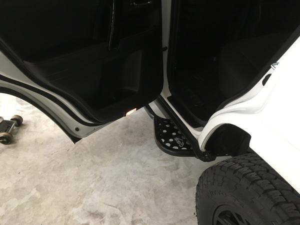

They are advertised as bolt on and they truly are. I popped out 3 of the frame plugs each side that would have been behind the plates and I took off the little plastic tabs at the rear of the rocker. I put a board and piece of cardboard on the floor jack and centered them up so they were balanced. I removed the bolt from the e-brake cable clamp. It was just a simple matter of jacking them into place, starting all the provided bolts and then tightening them up. If you have some mud time on your T4R, you'll want to blow out the bolt holes to clean the threads. There is an opening on the rear plates for the tab on the e-brake cable clamp so no need to bend them flat or cut them off. I torqued all the bolts to 30 lb. There were no fitment issues, no a single cuss word. Probably took an hour total to install both.
SSO makes use of all factory provided mounting holes, no drilling, no fishing hardware through the frame etc. Each mounting plate uses 4 fasteners and spreads the load over a wide are of the frame, this was very well thought out. Their boxed & gusseted supports are a departure from what others use. A feature I wasn’t sure about until I saw how well engineered they are. The provide an added measure of protection underneath and being angled, they should reduce the chance of hang ups on obstacles for you folks who use them as intended.

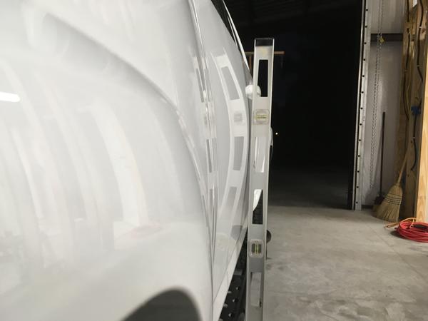

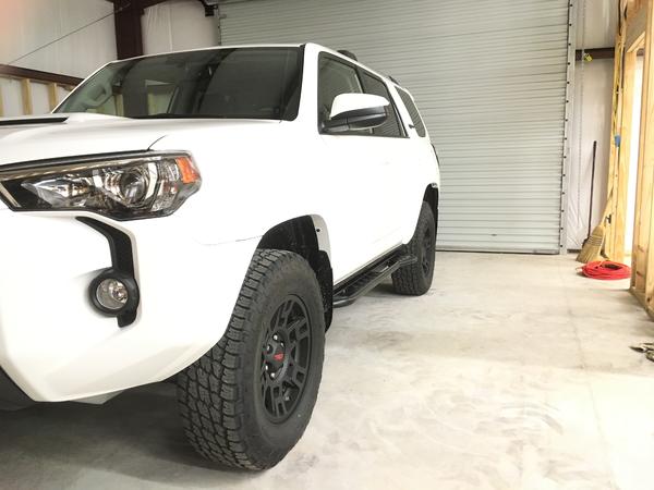

The sliders fit up snug under the rockers with enough room to clean out the mud that will accumulate, ends are tapered front & rear, again to prevent hang-ups. Initially in my slider shopping I found the angled lines of the kick-outs used by various manufacturers more attractive but after seeing the SSO’s installed, I like the looks of the curves more as they seem to blend better with the curves of the body style. The over all look is very subdued, less obtrusive than factory running boards of either style. They provide just enough toe hold to aid in getting in & out of the vehicle, they don't stick out so far as to whack your shins. I was a little worried they wouldn’t stick out far enough to protect against the door bangers but a quick check with the level shows that there is about 1/2” give or take protrusion beyond the body side.
Overall a very well engineered product, I’m very impressed with the thought & detail that went into the design and the level of customer service with my experience.
