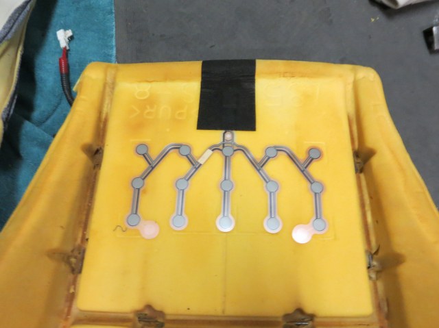

I've pondered a disable switch also, and have studied some of the diagrams. Its a relatively robust system, with a safing sensor in series with multiple crash sensors (accelerometers). In the end though, I'm not comfortable having an explosive device aimed at my head with a squib triggered by a modified circuit that interrupts some signal/power wire with the vehicle energized. The "simplest solution" IMO is probably to just yank the airbag all together (and perhaps someone can 3D print a "cover" for the steering wheel). Its probably not worth worrying about though.
Also note there is an occupancy sensor in the passenger side seat. Image below (at least, this is what it looks like on my '99). Its a fairly simple weight/continuity sensor with multiple contacts. I haven't traced the wiring on it to see if it interfaces the SRS system, or just the seatbelt light. If it disables the airbag with no passenger, then this would be easy to interrupt with a switch - however no such luck on the drivers side.
