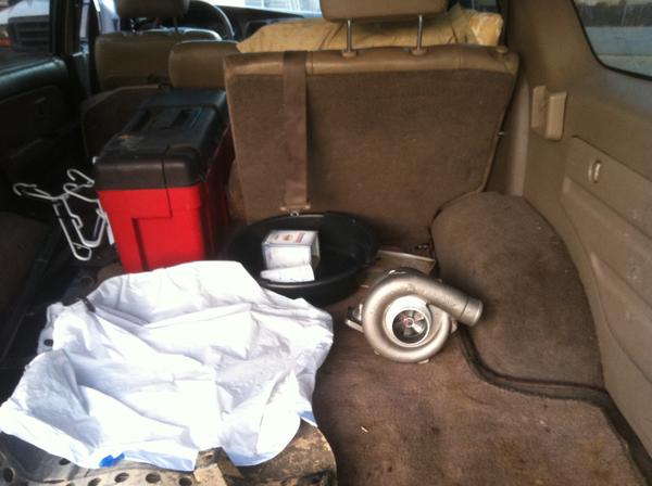

Ebay 5vz-fe Turbo

Workin' on it bud. Excuse the mess...

Steve beat me to it. And Robb, I see no mess. I see goodies! Lol
