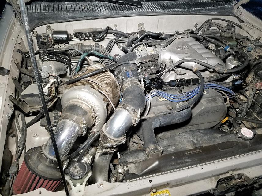

Not much to look at, but was everything i'd hoped for as far as performace. I've had it installed for 20k+ daily driven miles and was fantastically surprised at its fitment for being so inexpensive.
I planned to do a write up for the pipes, and entire truck, at some point. Not satisfied quite yet so i'll still hold off :)

Wow, so it's not just a Unicorn system after all!
I saw one other installation and the guy had all kinds of troubles with the down pipe and I guess the lack of exhaust flow throwing off the tune and some codes. How'd you make out there? He ended up modding the down pipe to go back in to the exhaust ahead of the cat I believe with some custom work to solve it.
Did you have a SC before? Curious on the power difference.

I had no intentions of using the stock exhaust at all, i had pre-bought a bunch of 3" piping, resonator, muffler and 3" v band flanges. I bolted up all the hot pipes, drove with an open downpipe for a few days then finished up the rest of the exhaust. I ended up side exiting it to save work & wieght.
I did not have a supercharger. Straight from NA to turbocharged. I never gained any strange codes nor running problems. Coolant temps, intake temps all good. AFRs stayed 14.5 ish to 1 at all cruising speeds, and high 13s at WOT. With methanol injection, small nozzle, WOT is 12.5:1.

6 PSI manifold pressure. I would speculate that my setup makes similar power to the average supercharged 10-12 psi 5vz.
Note i'm also at around 4500' elevation. At sea level I assume it would run lean, but not certain.
