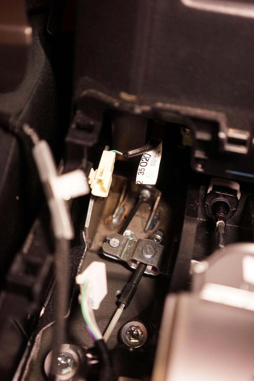

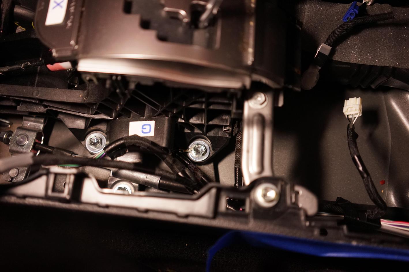

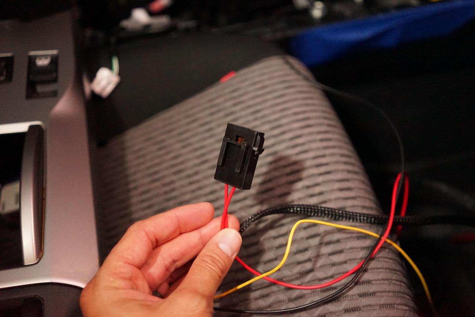

Mine has two separate switches (wheel Type) for each seat. It also has three wires Black, Yellow, and Red (red wire has a 7.5amp fuse built into it, as seen in pic below).
My plan was for wiring:
1. wire the two yellow wires to the light for the PNDR
2. ground the black wires to the bolt shown in the picture below.

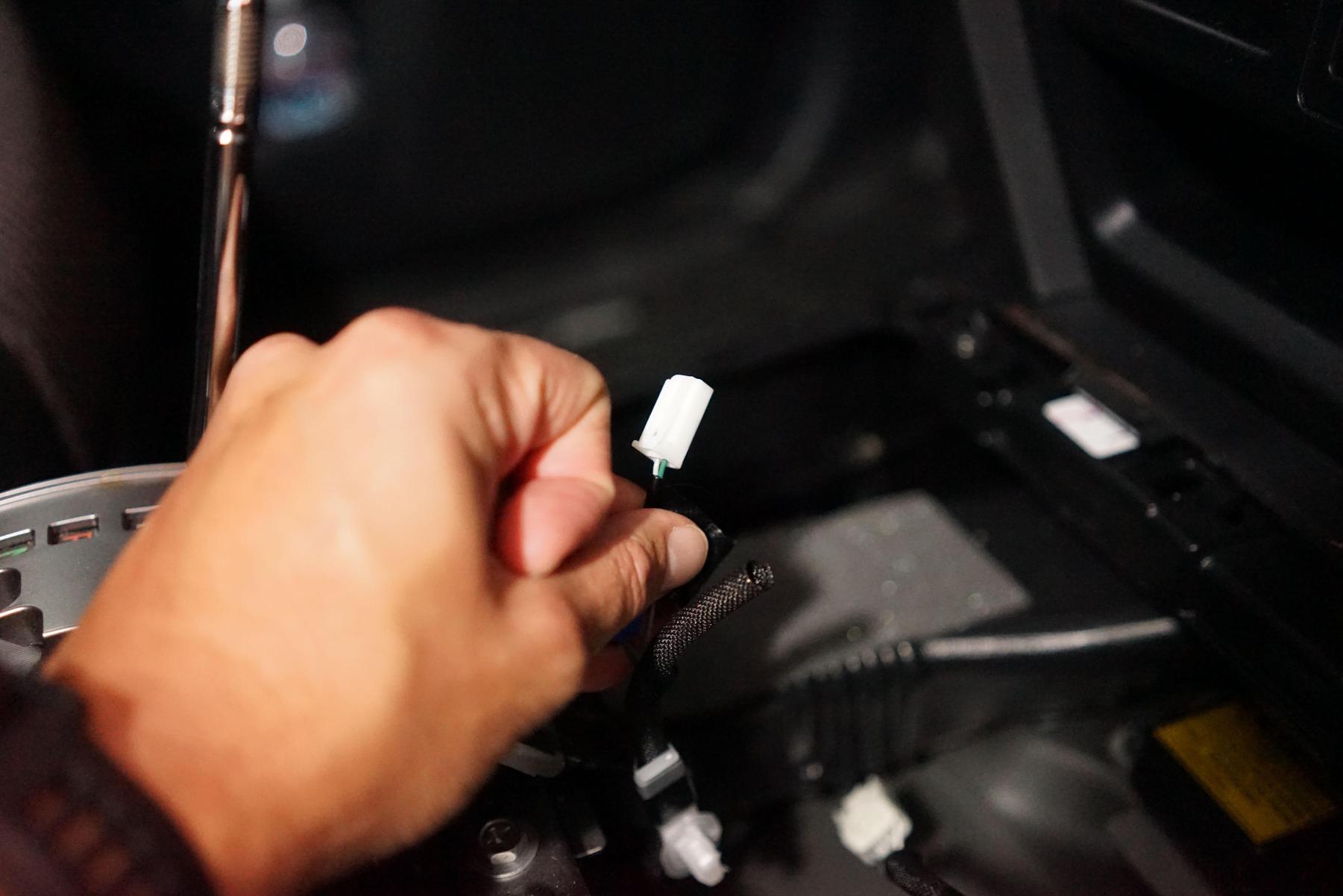

3. wire the two red wires into the accessory wires pictured. I originally thought this was the power outlet inside the center console but as yuou can see in the pic that one is much lower. Not sure what the one I was going to tap into is for.

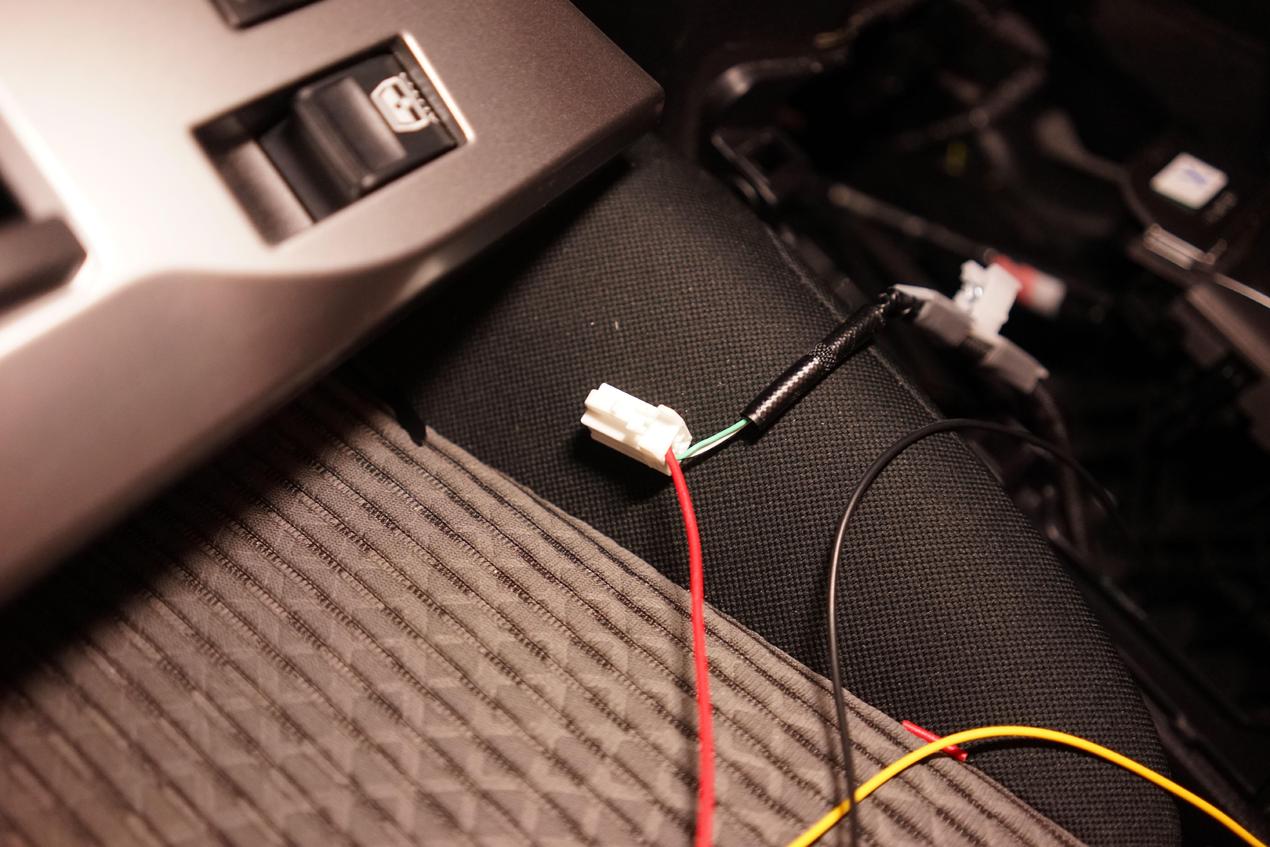

I did probably what I shouldn't and went for it with one of the seat heaters. I grounded it and slide the yellow into the PNDR lights green wire plug. Then slide the red wire into the green wire of the accessory (I think) plug. Then turned the car and tested it out.
Everything operated correctly. The green light on the heater switch turned on when I turned on the dash lights and the other light on the switch came on when I turned the seat heater on. The heat pads also seemed to work when I turned the switch on.
All seems well but it doesn't mean I am not doing something wrong. So I am hoping to get a little feed back from the experts here if they don't mind.
My intention is to connect the wires from each seat to the same connections. I am wondering if this would be an issue and is the green wire from the picture an OK power wire to tap into?

I am not a wiring expert but I would think that tapping into that small of a gauge of factory wiring that we don't know what it goes to is a bad idea. Normally factory wiring is sized to handle the designed (expected) max loads and nothing more as wire is expensive (ok , so I have never seen a design guidance document from a OEM but this is a logical assumption).
I would have expected the +12v for the elements to be installed via a fuse tap

Personally I would not tap a random(probably not random in your case, been a long night at work) wire for power. The gauge of the wiring you tapped looks very small to hold an additional load.
I would come off the ACC circuit at the fuse box. Or better yet run an accessory fuse box (like a Blue Sea box) off the battery.

I bought an Add-A-Fuse at a local auto store and plugged it into the heated seat fuse slot on the fuse panel. I should have just done it in the first place. The only wire I tapped into was the PNDR light for the lights on the seat heater switches. Also grounded the black wires inside the center console.
