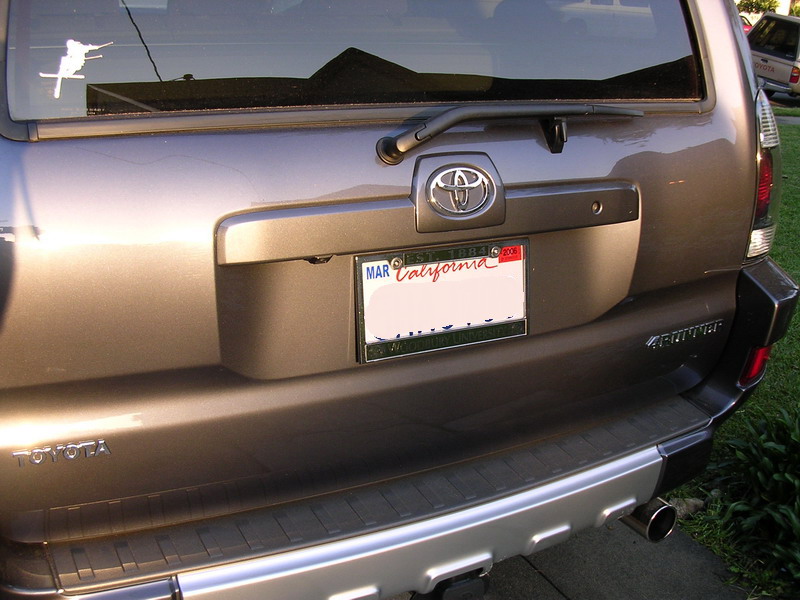

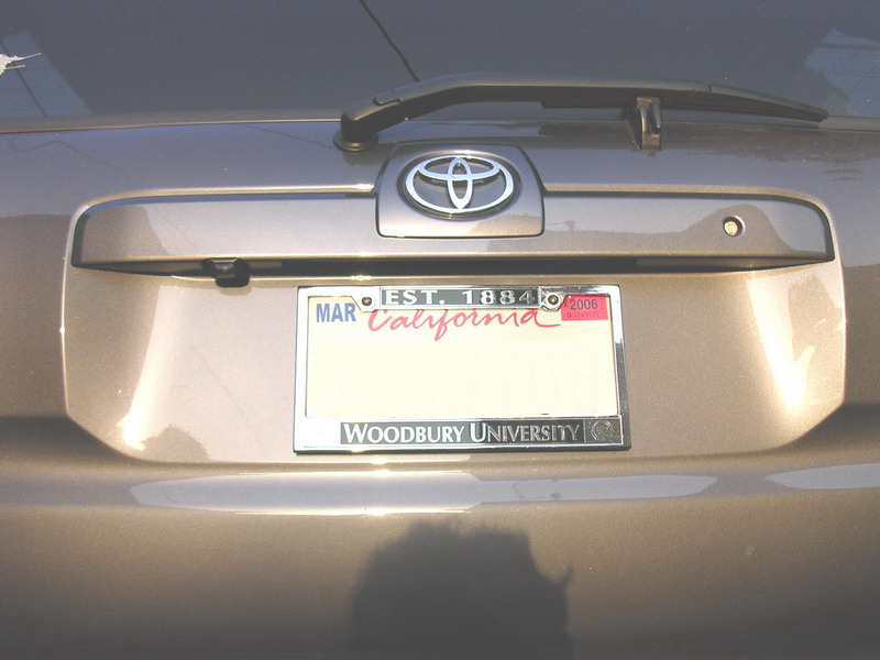

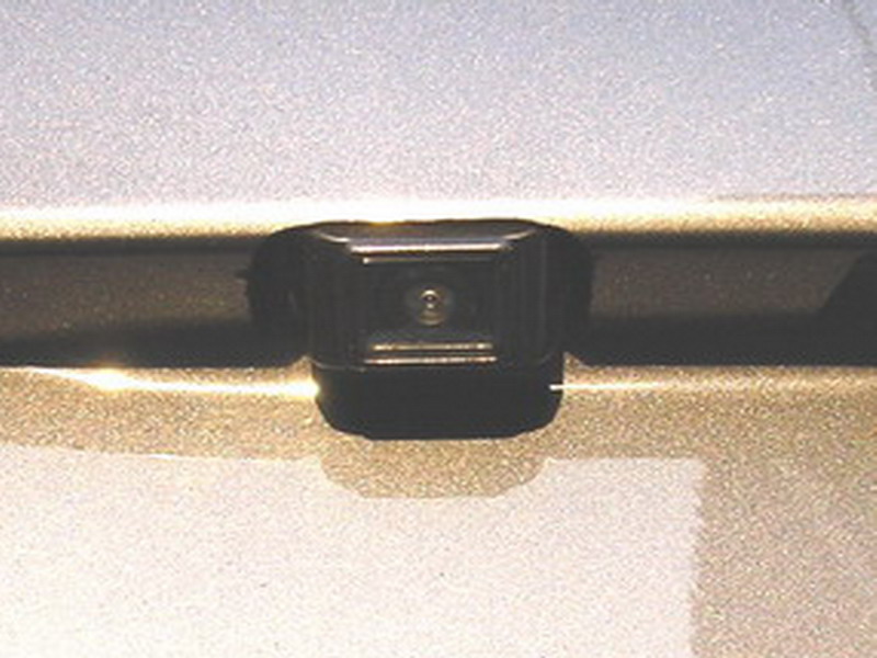

As promised....
Here are some pics of the rear view camera. First an overall, can you see it? It's to the left of the license plate....

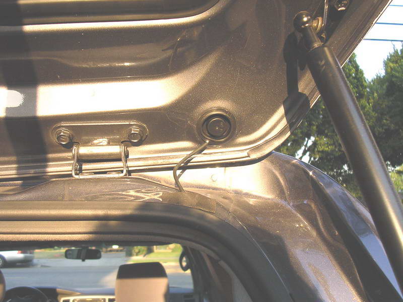

and this is where the wire is lead out through the door, down the weather stripping and into the truck...
