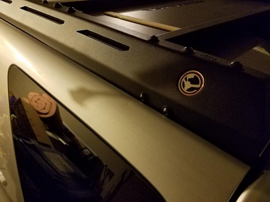

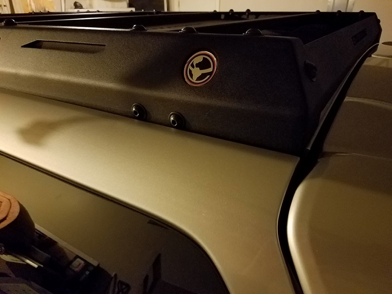

I bought some of these alloys with black oxide coating and put them on my tire black carrier to match. They rusted within a month from humidity just sitting in my garage. I took them off and replaced with stainless. Your best bet is painting or powder coating the stainless hardware.
Keep in mind those bolts will rust... being Alloy steel, that Black Oxide coating will not prevent the rusting.
The best thing is to stay with Stainless Steel hardware.
I would also like black hardware with my rack so I'll check around for black coated/painted SS hardware.

STAINLESS STEEL(SS) Button Head Screws Black Oxide 18-8 (SS)-3/8-16x1-1/4"
Close up look. Cleaned/washed/ Polished /protected/ the Powder Coated Roof Rack
Just to share with you, the way I have this rack set up, I have no wind noise, no vibration
with my Sunroof opened or closed at any mph and my wife and I can actually have a normal conversation.
Interesting Aero-Dynamics
