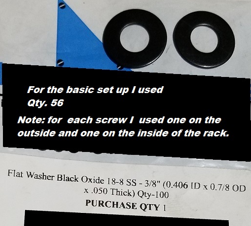

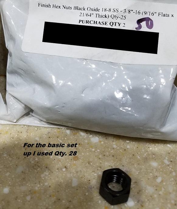

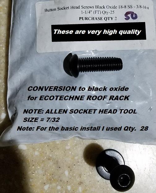

Here you go, this is what I'm using, plus I added 304 SS HIGH COLLAR LOCK WASHERS #3/8 Qty.-28 Note: you can not notice them between the Black Oxide washer and the nut. Hope this helps. (NOTE) This is for the original ECHOTECHNE ROOF RACK DESIGN, the new versions of racks have changed some, and will require changes. I used Socket Head Screws a2 SS-M-8 x 1.25 x 35M to mount the roof brackets to the roof top with washers. I also used THREAD LOCKER on the threads as seen on the OEM threads location.

Thanks quicksandTRDPRO for sharing this info on this thread, on where to find and what I needed of the Black Oxide hardware, it is perfect for me on my ECOTECHNE roof rack. That company gave me excellent service, and quick delivery!

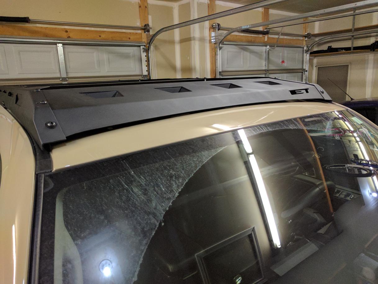

Got mine on today. Solid rack, agree about the PC being the only real downside. It's definitely not a deal breaker. I like the black hardware. Maybe they can look into using that instead.
