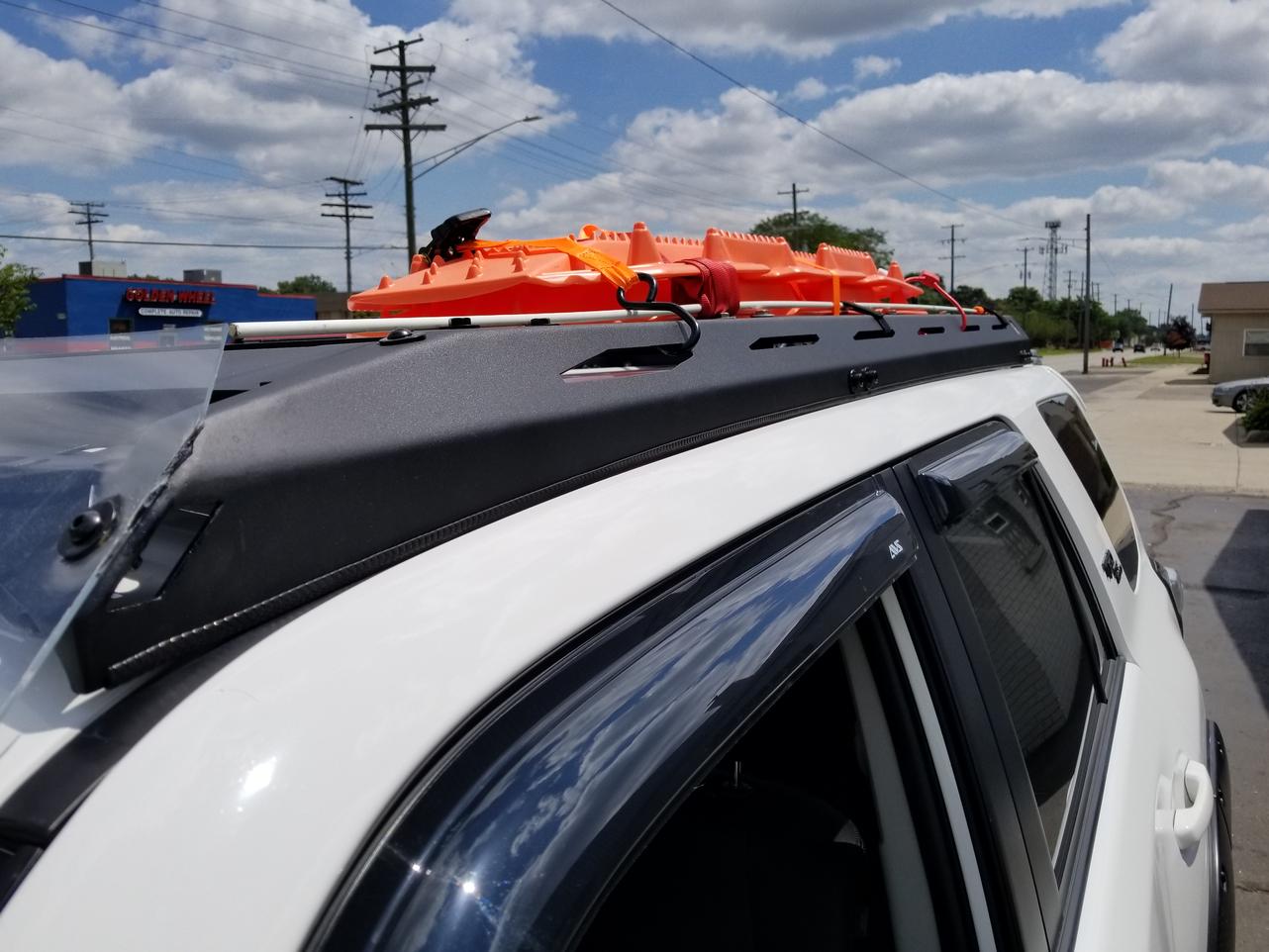

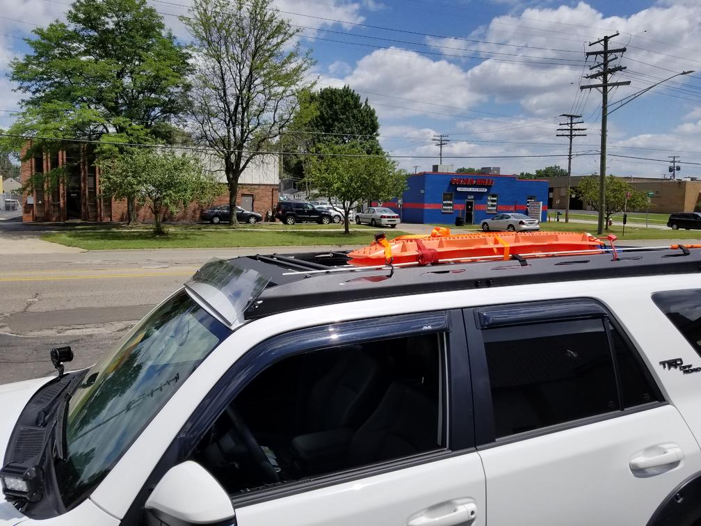

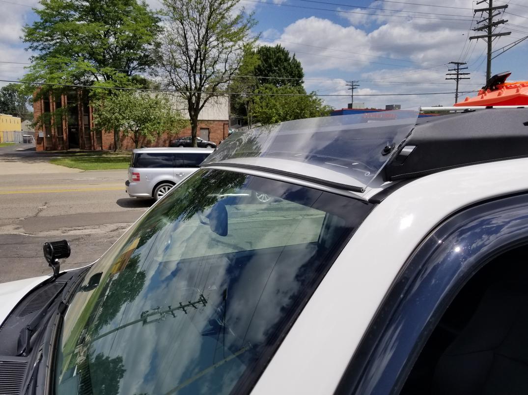

Received my roof 10 days ago. I was not so happy about noise from 60 mph and up. next day made some deflector and it is works great, at 85 mph no noise at all.

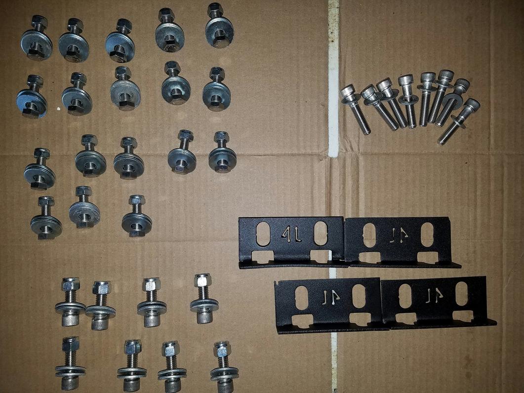

I was in the 8th batch and received my 5th Gen V2 rack last week. The rack was packaged well and was wrapped like a cocoon with several layers of cardboard, shrink wrap and bubble wrap. I finally had a chance to unpack and sort through it and noticed several things.
1. The four mounts that I received look about the same size and 3 out of the 4 mounts cut out letters are reversed. I believe the V1 racks came with 2 small and 2 large mounts.
2. I receive 18 Hex bolts, 36 washers and 18 loc-nuts. V1 racks came with 20 bolts, 40 washers and 20 loc-nuts
3. I received 8 M8 x 1.25 allen keyed bolts with 8 washers and no loc-nuts. V1 racks came with 8 bolts, 16 washers and 8 loc-nuts.
4. I received 8 standard allen keyed bolts with 16 washers and 8 loc-nuts. Same as V1 racks.
I also did not order any extra crossbars or trays.
Folks with the 5th Gen V2 please confirm if you received the same items or not.
