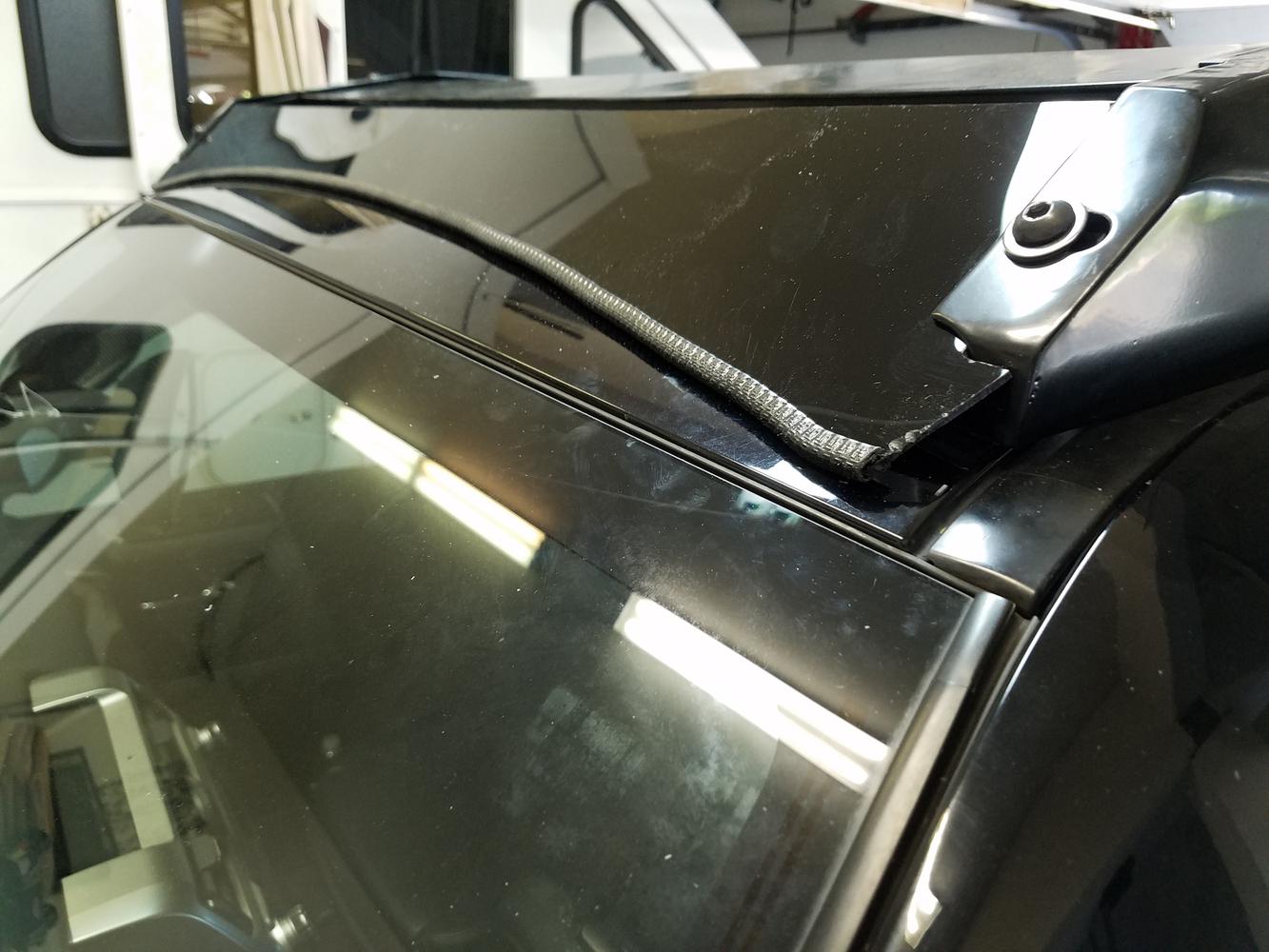

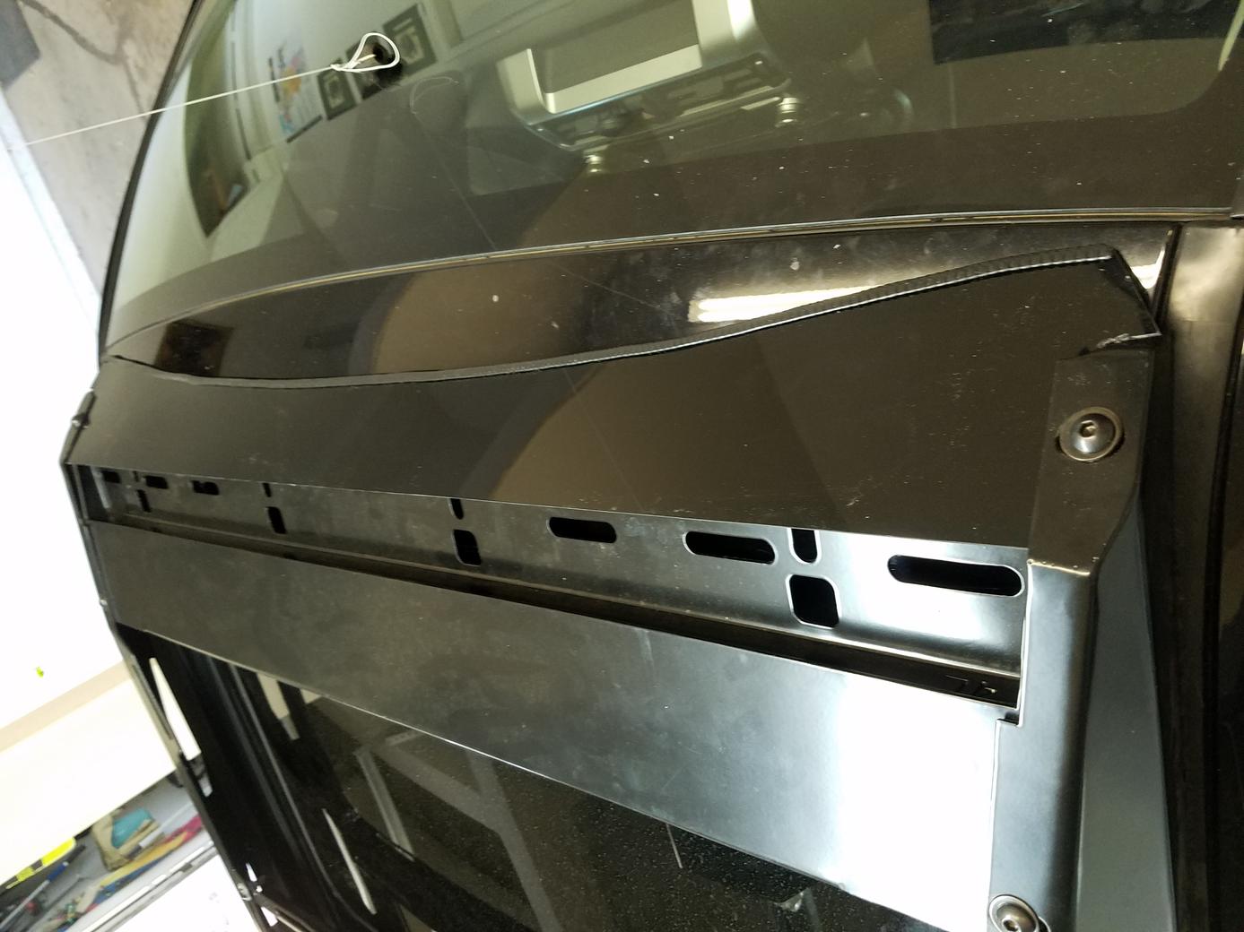

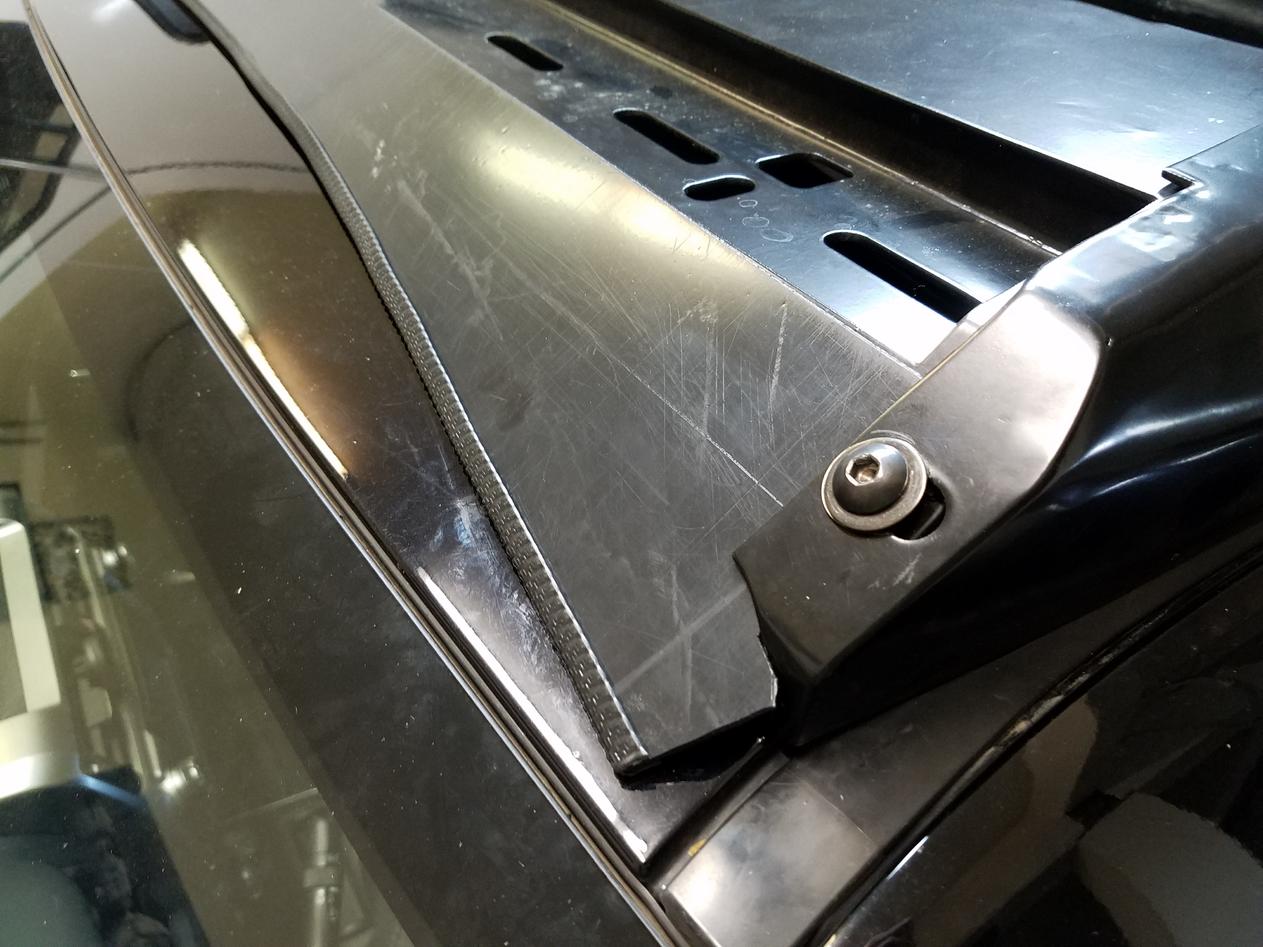

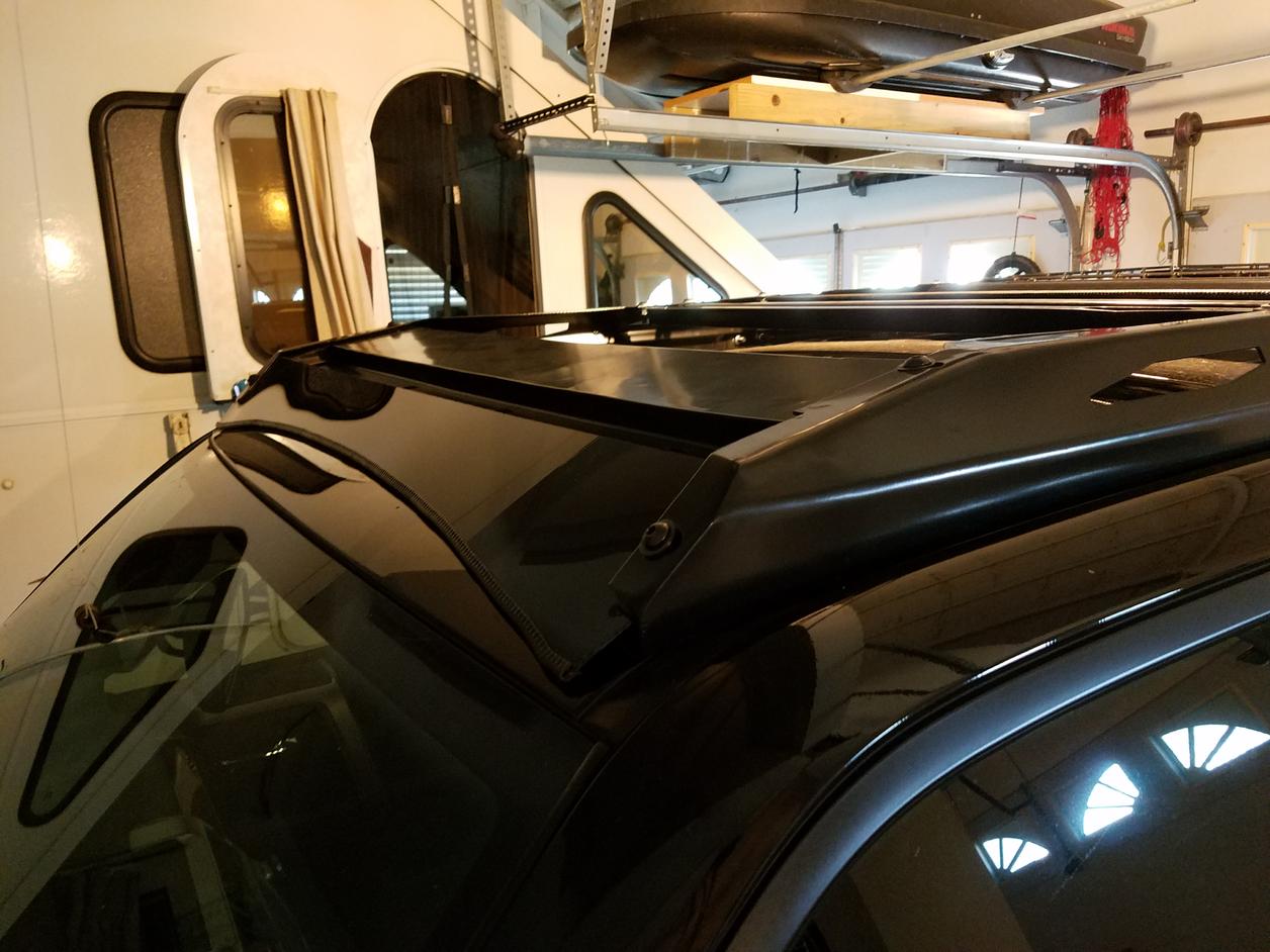

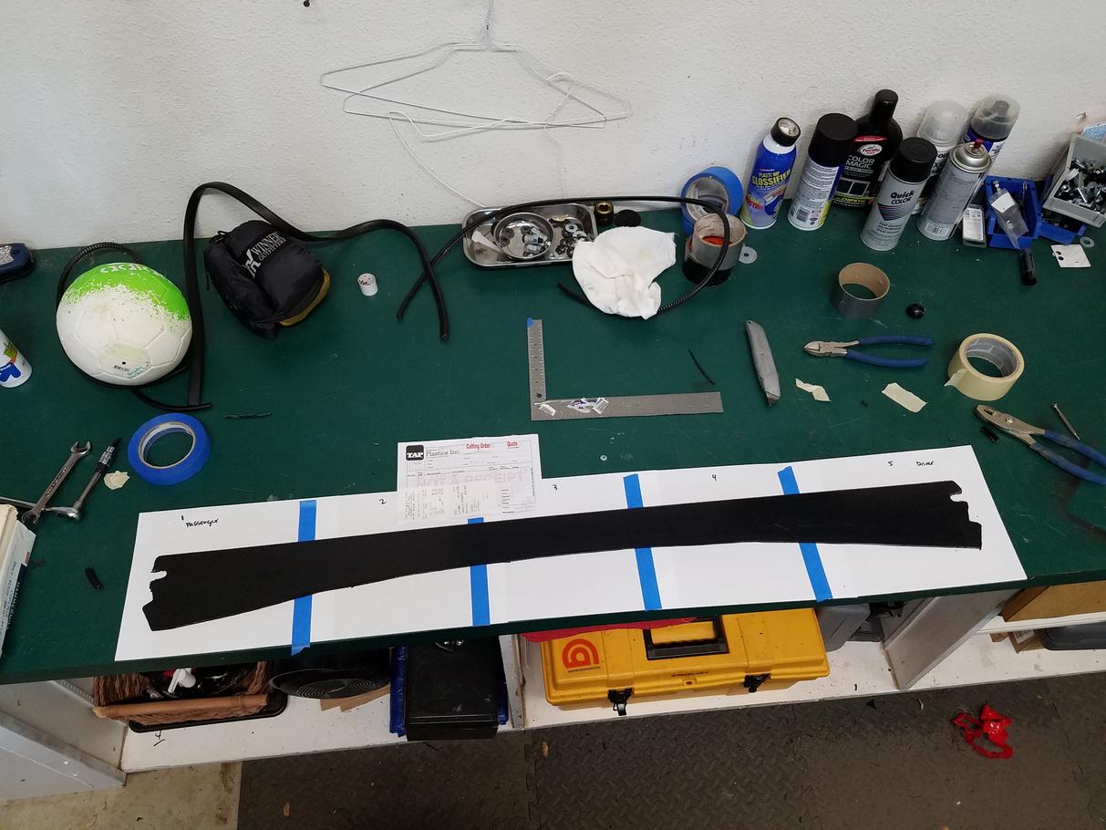

The gap on the v2 has been bugging me so I tried to go off of other's ideas on how to fabricate a fairing. Here is a scanned template that you can download, if anyone is interested.
https://www.dropbox.com/s/vo2ef78s4oixa3h/fairing template.pdf?dl=0
The template fairing is flust with the front most lower step (below light bar step) as pictured here:
This was using 3/32 plastic I got locally. However, 3/32 is too thin; when in the sun it warps, creating a gap.
So I ordered black plexiglass from Amazon. it comes in 48x12 sheets and the seller will cut in half lengthwise so you get 2 6x48 sheets delivered for $15. Here is the link: https://www.amazon.com/gp/product/B0193ML2TI/ref=oh_aui_detailpage_o08_s00?ie=UTF8&psc=1
I added 1" to top of template so it would cover the lightbar gap (I am not running light bar)
Edging is here: https://www.amazon.com/gp/product/B00N9VGATW/ref=oh_aui_search_detailpage?ie=UTF8&psc=1
Hope this gives others some ideas or a starting point. Good Luck!
