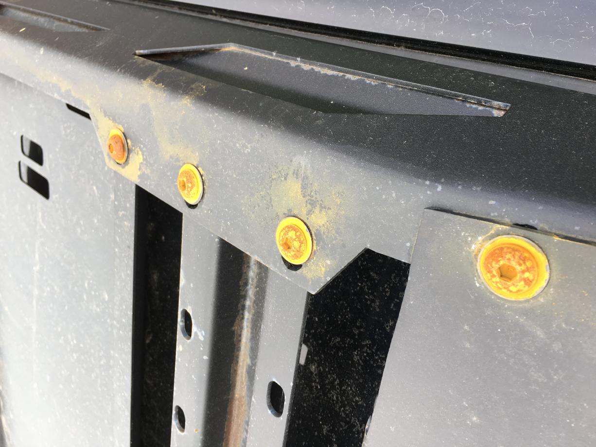

And this is what my black oxide nut and bolt look likes now... ;(

I had some minor rust spots on my crossbars, but nothing like that on the black oxide nuts. I think mine were stainless/black oxide?
Anyway, for the cross bars i took a foam paint brush and applied 2 coats of a rust converter, following all instructions on the bottle.
I let that set for 48 hours then applied a coat of POR-15 (45904) Top Coat Chassis Black - 1 Quart. to the crossbars.
This was about 2 months ago and they look great.
I think this may be a year to 2 year process that will have to be repeated to ward off rust. I also live by the Ocean and have NY winters to deal with.

Wow, that looks awful. Where did you get those nuts from? I purchased and installed a set Black Oxide Stainless from Albany County Fasteners back in July and have no rusting issues with them. It has also rained here numerous times since then and I've driven on the beach several times as well.
The only rusting issues I have are on the rack itself with the poor powder coating. I'll probably get the rack powder coated again next spring or do what [MENTION=153057]lbaschi1[/MENTION] with his.

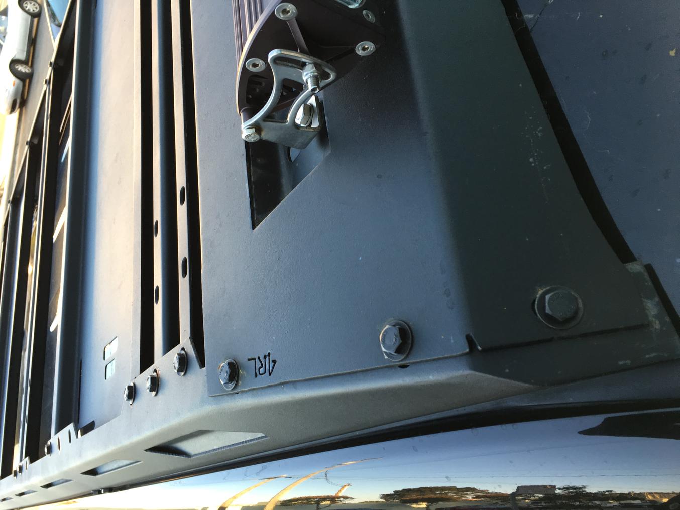

Sorry to see that. I bought my screws/hardware from Albany County Fasteners and mine have been installed now about 7 months.
Mine are Stainless Steel Black Oxide. My vehicle spends 9 hours, 5 days each week parked outside at work in hot weather, wind, dust storms, and rain. That looks like damage from fog, and ocean salt. I do have a few places on my washers where the black oxide worn off a little to the stainless but no rust. As for my roof rack, a few thin scratches, and my ladder came with a little rust on my top mount bracket. When I looked at your photo, I went out and gave it all a look over and snapped a couple off photos. I do wash and wax my vehicle once each week at a brushless/no pads, water jet car wash.

Crap I think I bought just black oxide, i thought it was stainless steel...
I’m going to contact the company and see what they can do...everything else I bought was stainless steel black oxide.

Black oxide is a plain bolt. Has zero protective coating at all.

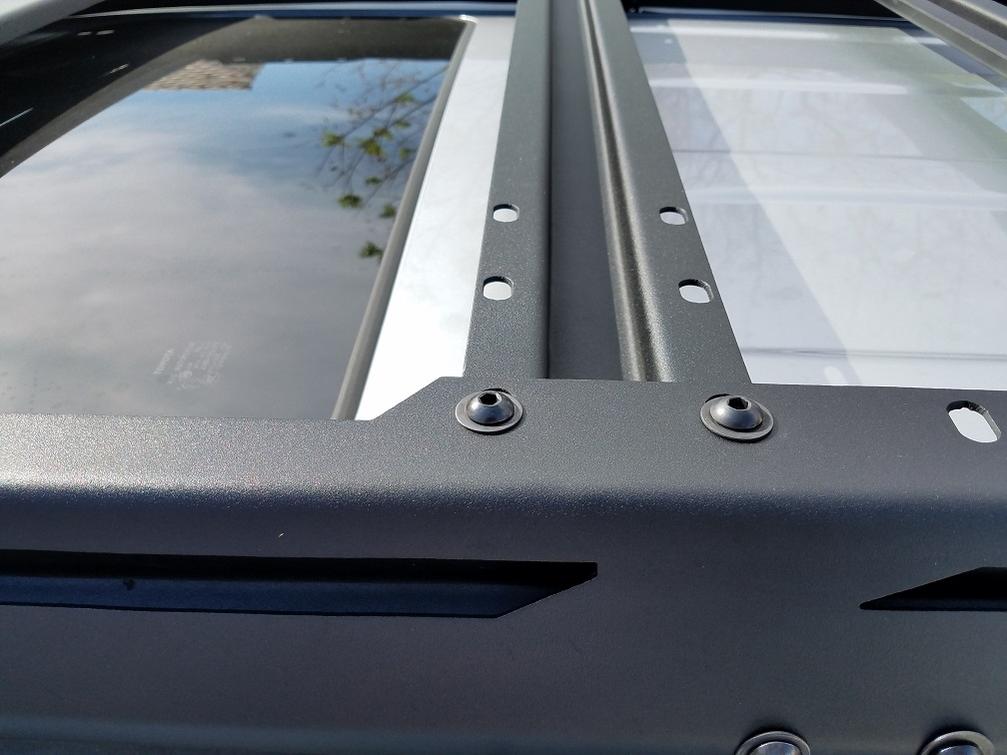

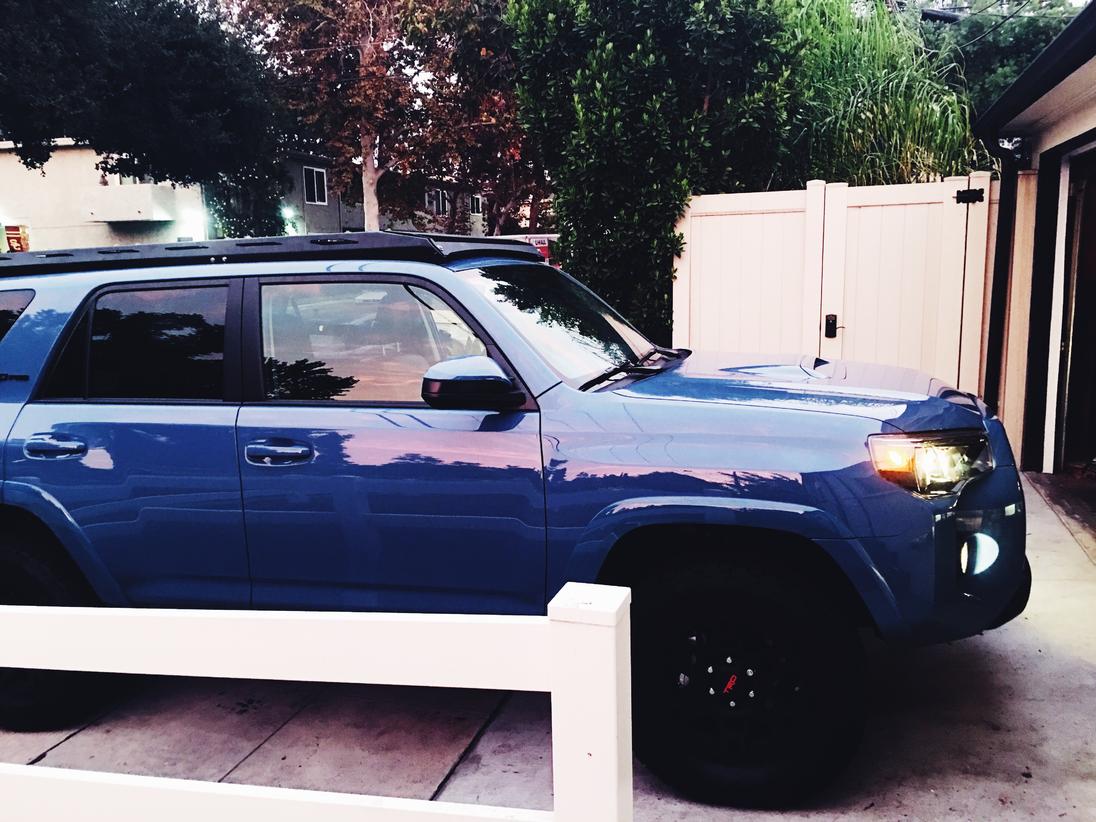

Got my v2 put on.

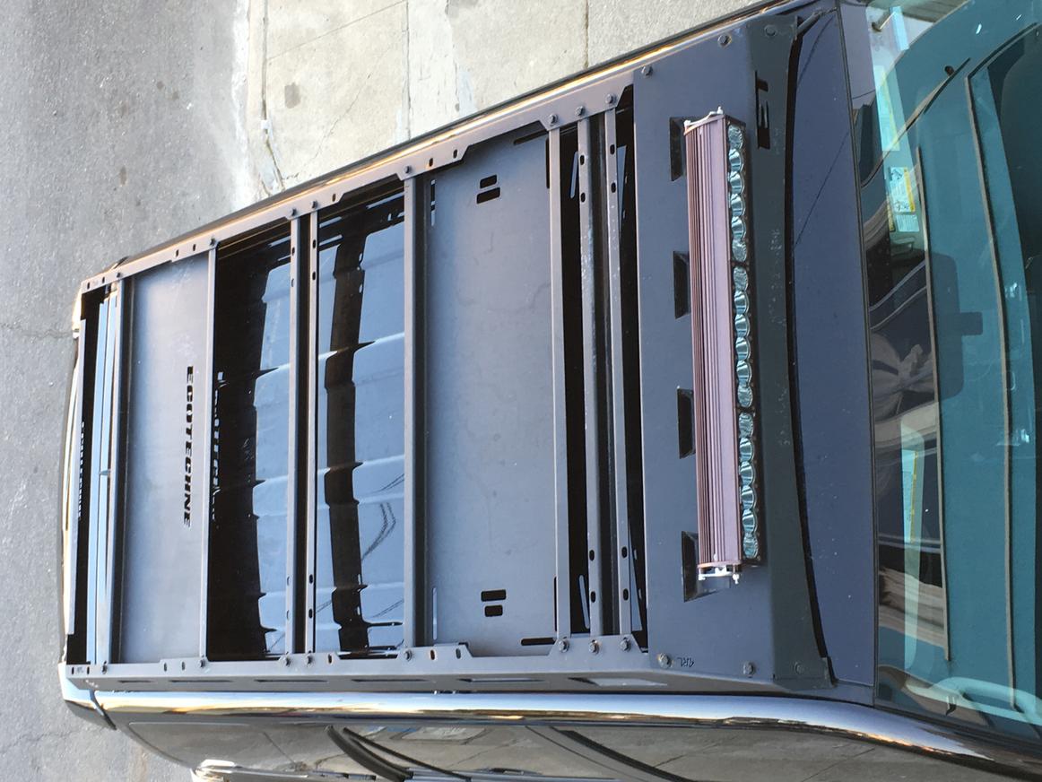

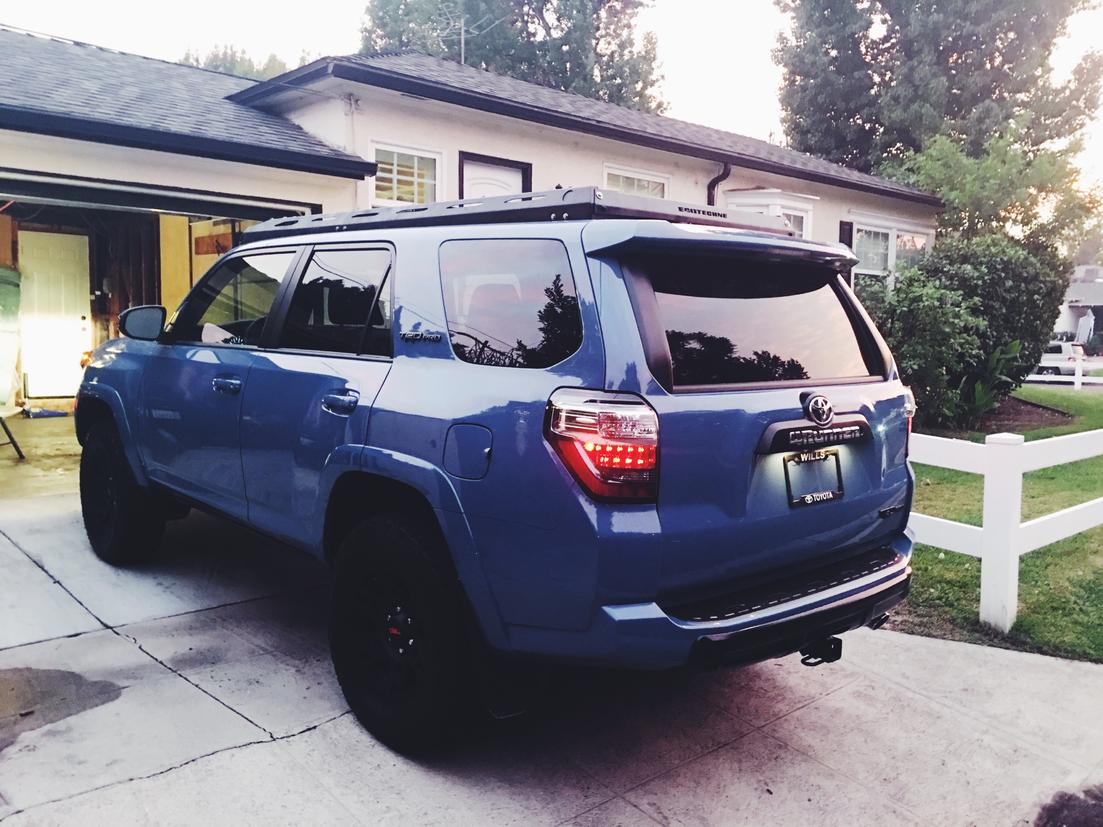

Replaced my bolts again....this time I made sure it’s SS black oxide.
