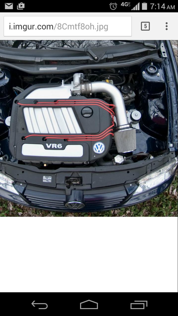

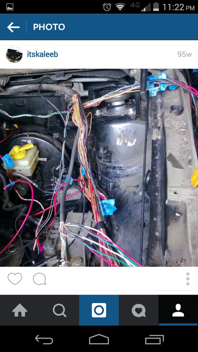

Unlike most, I have actually 'been there' and 'done that'. Not on a 4runner, but on a friends vw mk4 vr6. We recorded no voltage drop after 4-5ft extensions.
Like others, I do not recommend it. Too much work for very little benefit, of which the benefit can be achieved by other methods more efficiently.

Why would you do that?
It was a show car. Its called an engine bay shave/tuck/delete. Popular with the sorta crowd who likes their car but know its not a racecar :lmao:
Attached is the end result.
