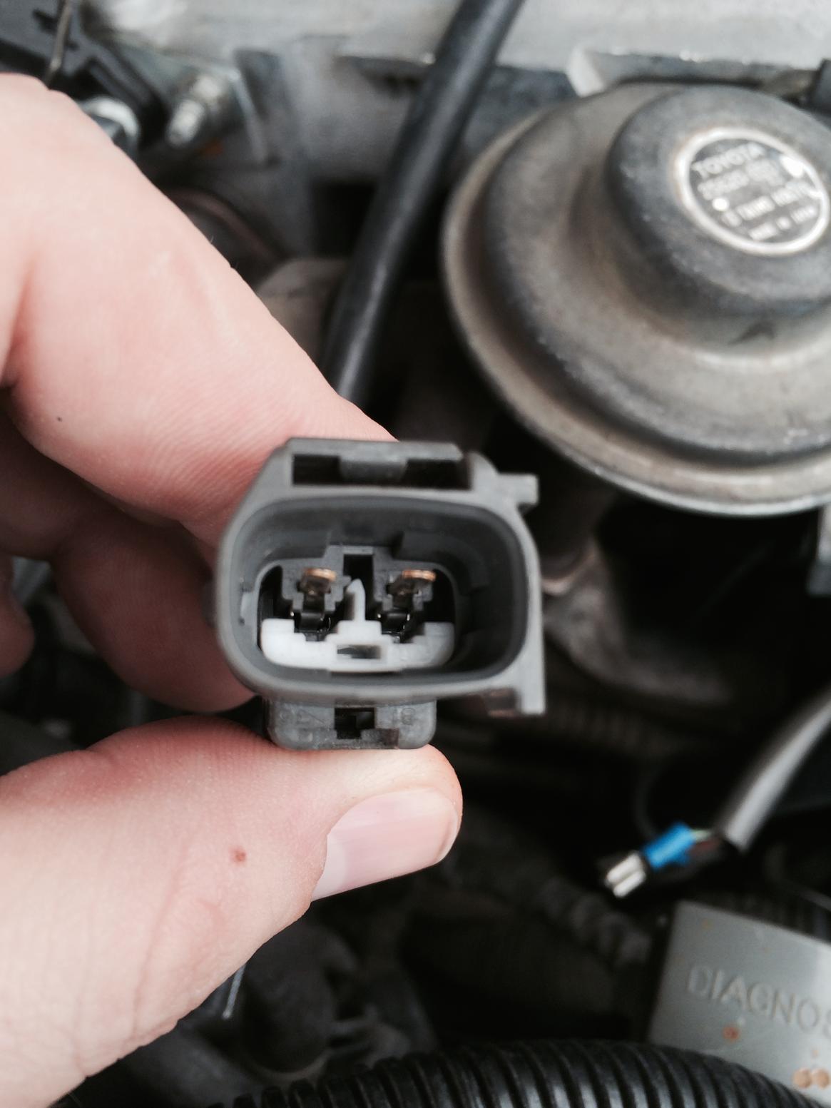

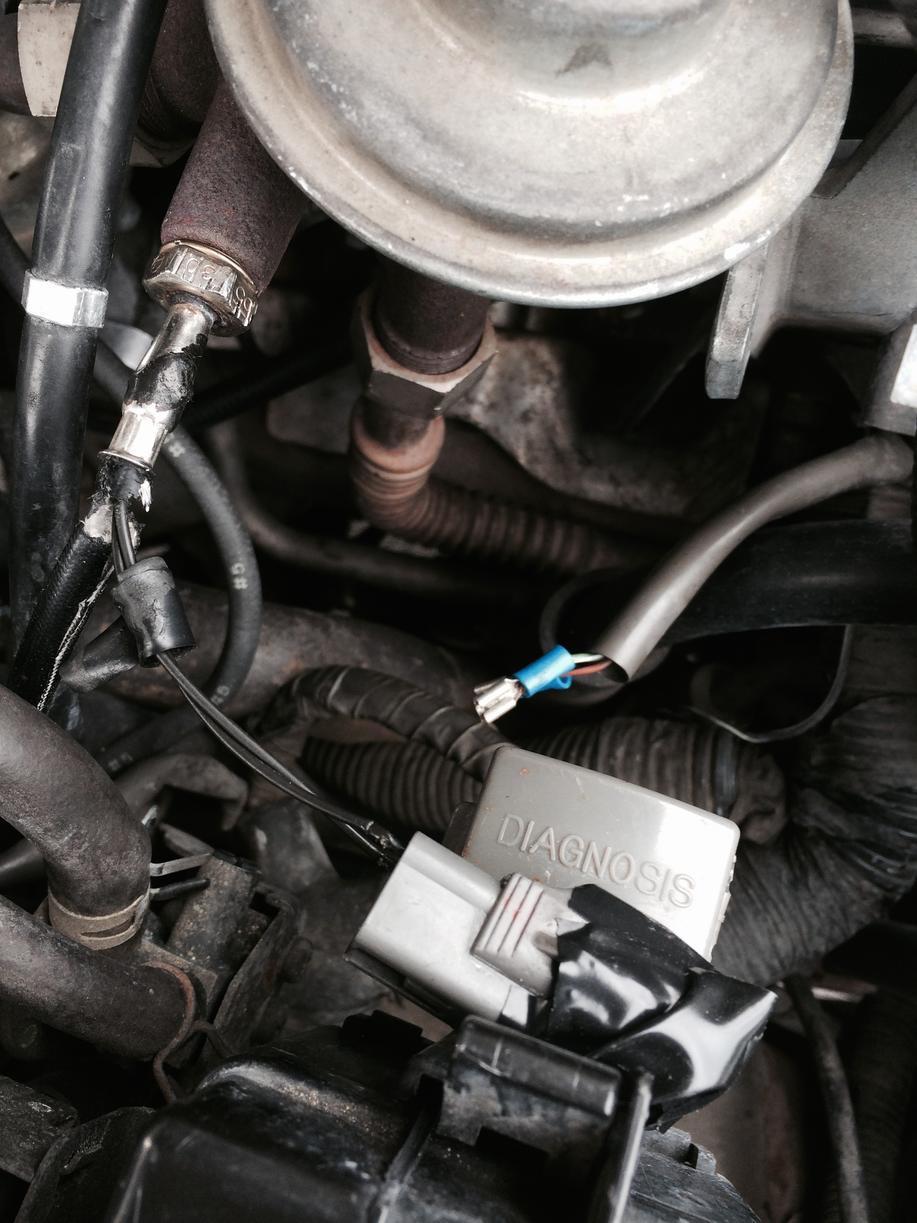

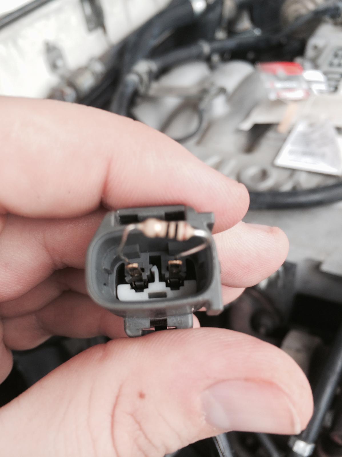

I'm testing to see if my EGR Temp Sensor is actually functioning. Added pictures of the 10k Resistor to make sure I did it right AND to show anyone else who is a visual learner. If the CEL goes away, I should know that the Temp Sensor was the problem although I'm not hopeful... Checked the resistance on 2ok setting and the meter stayed at "1" so either the sensor is no good OR I had an incorrect reading. Any thoughts??

Wouldn't you want to connect it to the other side of the plug (not the one going into the EGR modulator)? Did this work for you?
Yep. I had a CEL with code 71 and did this. Plug your 10K resistor into the plug that mates with the one shown in the pictures in this thread. It solved my issue.
