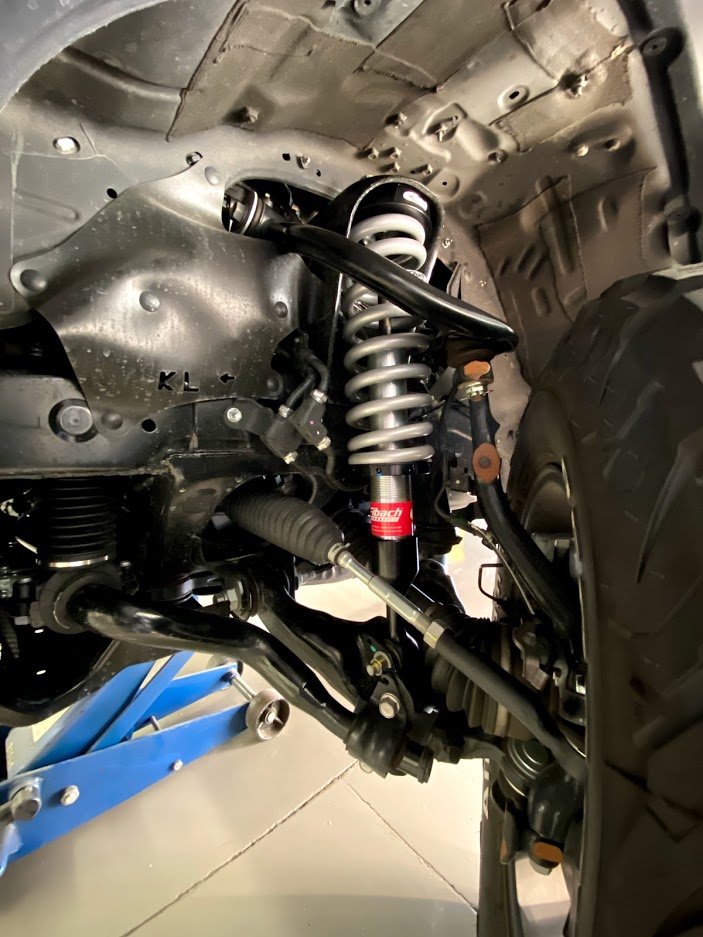

Received yesterday [MENTION=277772]mark@eibach[/MENTION]... and installed yesterday. Little stiff on my end, and still working measurements out. Look for it to sit at 2" with running 200lb/static. I set it at 26mm and am pretty happy!

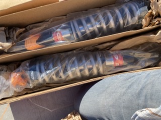

Finally joining the club and will be doing my first mod to my 5th Gen with the 2.0 coilovers and the rear leveling kit. Shout out to Tanner at Eibach for setting me up. Eibach was out of stock like everyone else for the fronts and rears load leveling kit. I found that Stage 3 Motorsports had the fronts in stock and I got those 4 days after ordering. Eibach had the rear shocks in stock and I got them 2 days after ordering. FedEx tracking says my rear leveling kit left Eibach 4/7 and I am expecting it tomorrow. I’m exciting and will post pics as soon as I get it all installed.

Same here on the 2.0 and agree with everyone, out of the box they're almost at 3" but I had no idea initially and cranked them another inch! Needless to say, the down travel was definitely maxed out so we dialed it back in to 2.75"
Nice! I'll pass this along to Tanner. I wish this wasn't how you had to work the system, but these days, you just have to get it wherever you can find inventory. We're doing our best to keep up with demand and get you guys product as quickly as possible. We are looking at this DAILY and doing our best to provide answers and customer support wherever we can.
