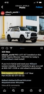

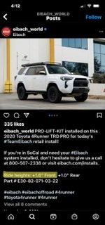

This is off Eibach Instagram They do installs and this is there advertised height (lowest).

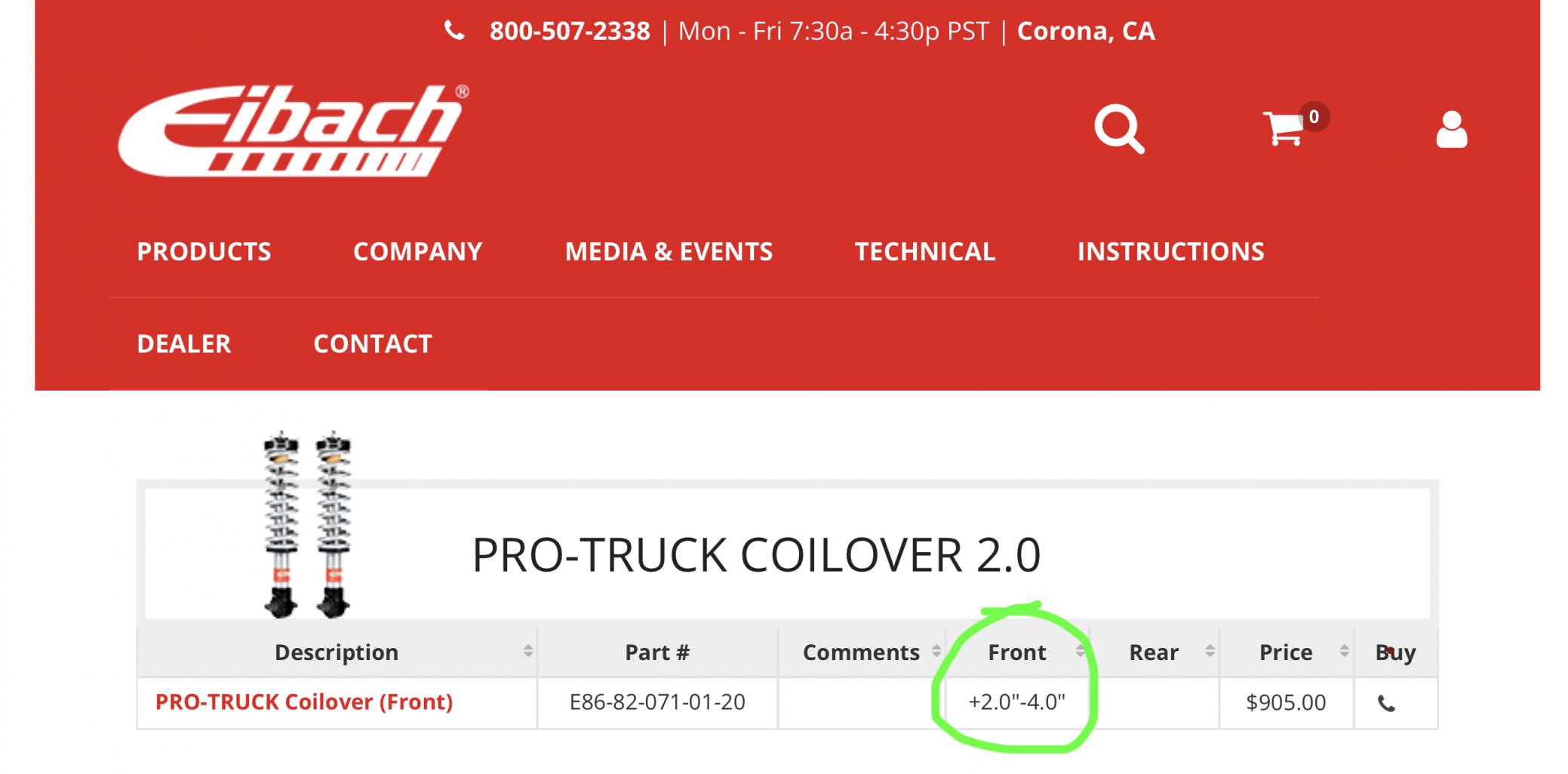

PSA:
It seems Eibach has changed their information on their website regarding the height adjustment on the Coilover 2.0’s.
See photo.
