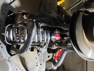

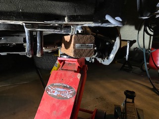

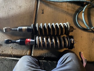

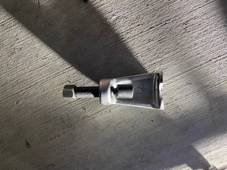

Got the fronts on! Wasn’t that bad with kdss, hardest thing was getting the damn tie rods to drop from the knuckle( I advise renting the tie Rod puller autozone carries, the hammer to knuckle didn’t work for me). I didn’t have to disconnect the KDSS, I jacked up the KDSS piston to do the passenger side then jacked up the passenger lca do to the driver side.

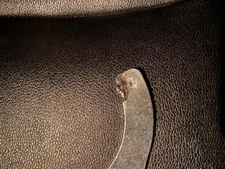

I adjusted one side down from 16 to 4 threads since the height they came with was damn near over 3 inches. As I began the passenger side the spanner wrench pin broke. I tried to weld it back on but after a few turns it broke again and I gave up. Hopefully the alignment place tomorrow has one.
Overall took me about 3 hours and would have been less had I rented the tie Rod puller ahead of time. I’m a ok mechanic and have experience with suspension and chassis work. If you have the tools this is a doable job for most if follow the directions and have a friend helping.

I would contact Eibach and inform them of the broken spanner. They said they have an older one and a new one and it should not fail! (Not the billet, as it’s not available yet)
I reached out to them and they are sending a new wrench. I had one of the newer ones which unfortunately still broke. I have bolts on top.
