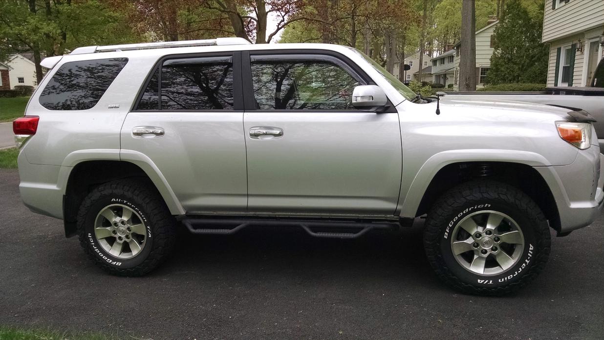

I have the same coils with 5100s. The coils alone gave me approximately 2 inches of lift with the shocks set at 0. I added the toytec 1/4 inch spacer on both sides and I ended up with approximately 2.25-2.5 inch of lift.
So, with the 112620 coils giving a 2 inch lift, then the .85 setting gives approximately 1+ inch of lift also, you would be right at 3 if not more.

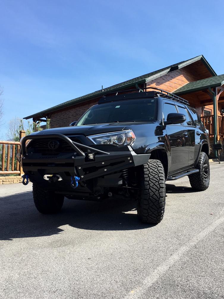

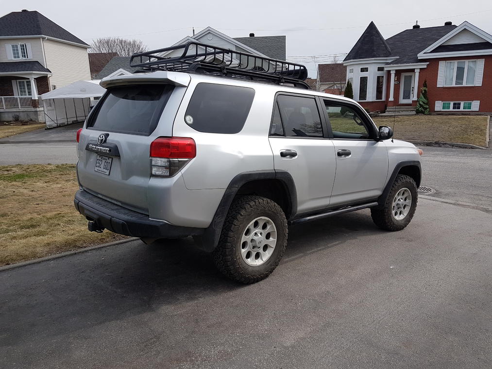

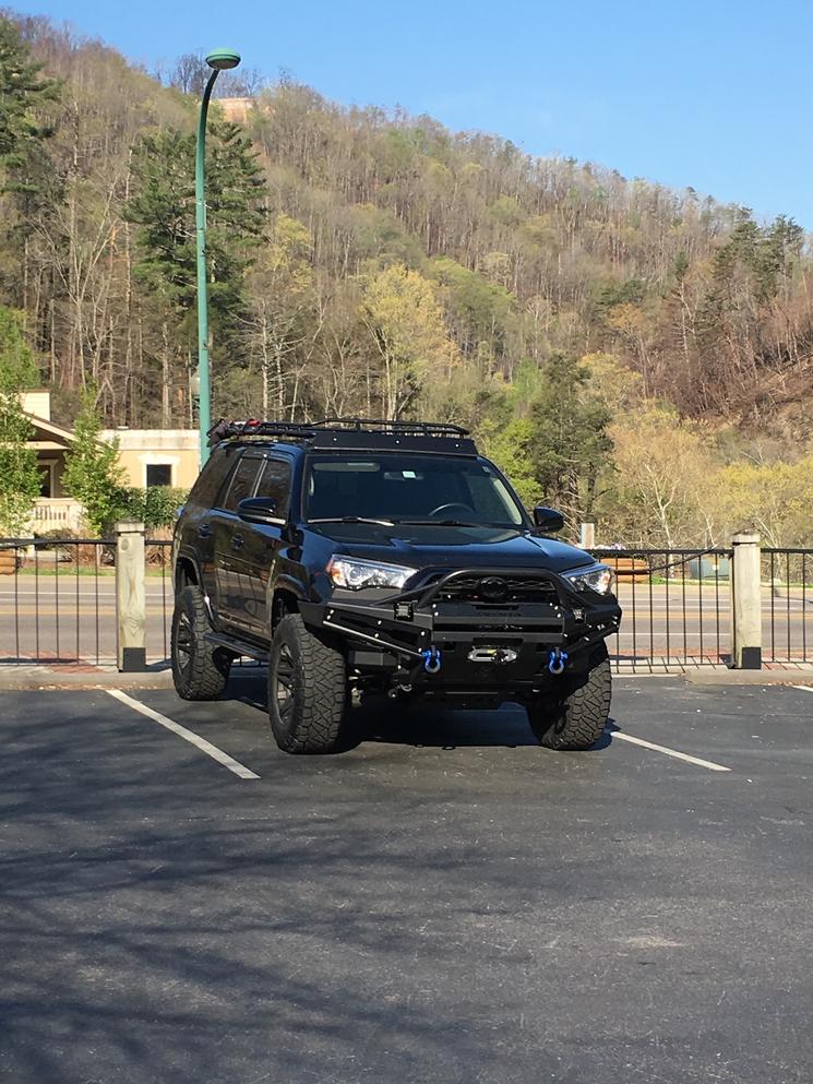

I also have the same setup. When installed the coils with the bilsteins at .85, gave me almost 3 inches of lift. Settled in just about 2.75. I added a bumper and winch and lost about another 1/2 inch. Back to the drawing board.

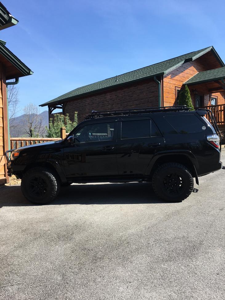

I'm late in the conversation, but I do run the exact setup for about a year now. Setting the Bilstein to 0, no diff drop or UCA, the alignment still in the green.
I do run BFG 275/70/R17 Load E and I really love the setup.
