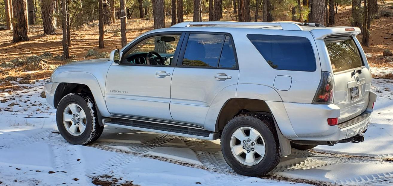

Picked her up from the alignment shop and took her for a ride. I am VERY happy with the results. Road manners are vastly improved. Took a small detour down a Forrest Road and enjoyed the improved ground clearance and ride.
Fine print: I purchased this 2004 V8 Limited knowing the XREAS was toast.
I assembled the front shocks and springs on the second clip from the bottom, using new top plates. Lower control arms were replaced at the same time, as the alignment bolts had to be cut out. Alignment hardware was replaced with Factory Toyota parts.

Hey thanks for PMing me and getting me to this post. Looks good! So remind me, you bought the full Eibach Pro Truck Lift (Stage 1), right?
You set it on the second lowest clip. According to the install docs, that should net 3.4" of lift. Did you happen to take before and after measurements?
What size tires are you running?

It is the full kit...4 springs and 4 shocks. Eibach says 1.8" lift with the V8 4Runner, so I used the second clip from the bottom.
I didn't bother with before measurements because the XREAS system had leaked dry.
Tires are stock size 265/65-17 Coopers.
Looks great! Didn’t even consider the V8 being that much heavier. What’d they say the second clip should be for the V8?

I called Eibach and they said it should be level on the second clip. I can't say enough good things about my experience with Eibach!
That's funny, on mine the first clip was pretty much level. It always amazes me how much variance there is with these lift kits...
V8 or V6? I’m leaning on the lowest setting to keep a little factory rake. On Eibach site it shows 1.8” front and 1” rear for V8. On the V6 it shows 2.75” front and 1” rear.
I installed the kit on my v8 4R at the lowest clip and got a slight rake - I like it, and when loading the rear, it sits level. Rides great.
I used the second from the bottom because I will be adding a steel front bumper and winch soon. With the added weight of the V8, I was concerned about the front end being too low. It is level now, so I expect it to drop a bit after the bumper and winch install.
