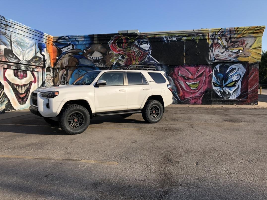

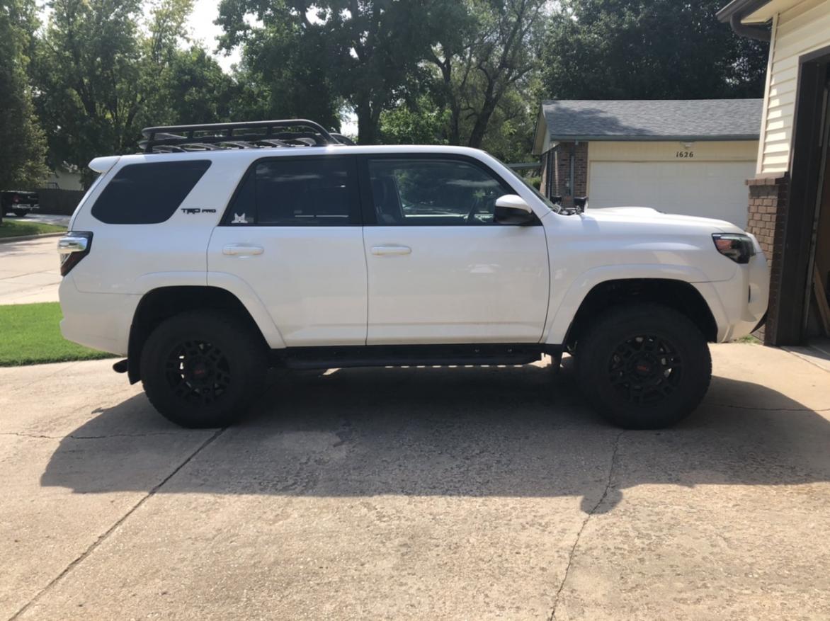

Eibach springs front and rear with 285/70/17 Ridge Grapplers. Have spidertrax 1.25 spacers installed too. Had some slight rubbing at times on fender liner and mud flap that a heat gun fixed for now. Quick eye ball measurement with stock tires.
Stock tires before
From ground
FR 35 1/4
FL 35
RL 36 3/4
RR 37
From hub
FR 20 3/4
FL 20 1/2
RL 22
RR 22 3/8
Stock tires after
From ground
FR 37
FL 36 3/4
RL 37 1/2
RR 38
From hub
FR 22
FL 21 3/4
RL 22 1/2
RR 23

Did you have to do any kind of BMC? I'm hoping to not have to do that but still go with 285s
I’m waiting on my springs. When you say a heat gun you heat the inside wheel well and push it in more? I know some guys remove the mud flaps.

You have exactly what my next 2 mods are going to be 285's and Spidertrax, thank you for the info. Have you done any flexing/articulation while turning to see if we'll have to do a BMC?

I don’t think BMC will be necessary. My caster matched right at 3.0*. The mud flaps may have to come off and I need to trim the bumper a little more than what the factory did. It rubs the mud flap every once in a while, and rubs the bumper every time I back up and turn on left and right sides. So far I agree with what you said about the ride and handling.
