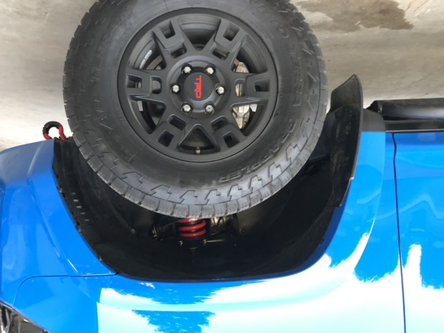

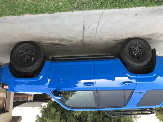

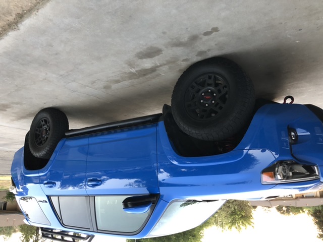

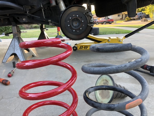

As promised the springs are installed, not going into detail on “how to”....plenty of videos on how to replace them. Tried my best to dial in the measurements but it was 100 degrees and I was trying my best to get it done quickly and efficiently as possible. So here are the measurements and pictures. I apologize for the upside down and sideways pictures, not sure why it’s doing that?

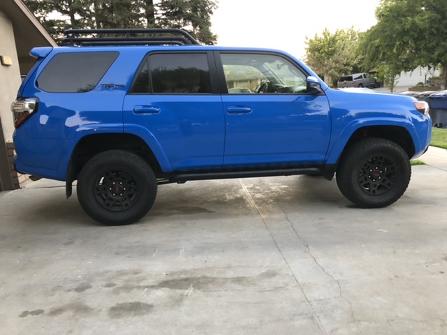

Will measure again when I put more miles on it and see where the final numbers are. Overall the front seems to be about a 2” lift and the rear is set at 1”.

On my iPhone I have to go in and edit my photos. I have to use the flip feature and flip them 360*. Then go repost them which seems to fix the glitch on Tapatalk.
Can someone please help me flip the pictures...I’m away from my computer and posting from my phone at the moment. That might be why it’s flipped.
Thank you.
If your using iPhone mine use to do it to. Need to use the Tapatalk app that has this web site on it to post pics. That’s how I do it. Hope this helps.
Thank you.
Pictures flipped!

Looks awesome! Excited to hear about how it drives too. Got the 1in lift in the rear through Eibach also it sounds like?
EDIT: ah I see they sell them together! 1in rear and 1.6in front.

Looking good. I’m definitely leaning that way for my AG Pro. I hope I can fit 285’s on my SCS wheels and clear the front.

Looks good. The most accurate way to measure is fender to the bottom of your rim. Then measure diameter of the rim and divide by 2. Subtract 1/2 of that diameter and that will put you smack dab center Everytime without an error for eyeballing it

If his center hub measurements are accurate that's exactly the height I have on my orp. Pros already get the liner tuck at port so your set up front. I had minor rub on mudflap but a heat gun molded it out of place and zero rub now.
My rims are 17x8 4.5 backspace and zero offset

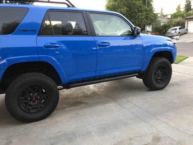

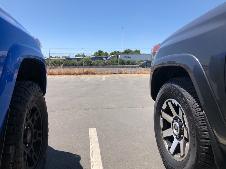

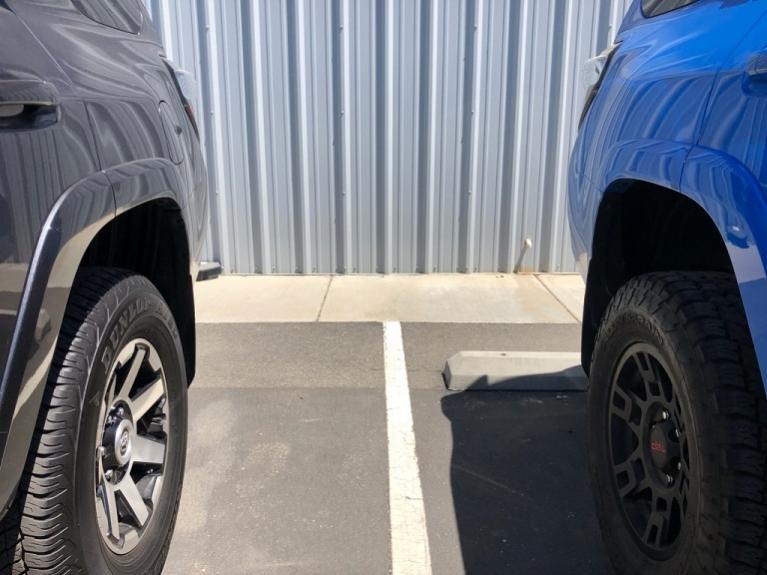

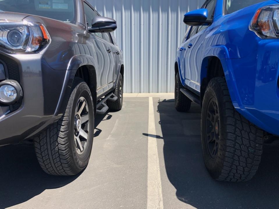

I was also able to get side by side shot with my Nephew's stock 19 ORP. Hopefully it will give you guys a better reference on the lift.

I apologize...thank you Sunshine! :kiss: Will update on the ride quality next week after it settles a little bit more. As of now it does seem to ride stiffer but with a little bit more noticeable noise dive, may be due to the center of gravity now that it sits higher.

It is interesting that you are experiencing a more noticeable nose dive. I'm wondering if this is because it lifts the shock into a different place on the internal bypass, because it's still 600 lb spring and not a bit stiffer, or both?
I also wonder how much it will settle after driving it for a while.
Currently, I can't do anything financially due to a cut in work (thanks, COVID), but am really interested in putting the 13" Icon 650# in the front for just a 1" lift and the matching Eibach 1" in the rear.
Anyway, thanks for sharing so far, it looks great!
By the pics Prolee,
It’s definitely a noticeable difference.

It was straight forward....no issues. I did it without a spring compressor. Took the old springs out and put the new one in with a helper to guide the shock back in.
