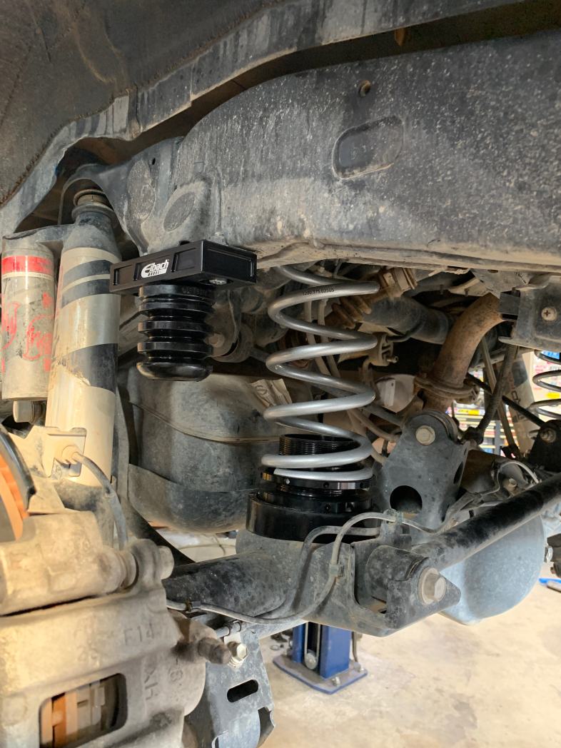

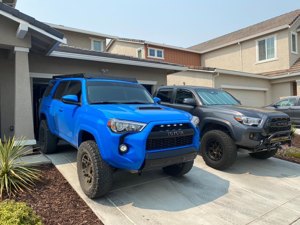

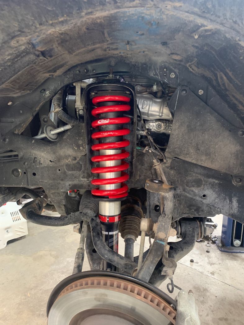

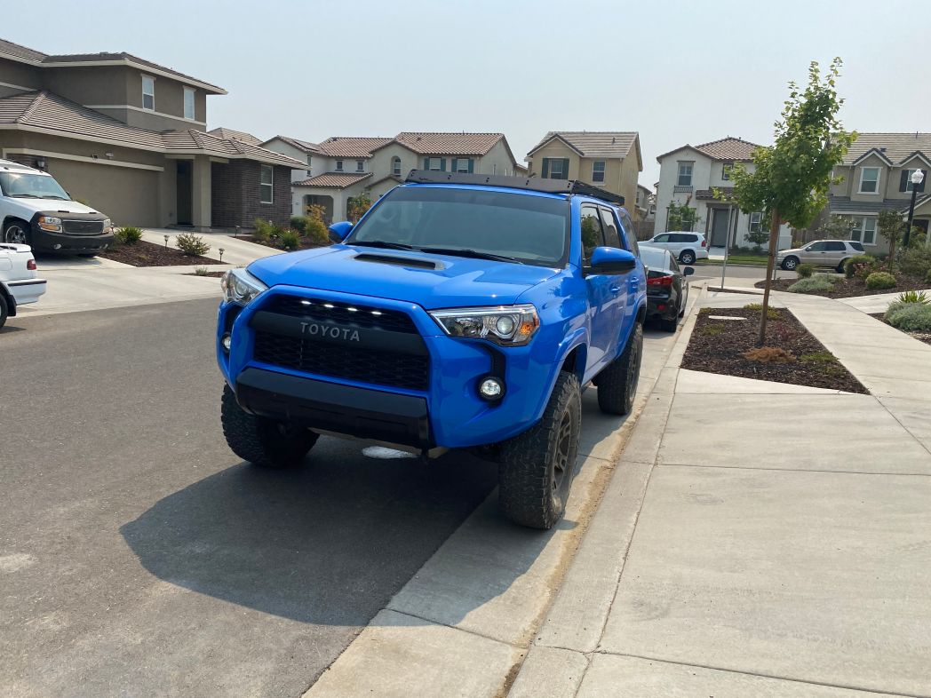

I installed the new springs for the front along with a 1/4 tophat spacer from toytec yesterday. Also put on the 0-200 # load leveling system. New JBA ucas as well. I didn’t do any measurements beforehand. After I put everything in I’m at 38 1/2” from ground to fender. The load leveling is approximately half way up.
The nosedive isn’t as bad and it doesn’t lean or roll as much around curves. Overall I’m pretty happy with it.

Looks awesome. 285's??

Does it still fit in the garage? If you don't mind checking, what's the new height, including the stock rack?
275s and it doesn’t go in the garage. Where you see it is where I park. I’d assume it wouldn’t though.

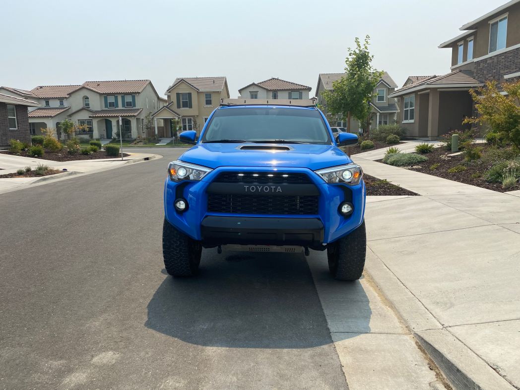

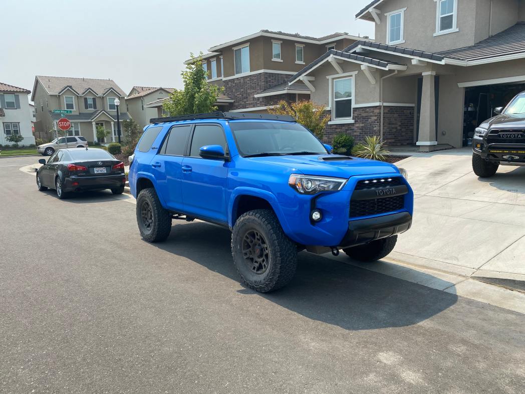

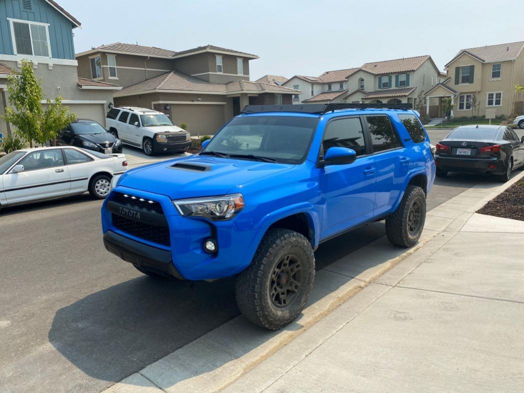

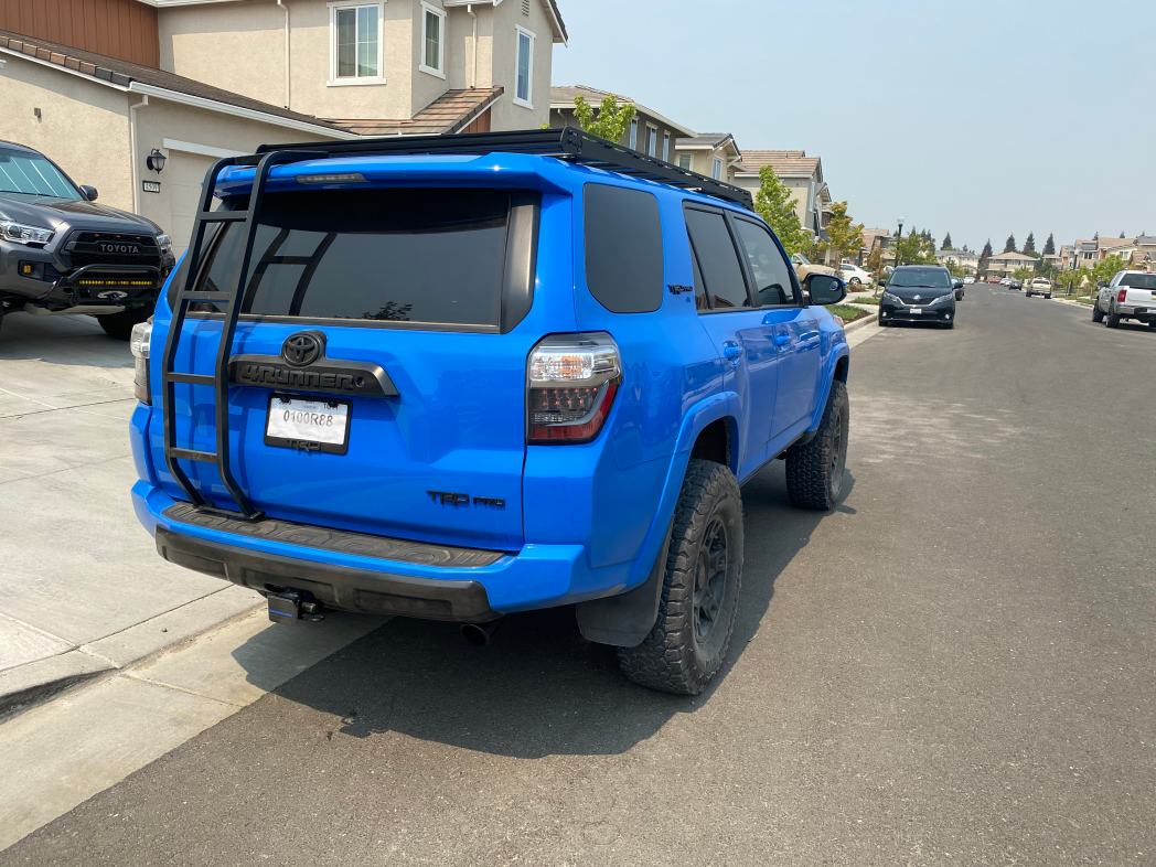

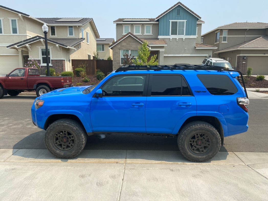

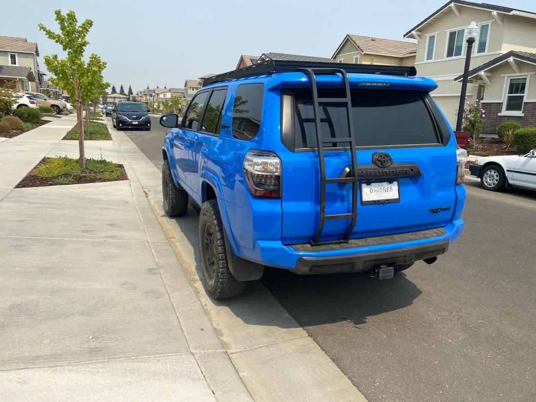

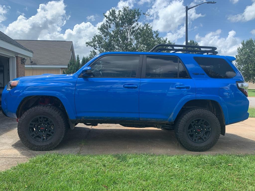

Lift Complete!
For those who care, see the pics below. :biggrin1:

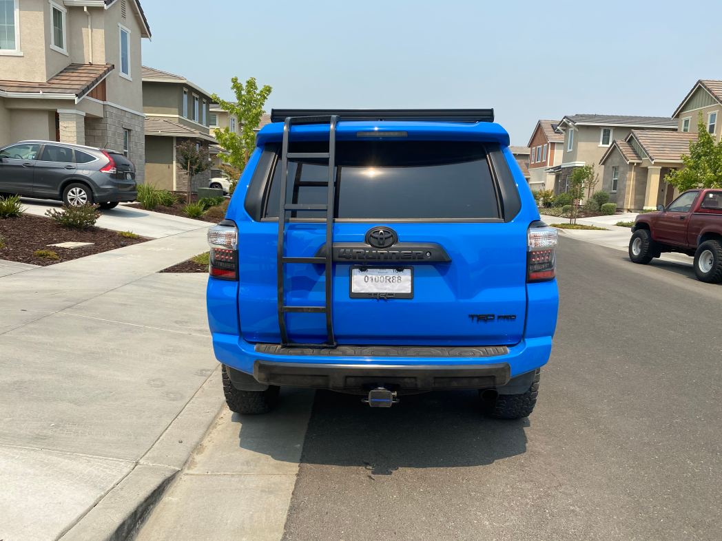

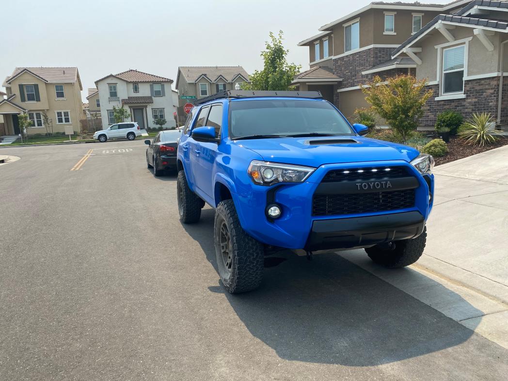

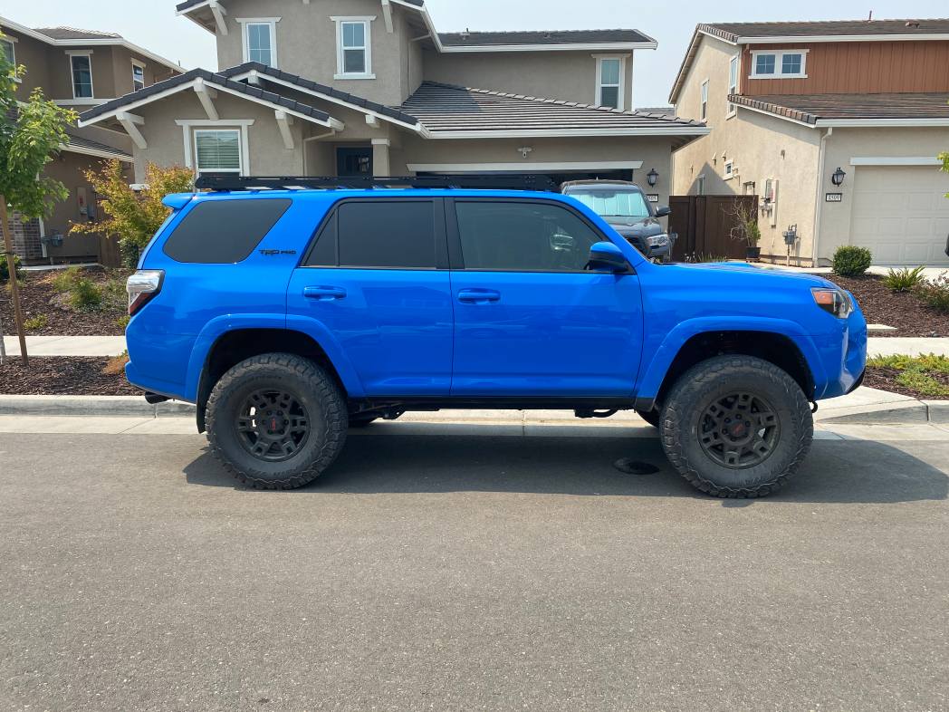

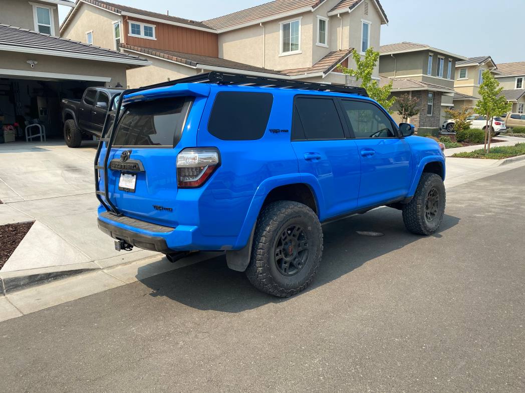

Im sitting at pretty much 39 1/4" front ground to wheel well on all sides but the Eibach rear spring perches aren't fully extended. I am going to adjust them to be 1/2" higher in the back to bring back a little rake.
Rid-ability is great, alignment is great, no regear needed. I noticed minor rubbing when backing up into my driveway, may do a little more trimming or eventually a super small viper cut. Already have a BMC and pinch weld.
Eibach Pro Front Springs - PRO-LIFT-KIT Springs (Front Springs Only)
Eibach Rear Load Leveling Springs - LOAD-LEVELING SYSTEM (Rear) (For +250lbs of Added Weight)
4x 1/4" Coachbuilder Strut/ Coilover Shims - Coachbuilder Strut / Coilover Shim (Provides 1/2” of lift per shim) Tacoma/4R – Shop Coachbuilder

Great pics and review, looks really good.
Couple things. I was told by eibach that we do not need aftermarket UCA's or a diff drop. Curious why you chose to do those mods.

I added 2x 1/4” coilover shims to each side which increased the lift by another 1”.
