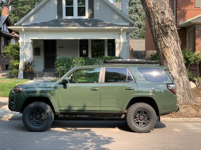

Eibach spring lift installed w/275 wildpeaks

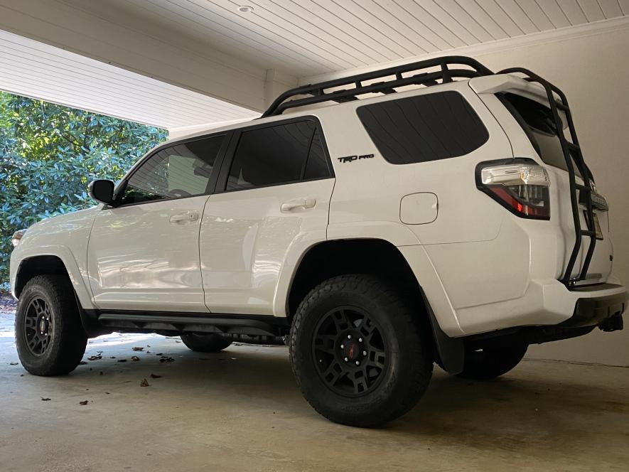

Just had mine installed, added 1.6" in front and 1" in rear as advertised. Stock UCA, alignment seems perfect even with wheel spacers. Couldn't be happier, but now i need bigger tires.

So far it seems everyone doing the Eibach springs have not needed to change there UCA’s. Wonder how much caster some guys are getting.
Looks awesome. I really wish white was available when I needed my Pro. What size tire are you going with??
