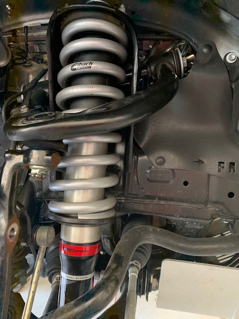

Production will be red....

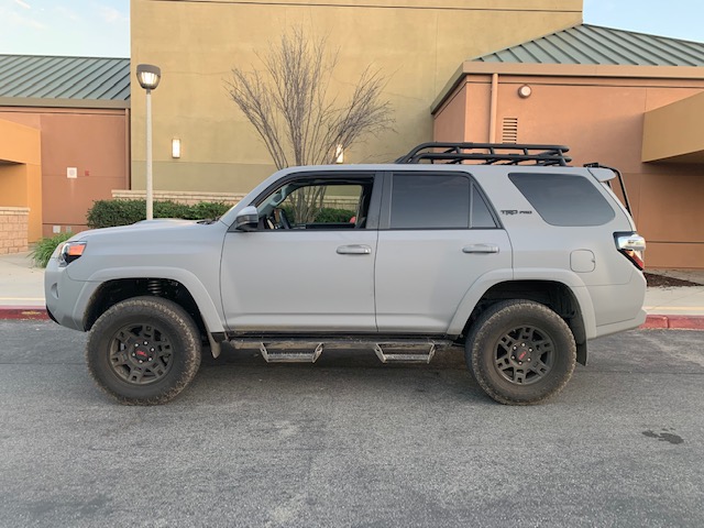

And here our first TRD Pro lifted with factory fox shocks! I'm pretty stoked on this kit. It really brings the PRO to life.
This is about 1.6" of lift in the front and 1" in rear. You'll be able to buy this as a four spring kit or just the fronts if you wish. Pricing TBD.

One more slightly loaded question... you said the picture above already has the 1" rear spring installed, so is there actually any rake left? It looks REALLY GREAT, but the more I look at it, it looks pretty damn level to me with little to no rake left.
In an earlier post you said it would still have rake with the 1" rear spring. So if it does, how much rake does it still have?
I only ask because I do load stuff in the rear / haul a trailer a 1-2 times a month and I don't really want the dreaded rear sag.
Wondering if the Wheeler's T13 (also Eibach) would be better suited for 1.5" in the rear to keep rake. However, then it goes up to 650# spring rate instead of 600# stock spring rate. Not sure how that would be with the new 1.6" lift w/stock 600# in the front and 650# in the rear?
You know, sometimes it's hard to tell just from a picture and not seeing it in person.
Thank you so much for R&D, help and advice.
Look forward to purchasing!

The front spring rate is 600lbs, not the rear. Rear is around the 200lb mark. Wheelers I believe is 195lb. (Feel free to correct me to the actual number)
You are mixing up two different products.

It still has 1/4" of rake.
