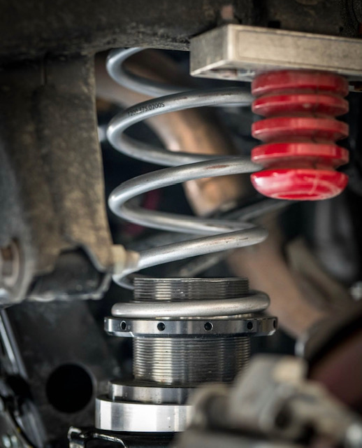

While we are it here's another Eibach product for your PRO that osideplayer will hate
:nod:
Being able to adjust your ride height in the rear is ridiculous, right? This will certainly ruin a PRO...
