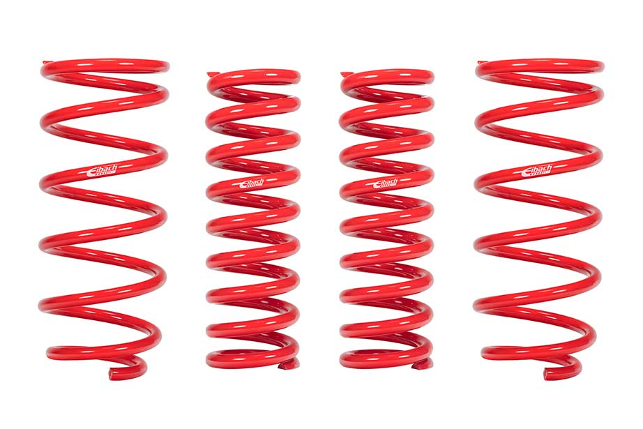

The front spring rate is 600lbs, not the rear. Rear is around the 200lb mark. Wheelers I believe is 195lb. (Feel free to correct me to the actual number)

Thanks [MENTION=400530]MGordo[/MENTION], you're right it's 12% stiffer than stock at 195#... it's what I get for overthinking and multitasking. :rolleyes:

First off, I am very happy to see this thread and have been looking for a way to squeeze another inch or so of lift out of my 2019 Pro without resorting to using spacers (or replacing the fox suspension for something else).
Is this 1.8 inch Taller than a stock TRD pro, so essentially 2.8 inches taller than stock SR5?
I understand exactly what you mean, and had the exact same question, though it doesn't seem to actually be answered yet. 2018 and earlier Pros supposedly had the stock ride height, but 2019/20 w/ the Fox setup is supposedly already 1" higher than standard ride height. If we have the same control arms and ball joint setups as all other 4runners, then there is already 1" of lift into our geometry, and adding another 1.8" on top of that would put us at 2.8" worth of lift into the control arm geometry. Since the general thought here seems to be that anything over 2.5" requires UCAs to get to proper alignment, this question is very important.
Thanks Ryan. To clarify (and I think what the other poster’s question is), these springs will lift a Pro 1.8 additional inches, bringing the total lift to ~2.8” compared to a stock SR5. Correct?

I know exactly what he’s asking and I’m trying not to answer it and confuse everybody. There’s just no reason to compare it to non-PRO. You’re already getting worried about arms because of it even though I said upper arms are not needed ;)
Everything you are concerned about is checked during our R&D process. If you need arms, diff drop, etc etc it will absolutely be mentioned waaaaay in advance. For 1.8” of lift it’s not necessary.
