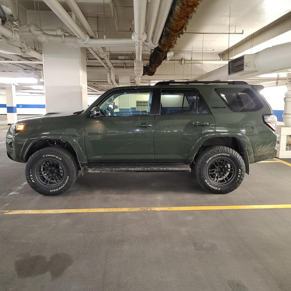

Below is my '20 Pro, Icon 13" coils up front and Eibach 1" coils in the rear. Pretty damn even, but willing to get exact measurements if someone wants.
Worth noting... I had cornfed 2" spacers previously, and the Icons gave me 1" less lift.
I was also planning on waiting for the Eibach front springs, but a set of the Icons came up for sale locally so i jumped on those instead. (and since they were used, I only paid $80) Ride is much closer to stock (softer over bumps etc) so I am quite happy.

You put those icon springs on the stock fox shocks I assume? Interesting. You said it's even with a 1 inch lift at the back along with these springs. I'd just want front springs for 1 inch there. You're probably closer to 1.5
