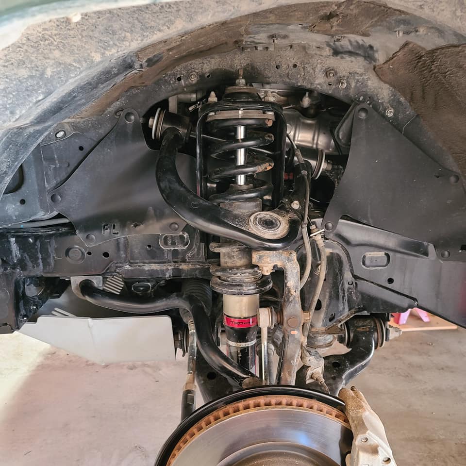

Below is my '20 Pro, Icon 13" coils up front and Eibach 1" coils in the rear. Pretty damn even, but willing to get exact measurements if someone wants.
Worth noting... I had cornfed 2" spacers previously, and the Icons gave me 1" less lift.
I was also planning on waiting for the Eibach front springs, but a set of the Icons came up for sale locally so i jumped on those instead. (and since they were used, I only paid $80) Ride is much closer to stock (softer over bumps etc) so I am quite happy.
You put those icon springs on the stock fox shocks I assume? Interesting. You said it's even with a 1 inch lift at the back along with these springs. I'd just want front springs for 1 inch there. You're probably closer to 1.5
This is correct. I have the Icon coils on the stock Fox shocks. I didnt measure the ride height stock but can defintely measure current.
I estimated 1" as the coils are 0.4" taller and 50lbs higher rating. (Using the 2 x added spring length for added height).
Initially I got the idea from someone on the GXOR facebook page, where a user did the coil swap. They apparently had a friend that worked at Fox and recommended that be the max height added to keep the shocks in the same rebound zone.
For the person commenting on the use of spacers on other 4Runners, the Fox shocks are completely different and have different ride zones based on shock extension. Apples to Oranges.
I dont want this to be taken as me bashing Eibach though, my plan was to go with their kit until I came across these locally.

Ride feels the same as stock which I like, defintely not as stiff as the ride with the cornfed spacers. (I had the Cornfed 2" front kit)
