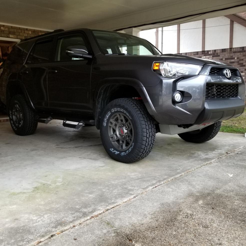

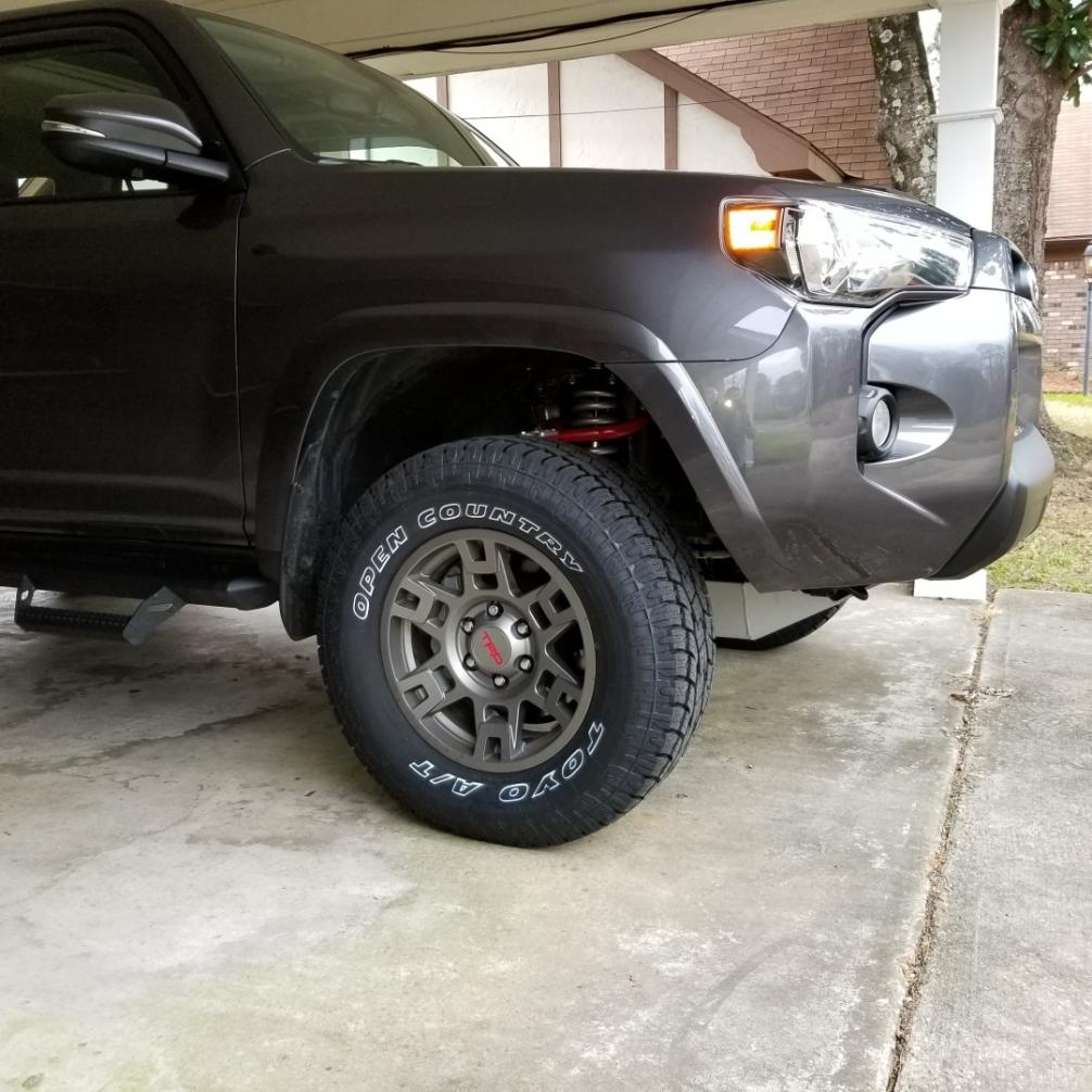

Of coarse it started raining, so pics are dark. Will put more up in the future.

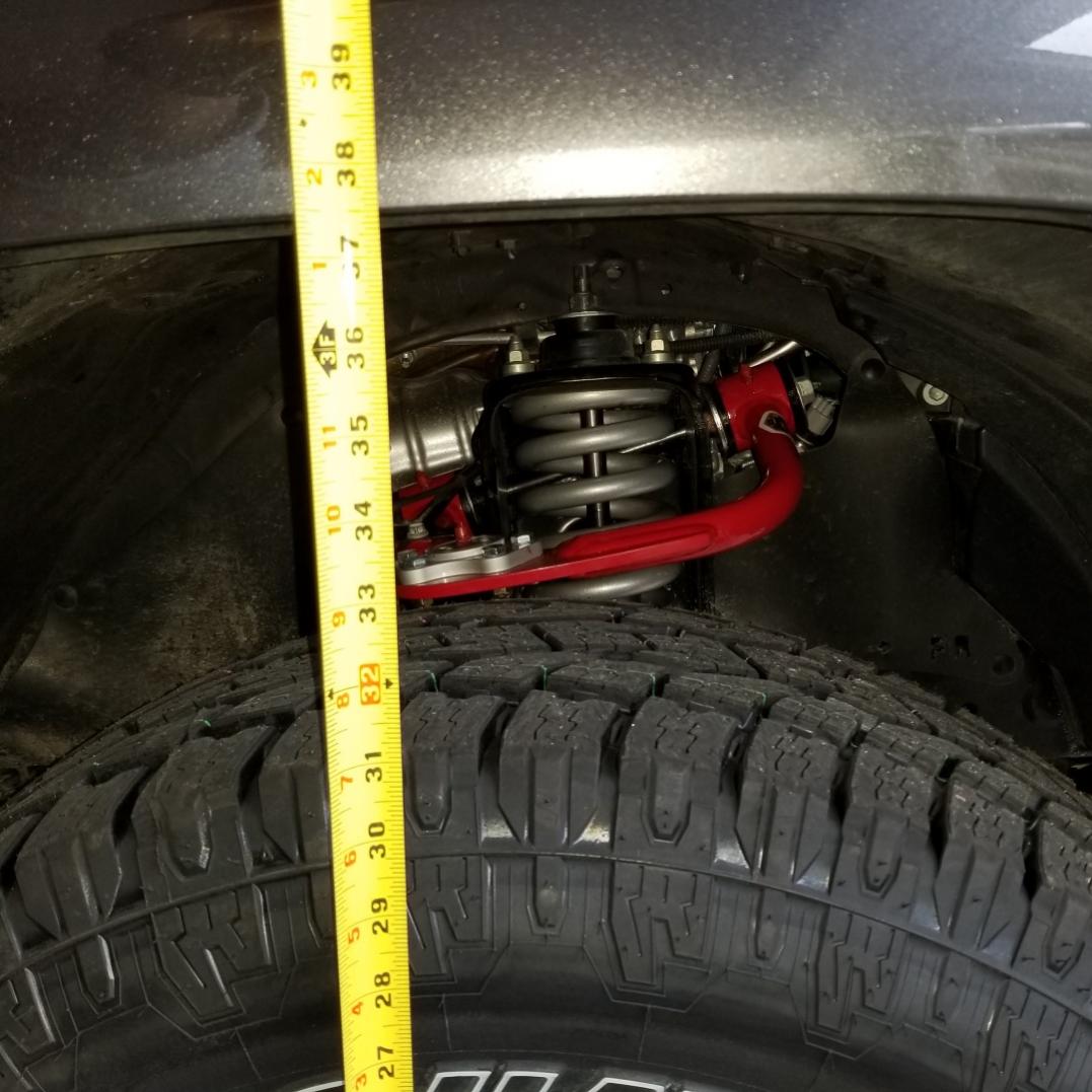

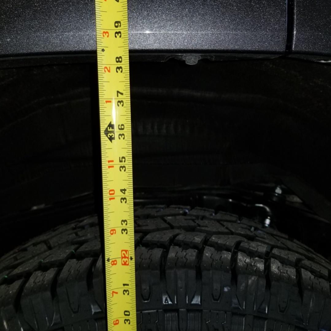

What are your center hub to fender lip measurements?
23.5 rear, 22.5 front. Still have a bit of lean on the rear driver side, will be adding a spacer in the near future. One observation i noticed today is the little rattles from the dashboard are gone. It's a 2018 with under 7k, and there was always a small rattle from the dashboard along with my cell that would rattle where I keep it in the 4x4 shifter boot. All are gone.... For now.
