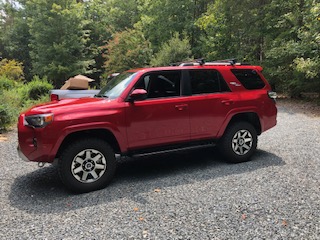

I have the eibach shocks with factory springs on the front. I would have bought new springs if they had shorter ones available. I’ve had no problems or regrets with using the factory springs. All the benefits of the kit but the height I wanted. I also got the 4th gen rear springs, they have me around 3/4” instead 1” plus.

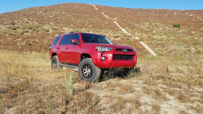

So I got the lift installed @ Eibach.. great staff and Wanda at the counter made the 4 hours go by so fast.
I've got the 3rd row, so the fronts were set at the first notch. I was able to fit the SCS SR8's with 285/70 Falken Wildpeaks with only slight trimming of the bumper. It sometimes rubs the mudflaps on reverse at full turn.

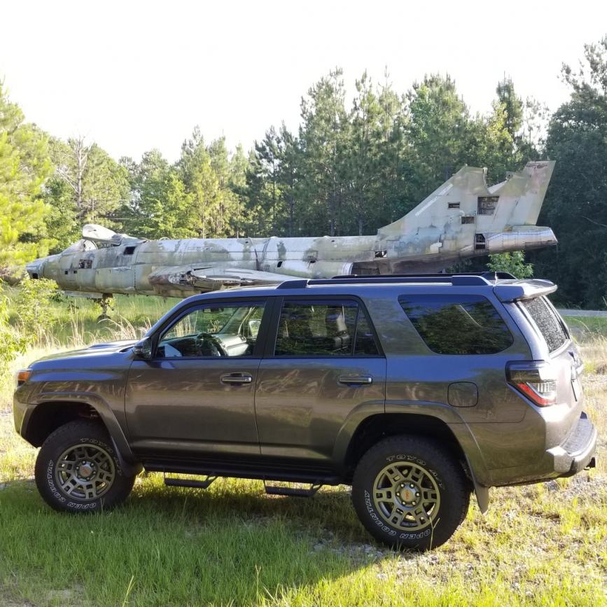

I installed the lift a few moths back, one of the only pics i have to date. 265 Toyo's with JBA control arms. Couldn't be happier with my choice.
