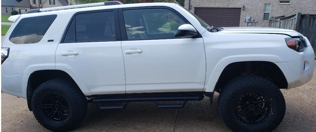

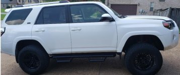

Got my kit from Toytec today and couldn't wait to install it. Getting it aligned tomorrow, but could already tell just from the drive home from my shop how much better it is than the XREAS.
Before, during, and after:

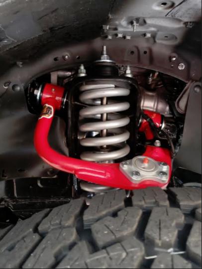

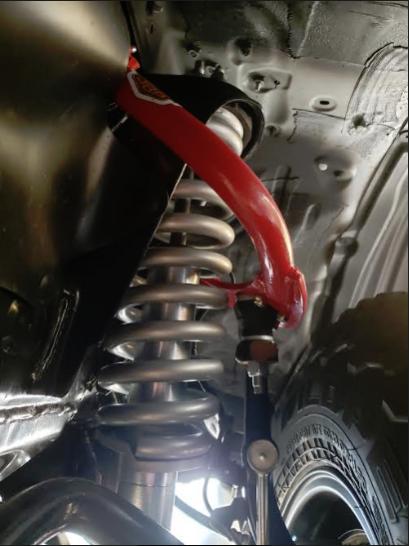

Had a local shop do the install on a stage 1 kit I ordered from Toytec. Didn't notice the huge rake in the front due to the wife driving and they had it backed in at an angle. Did they just not get the front springs compressed enough? The lift was for 2.75 inches and my before and after measurements for the front are in the 4 inch area. Is this going to be safe to drive it back up to the shop ?

Spring seats upside down?
I don't think so, everything looks visually comparable to other pictures I've found. Here is a close up.

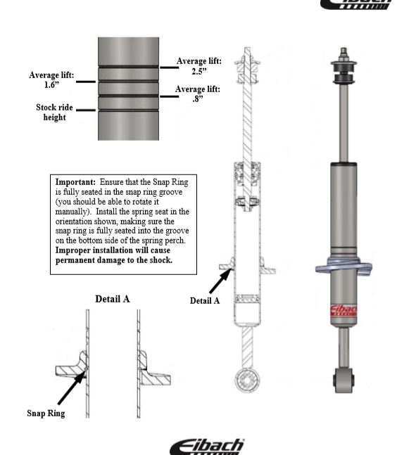

The snap ring is set in the wrong groove. You can see the lowest groove exposed in your 2nd pic and the snap ring needs to be on the lowest groove for the 2.75” lift setting.

They did it for $475 OTD (out the door) which included wheel alignment. Talking to the owner of the shop, he set the front shocks to the standard 2.5" setting which is mentioned in the installation documents here:
PRO-TRUCK LIFT SYSTEM (Stage 1)
I installed the bumper and winch myself and debated installing the lift. For $475 might as well let an expert handle it.
