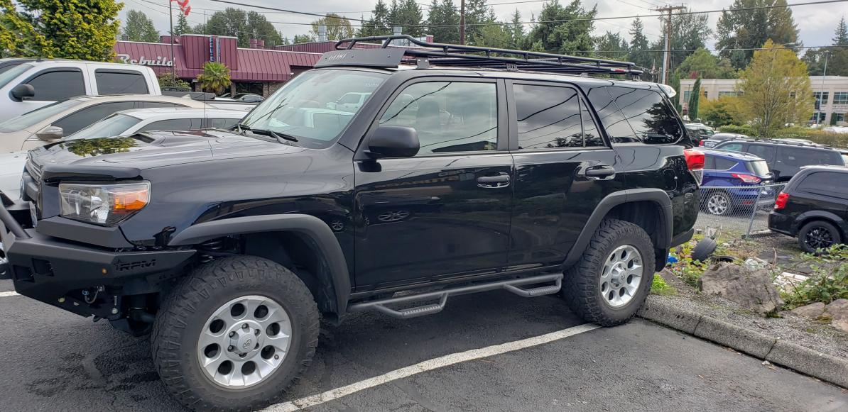

I got this Eibach set up put in. I put it on the lowest setting but am thinking about moving it up one notch. Has anyone done that here?
I’m currently running 17” Icon Rebound bronze wheels with 285/70 Falken AT3W. I’m really impressed with the look and feel of this tire... driving on the highway is great and the suspension is so much nicer.
I really like the look! So is the eibach kit the only suspension upgrade you did to fit the 285's with those wheels?

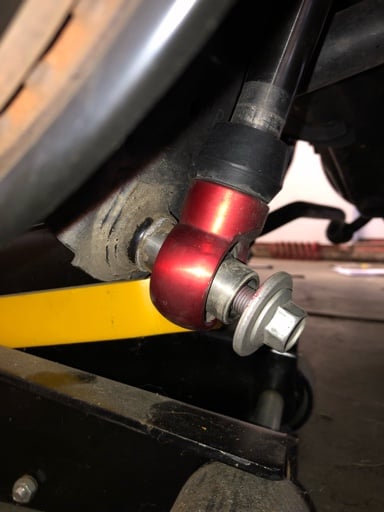

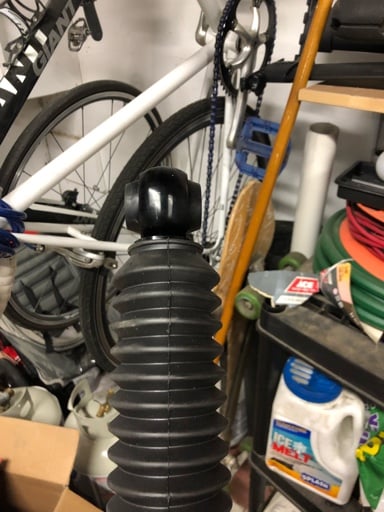

Can someone upload an image of the rear shock?
The ones I have don’t come anywhere close to fitting.
This is what the eibachs look like.
This image is my current toytec boss performance right before I tightened it up when I put them back on.
On the eibachs the bolt isn't long enough to start threads and the tube the shock slides on to doesn’t come all the way through.
Is this the wrong shock from einach or am I missing hardware?
Edit: After looking at the shocks online I'm pretty sure I have the wrong shocks - or at least wrong bushings in them. [MENTION=318203]Ryan at Eibach[/MENTION] can you give this a look?
I just purchased the Eibach kit. I want to install it, but I just can’t make up my mind about the tire size. I keep going back and forth between 275 and 285/70s. I noticed that you went with the 285s. Have you experienced any rubbing or had to do any trimming?
I've had this kit installed for 6k miles and finally took it for some intermediate wheeling a few weeks ago. I had the Runner on 3 wheels a few times and the suspension handled it perfectly with zero rubbing on the fender or body with my Falken 285's.
Note: My front fender liners are pushed forward (shop did it before install) and my wheels have 4.75" of backspacing. A lot of folks on here who are running 285's haven't complained of any major issues and I have no regrets going with 285s.
Excellent. You’ve helped me make up my mind. Thanks, Matt.
It looks like I have the right part.
For those that have done the install yourself. How hard did you have to whack the lower eyelet to get it all the way in and get the bolt to thread?
I swear I had it all the way to the flange but I must. It have.

My issue with the rear shock turned out to be that the rear spacer on each of the suspension mounts was just frozen on and I didn't notice it.
