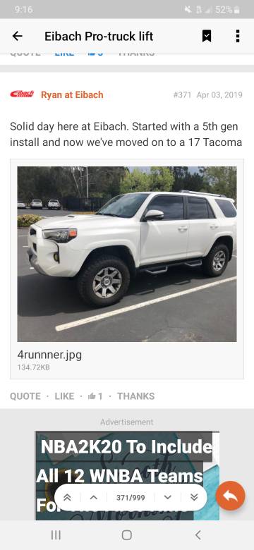

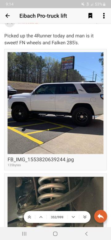

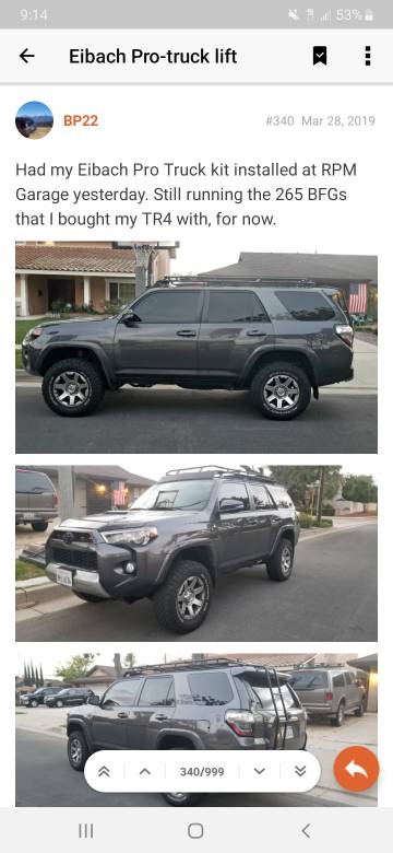

Mine should arrive Tuesday. I've also placed an order with Wheelers for the T12 rear springs as I'm just not feeling slight squat I'm seeing in the rear of many 5th gens with the Eibach springs.
Sent from my SM-A205U using Tapatalk
Not sure what your seeing, mine is 1" higher in the back. so slight rake.
Here are a few I found in the thread. I do plan to make sure I get all available lift out of the front, so I want to make sure the back is in step.
Please note I'm not blasting anyone's trucks here, just looking for a little more lift in the rear than these seem to have.
