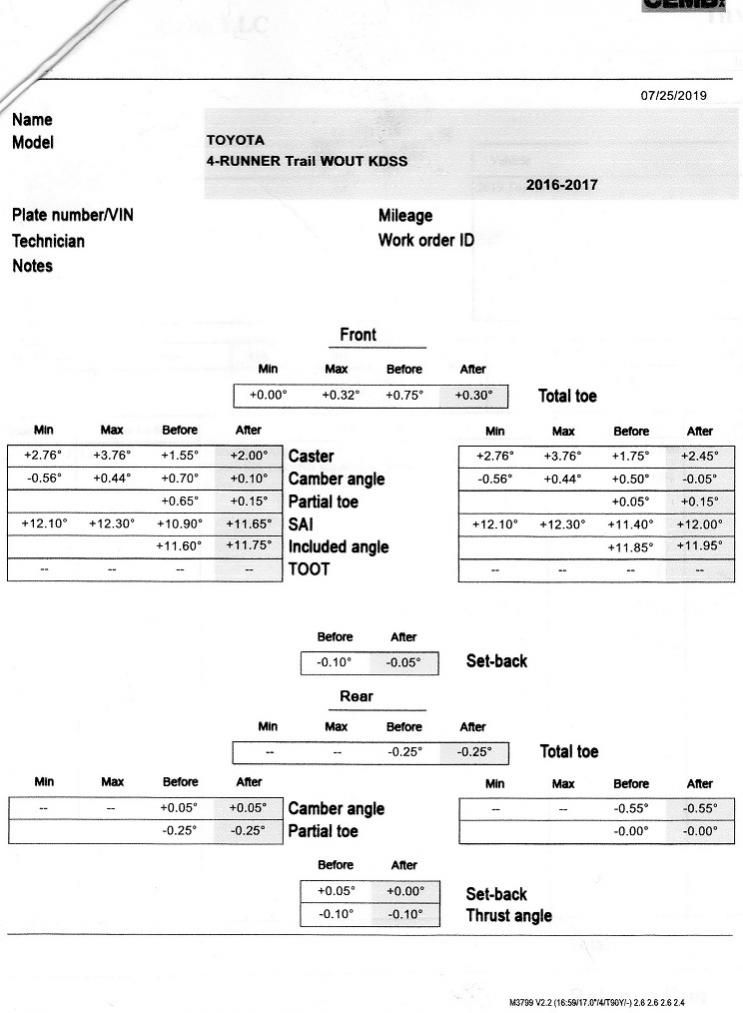

When you get it done with the installation do 1st alignment. Get Toe, Camber in specs, caster will be @ high # 5+. Don’t worry, you drive at least 500-700 miles, let the shocks, springs settle. Then you can get your caster in specs. Good luck
