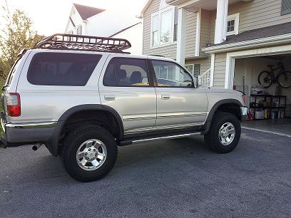

I have the Tacoma 5100s and L.C 8 wraps and it is not level. I got almost 5" out of the LC, may or may not settle over time either way I'm ok with it. If I remember correctly when I got my Eibachs I read somewhere on Toytec's site that stock shocks were not long enough. You probably don't have to do Bilsteins but probably could do some other longer shock. Pic of mine is below. I also have the 5125s in the rear.
