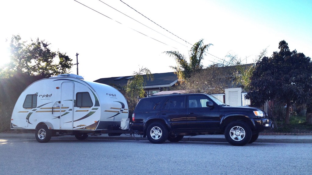

Thanks for the details. I'm digging into a Prodigy P3 install tomorrow, along with an airlift air bag slip in. I've already swapped out the front brakes for Tundra caliper/discs/pads. We've got a 2000 5 speed manual SR5, so no need for a tranny cooler. We'll be towing an R-Pod in Utah. Installation scheduled for tomorrow. Do or die.
Years later, our 2000 5 speed is still towing that rpod. Prodigy P3, a good weight distribution hitch, Tundra brake upgrade and air bags ftw.
