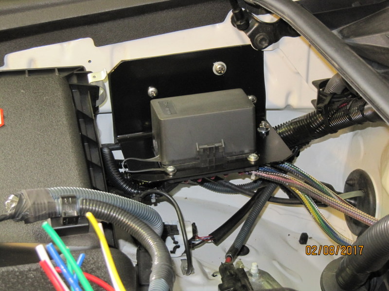

This is what I did . But I have a dual battery system. the only difference is that your battery is farther from the panel thus increasing the need for larger gage wire.
May I suggest you start with a Bussman 15303-2-2-4 relay panel. Feed this with a #6 awg or larger Marine rated cable to allow for volatge drop about fifteen feet (Measure it first). Fused at the battery with a Blue sea MRBF Terminal fused at 80 amps.( You can order all this online from Defender Marine in CT).
You can get some 16 gage sheet metal for mounting the bussman panel. Bend the sheet metal to 90 degrees Tracy out the bussman panel then cut out the bottom of the sheet metal to allow the branch circuit wire to flows out the bottom of the panel (someone makes a mount for this panel that would work, I saw it but don't know where)
Use the existing threaded holes in the fender to mount it. You will need some tools to do this. A Drill motor ,Jig saw, Big Hammer to bend the sheet metal and a vice. Also don't forget the split tube and tye wraps.
You you will have 5 relay circuits and 5 non relay circuits to do what ever you need in the future. It may sound complicated but with all the correct parts you will have plenty of room to expand later.

This is awesome, thank you. Is that picture from your setup? Would the sheet metal need some sort of vertical support?

The Bussman panel is similar to what I used and It worked well. The wires that come with it are not long enough to really go anywhere so you will have to add on to them.The Bussman relay panel is only rated for 80 amps so size your fuse and wire accordingly.
The other blue sea fuse block and fuse are spendy but they attach to the battery connector so there is no drilling plus it makes for a cleaner installation.
The bracket I made is 16 gage sheet metal its strong enough to support the relay panel so no extra support is needed. Yes that is my photo. I don't have a build page but you can see what I have done by going into my album on page #2 you can see how I did this Mod.
