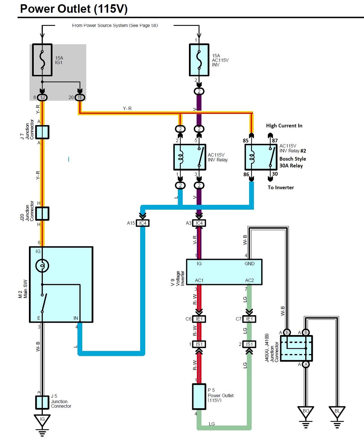

I've drawn up a simple diagram for adding the second inverter to the original system.
Original diagram:
View attachment 2003 4Runner Power Outlet 115 VAC.pdf
My diagram:
Be sure to get power off something that offers plenty of power, such as the tow brake provision, which offers 30amp fused power. Also use proper sized wire for your inverter. You may want to be careful with too many things running on constant power or you'll wind up with a dead battery when you least expect it!
You could easily use the same main instrument panel switch to control a second inverter (which is how I'd do it).
