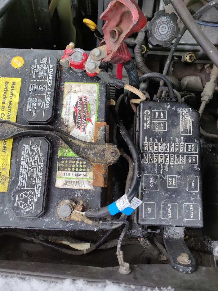

What are the signs of damage? Everything looks good to me. How do you replace the negative terminal? It seems that everything on the negative terminal goes down into the harness.
Here is a pic. Are there any tricks I can do like bypassing something? Honestly that red terminal is kind of a POS so I need to replace it anyways.
edit: I removed the winch and fiddled with the positive contact a bit and it works well now. I hope that was not the issue all along. I tested the voltage at the posts and then tested the voltages where the wires were and it was fluctuating pretty heavily. She is now ready for sale!
